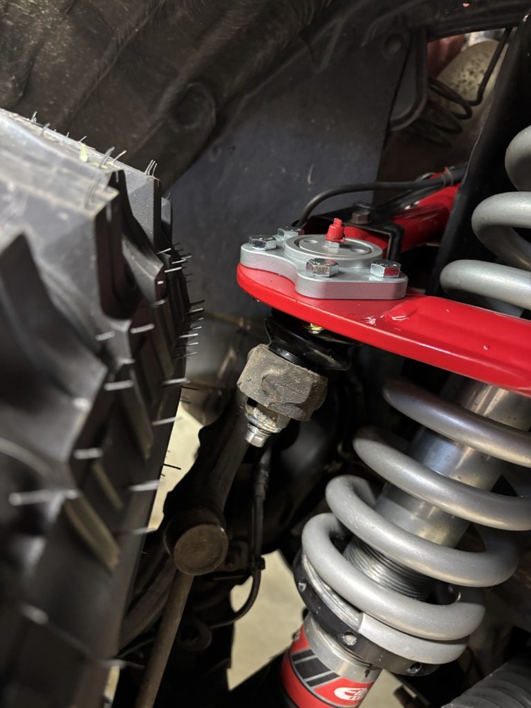

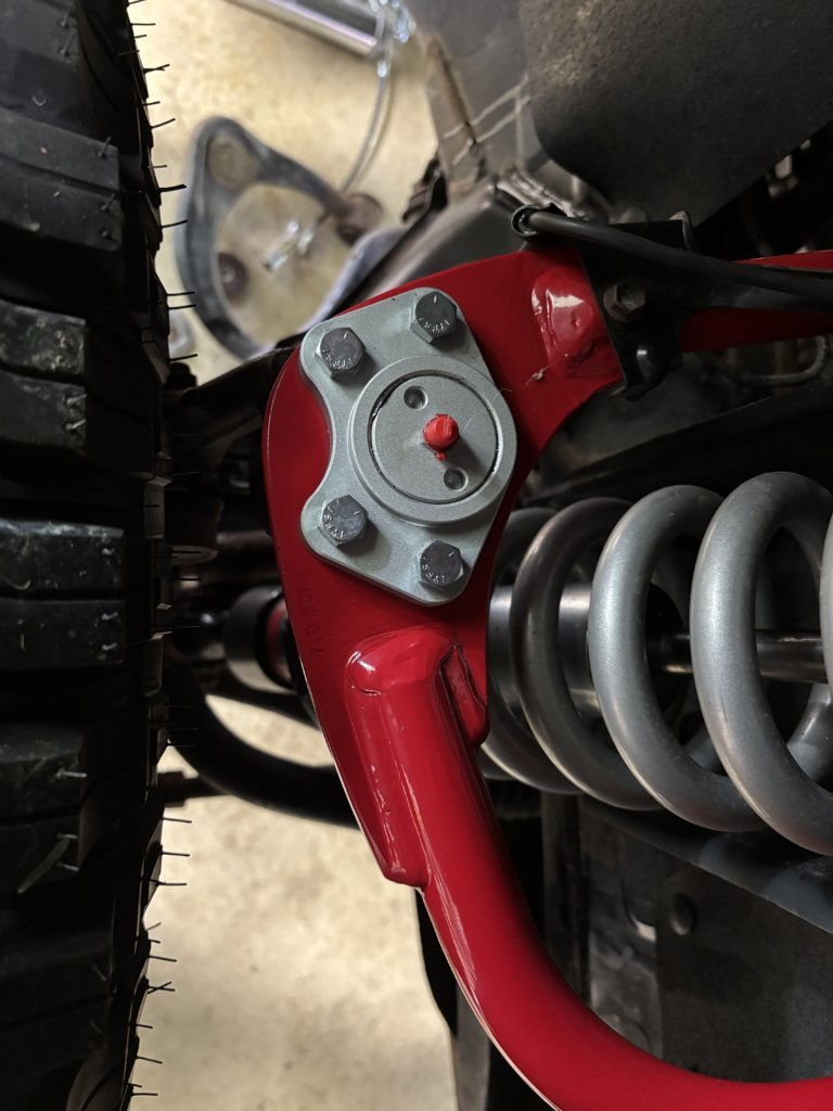

  6. Dec 22, 2024 at 1:35 PM
    #4086
    TaCoHiOgUy
    TaCoHiOgUy Well-Known Member
    Nov 27, 2019
    #311875
    52
    Eric
    2008 Regular Cab 4WD 5 Speed
    Eibach Pro Truck 2, 1.5" AAL, 255/85/16, JBA UCA
    I got the JBA’s on today and put the wheel/tire back on. It clears 255/85/16 at full droop in all directions. I don’t have it on the ground but the clearance shouldn’t change if I’m thinking correctly? Because the upper and lower BJ should keep the same angle? It’s also not aligned so that may factor in as well.

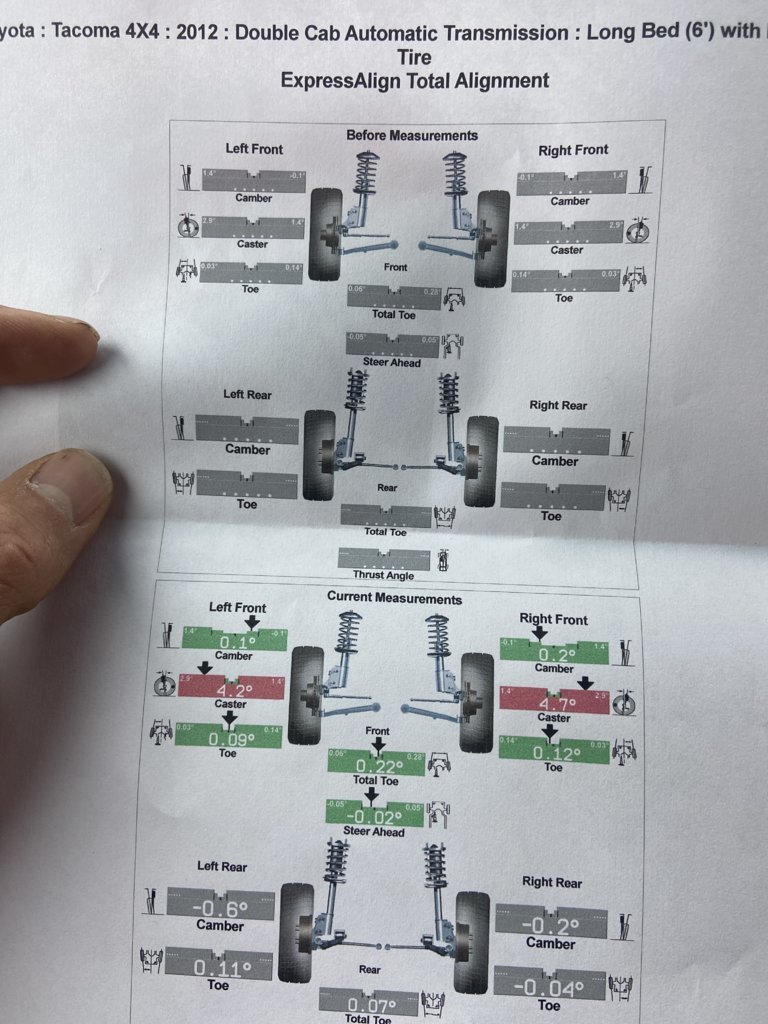

  10. Dec 27, 2024 at 10:35 AM
    #4090
    Coopsdaddy
    Coopsdaddy Well-Known Member
    Jul 7, 2017
    #223417
    475
    Quinton
    2012 dclb tacoma
    6112/5160 Deaver stage 1 Are topper Steelies,255/80/17
    Alignment from today
    TaCoHiOgUy likes this.
  11. Dec 27, 2024 at 3:35 PM
    #4091
    hwntaco20
    hwntaco20 Well-Known Member
    Jul 18, 2020
    #334868
    643
    2020 Tacoma TRD Offroad 2wd
    That's a lot of caster.
  12. Dec 27, 2024 at 3:59 PM
    #4092
    Coopsdaddy
    Jul 7, 2017
    #223417
    475
    Quinton
    2012 dclb tacoma
    2.2 front 2 rear lift
    255/80/17
    What they recommend and drives great so far at 80.
  13. Dec 27, 2024 at 4:09 PM
    #4093
    Taco-Grinder
    Aug 14, 2016
    #194574
    6,982
    Dan
    Fond du Lac, WI
    I'm running about the same castor. Drives great.
  14. Jan 4, 2025 at 10:21 AM
    #4094
    TaCoHiOgUy
    Nov 27, 2019
    #311875
    52
    Eric
    Got the alignment done and the 255/85/16 on stock wheels (5" BS) do barely rub the front of the control arm. You can see in the pictures in post #4086 where it is close at the front. With the toe properly adjusted it will rub.
    Funny, it's like JBA knew it would do that!

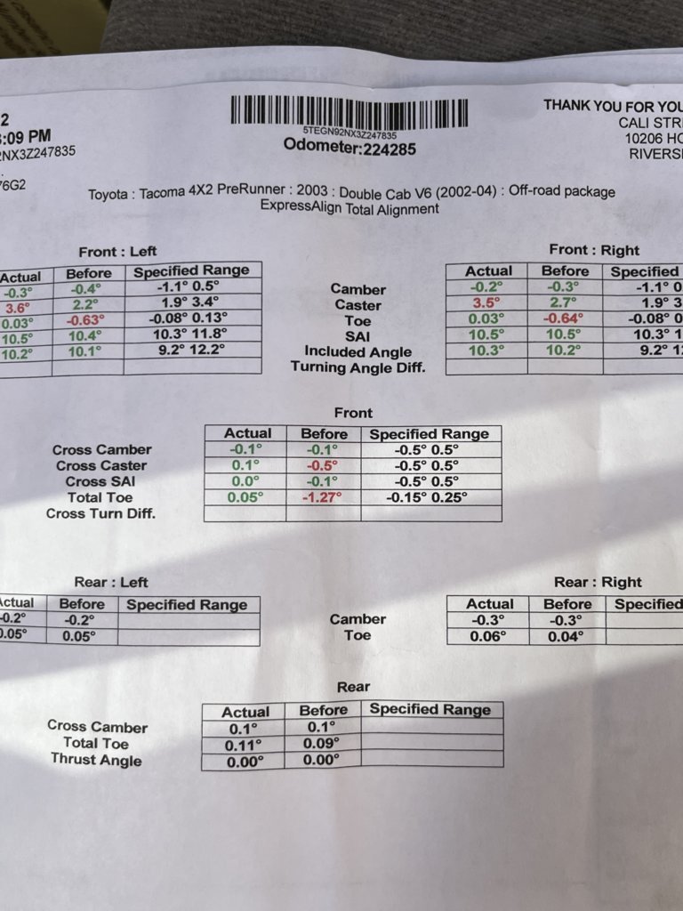

  18. Feb 6, 2025 at 2:27 PM
    #4098
    taco03Trd
    taco03Trd 03 rig trd v6
    Sep 29, 2016
    #198568
    1,159
    Carlos
    Riverside ca
    03 DC prerunner trd v6 2wd
    Ome 881 5100's jba's looking for more
    Got all new shocks out front 5100 with new LCA’S then alignment but my truck shakes at around 65 to 70 mph
    Here are the final specs from alignment any ideas on the the shake and also wonders to the right side not to similar with alignment numbers I saw on a video that more caster would be good on my listed truck ..
  19. Feb 6, 2025 at 3:53 PM
    #4099
    hwntaco20
    Jul 18, 2020
    #334868
    643
    Shakes at speed is usually a tire/rim issue. Might have lost weights on 1. Trying swapping front to back to see if goes away.
