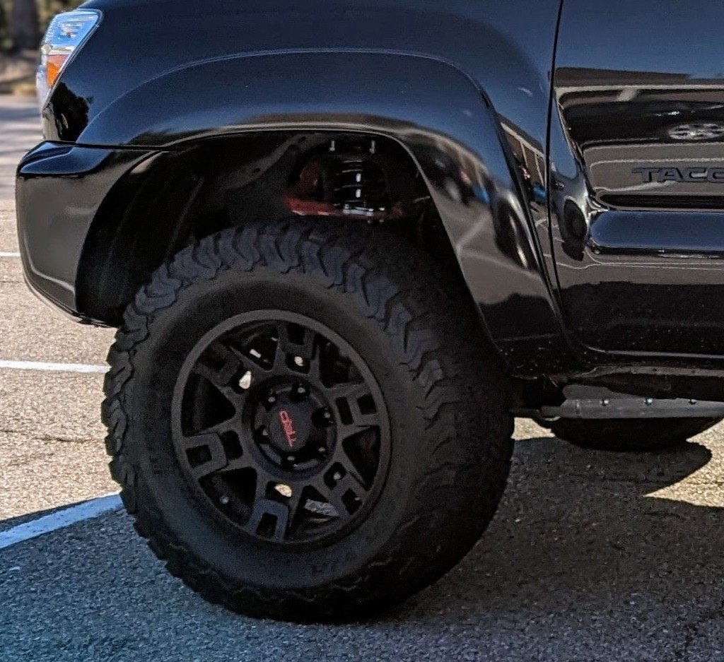

    Been running the HD UCAs for a while now and absolutely love them. My current wheel/tire setup is as shown which are 265/70r17s on 17x7 +4 SEMA wheels. I'd really like to bump up to 285s, or 275s in C-load, but don't want to use spacers if at all possible. I've been looking at a set of Method 703 with 0 offset and 8.5 wide because I don't want to push my wheels out too far and create a host of other clearance problems. For those of you who have JBA UCAs and running wheels/tires larger than 265, what are your setups like, and did you have issues with clearing the UCAs? Thanks.

    Similar situation here, running 285/70/17 on FXFN wheels 0 offset. I do have wheel spacers, in the process of getting rid of them, I was told to go -negative offset, -12 or so, should not have a rubbing problem, higher -offset will create rubbing, I do have a CMC, and did some hammering back when I put these tires in!

    Have you tried removed the spacers and remounting the wheels to see if they do in fact rub? I'd prefer to stay 0 offset but I might be forced to go -12 which is the other variation Method sells.

    I have Voxx G-FX TR16 wheels at 16x8.5 with a 0 offset, riding on 285/75r16 BFG KO2 tires on my 3rd gen. I also have the cab mount chop, and I have no rubbing at stock height, full turn and tuck. I love my setup!

    With the 0 offset, they hit the UCA's, reason I went with spacers, over the last year and a 1/2 I have replaced all
    4 wheel bearings, thinking the spacers might play a roll in that, or weight! Starting with the wheels tho :)

    I checked the charts on JBA's website and it looks like it might just rub a little. They call for 4.75 or less backspacing and the Method's are listed as 4.8 for the 0 offset.

    Tough call, I'm just playing it safe and going with the -12 , hopefully that works! Also looking into the Method's or SCS
