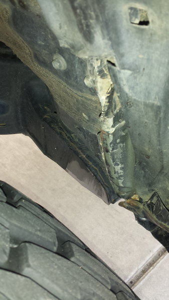

    Sucks to hear. Are your tires rubbing the UCA at all or just the cab mount? Got any pics of your cab mount rub?

    I'll try and snap some pics to post.

    Hey guys, so I totally suck. Didn't have a chance to snap pics of the spacing. I had my lower ball joints done inner and outer tie rods and got my alignment waaay better. Toe and camber perfect 0 and caster at exactly 2.4 both sides. Not rubbing anywhere near as bad as I was. I haven't painted the cab mount yet so I will get you all a pic of the rub marks tomorrow. Now I know when I get the new tires and smaller spacers I will be perfect. Much happier now. Too many factors

    Long awaited photo of the rub on my cab mount chop, you can see where the black paint has rubbed off.

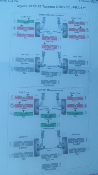

    Installed my JBA Std high caster arms yesterday and got truck aligned today. Naturally a couple of my adjusters are frozen. I was previously running 884's and only had 1.2deg of caster. Added JBA arms and a toytec top plate spacer and I'm way over now. I think I'll just run in like this for a while until I have time to cut control arms out and redo the adjusters. What do you guys think? It drives a lot better.

    I think the toe is actually good. Contrary to popular belief you don't actually want 0 toe for breaking purposes. A combined toe of like .17 is optimal or .085/side. They actually teach you that at the hunter alignment school. I see no issue with the caster either. Sure it is out of spec but if the truck were a prerunner the spec is 3.5-5 degrees so think about that a bit. 3.9 is definitely fine, there is more steering effort in corners on the freeway but it track beautiful. If anything I'd like to see 0 degrees of camber ut a tenth or two I'm not going to fuss about. Just my 2cents.
