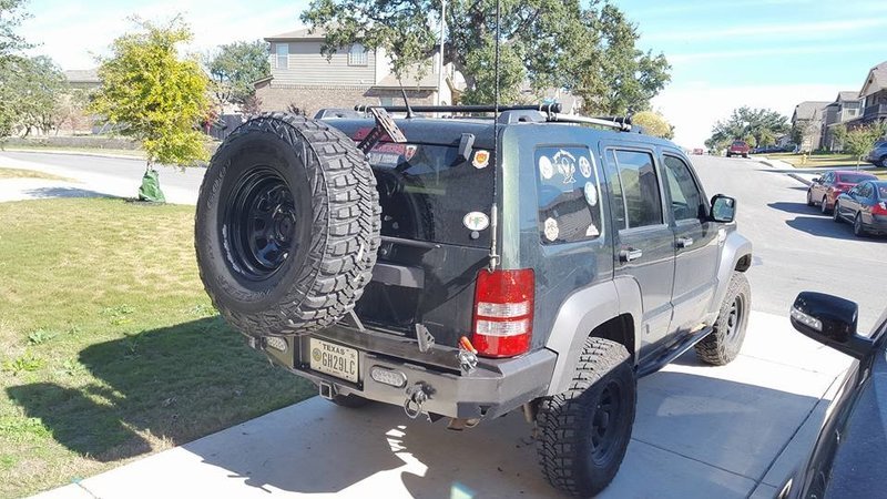

    You sure it wasn't a Liberty? This one to be exact?

    That pic was actually taken before it was dropped off up there...37 on the tire carrier and 32's on the ground. Thought the custom ifs and rear were still being built. I mostly wanted an excuse to shamelessly post pic of the rear bumper I built for it :anonymous:.

    that is a sweet bumper
