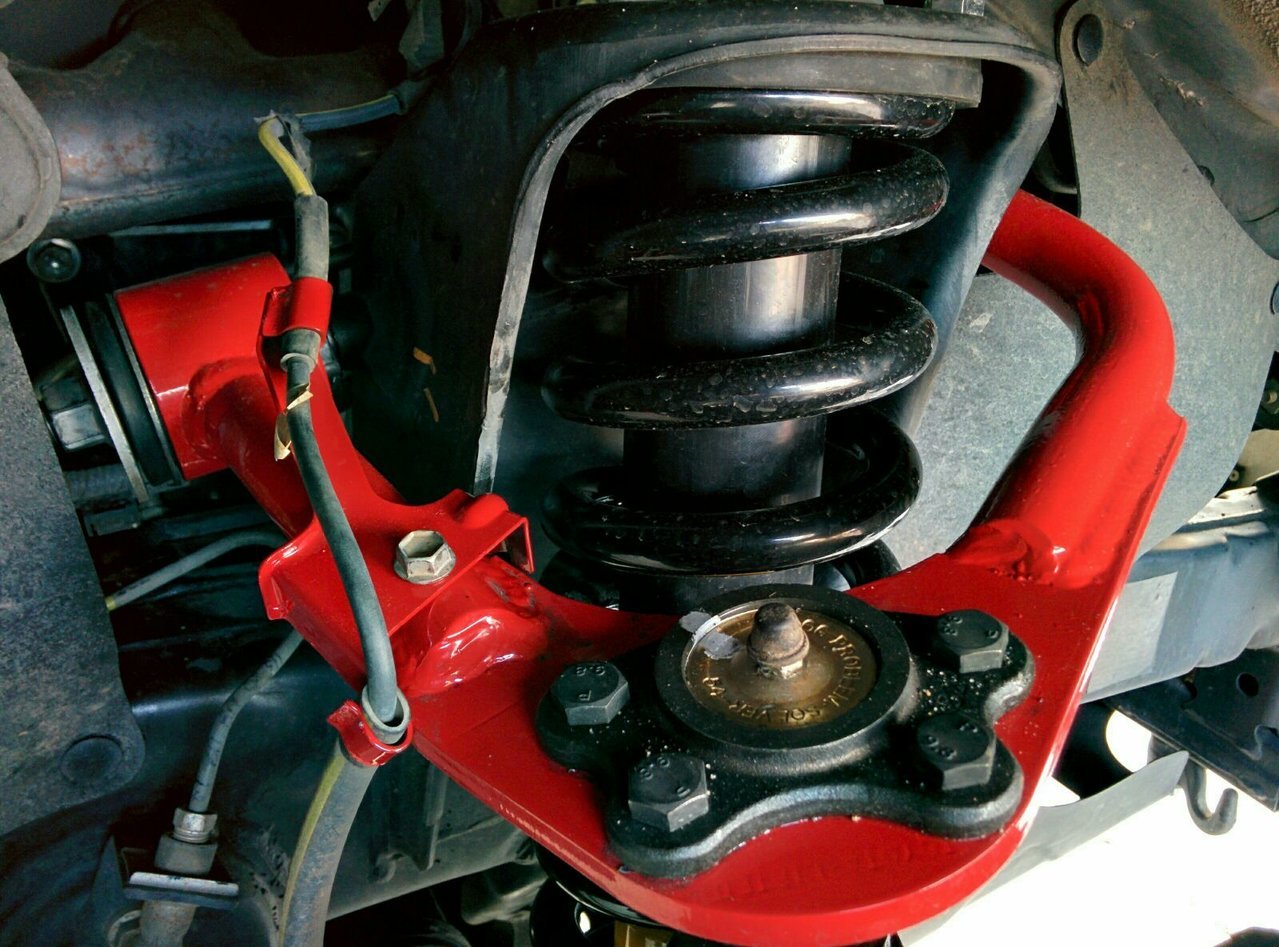

    Mine got installed a little over a week ago.
    I painted the wheel speed sensor wire bracket and discovered that a dust cap for the factory brake bleeder screw works perfect for the zerk grease fitting.
    Here is my alignment numbers.

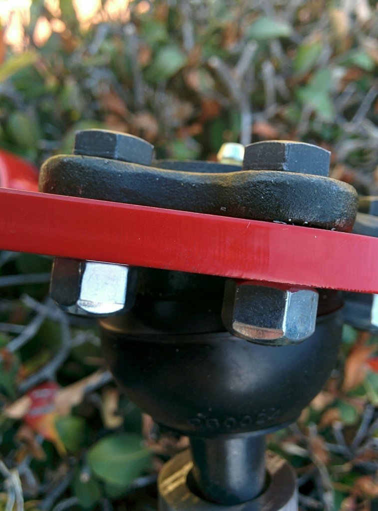

    Maybe it's the crew chief in me, but I think the bolts are about 2 threads too short.

    I agree with providing an extra two threads on the bolts.
    Also, would be ideal to get the torque on those bolts stamped somewhere on those UCAs for whenever we have to replace the ball joints.
    I think another idea would be posting a video/picture gallery on how easy it is to swap out the ball joints would get you more customers. :)
