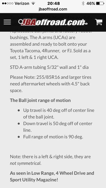

    I was just looking at them on his website and 255/85R16 and larger tires require aftermarket wheels. Bummer. ☹️

    I'm not looking at running either wheels or spacers though. I have 255/85R16's.

    I haven't done anything other than OME suspension w/886 springs and the tires (Cooper ST Maxx). No rubbing issues.
