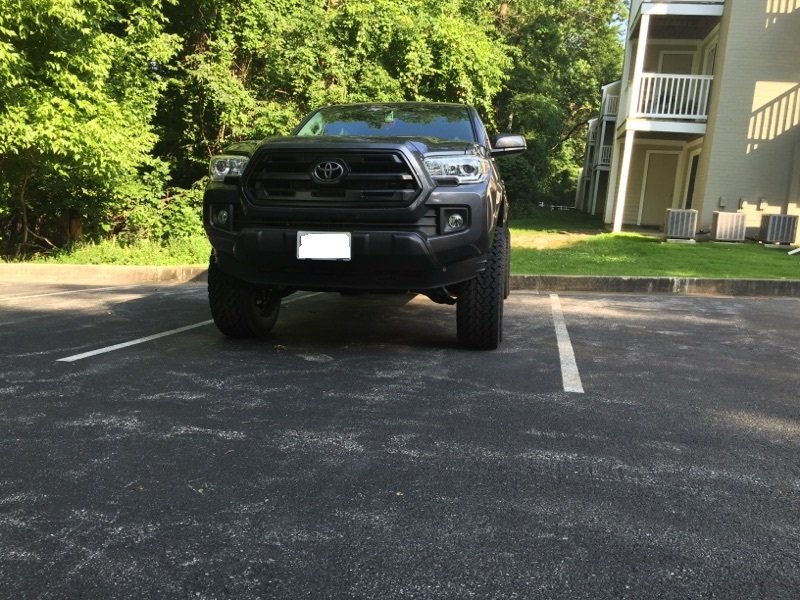

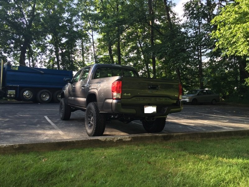

    So who's running these on a 2016? If I decide to use these arms, I want to make sure I won't have any issues. I'm lifted 3" with stock 16x7 SR wheels and a 1.25" spider trax spacer. 285-75-16 and I have absolutely zero rubbing right now.

    Don't know, never checked. I will get pictures tomorrow with the wheels turned full lock both directions.
