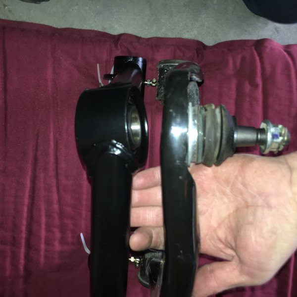

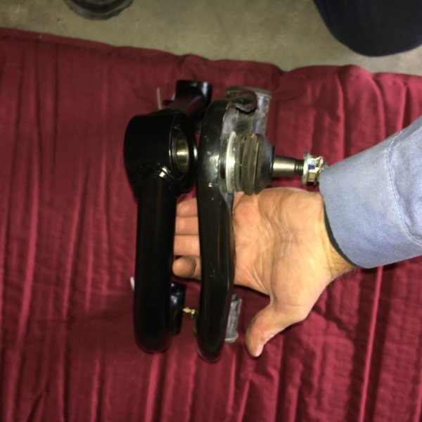

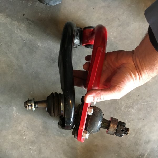

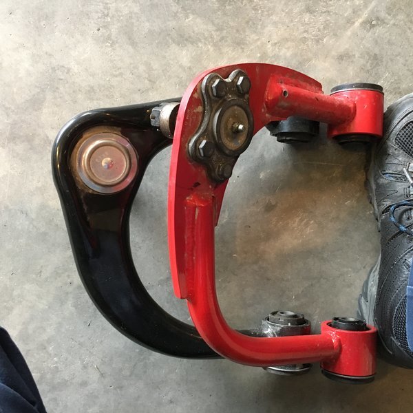

    IMG_0092.jpg IMG_0093.jpg IMG_0094.jpg So, there was a big difference between these UCAs and the stock ones. Here's a side by side comparison With JBAs and stock, side by side with both stock shows mirror image of each other, and side by side with new uniball UCAs and stock. Getting alignment right now and the camber and caster are WAY out after changing to new arms. The top of tire and wheel tipped out over 1/2" and there's way more room between rear of tire and body mount/fender liner.

    Stock to stock

    Stock to new uniball UCAs

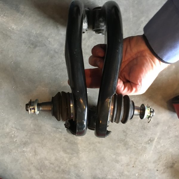

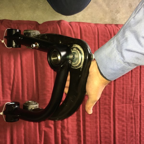

    JBA UCAs are boxed and will ship back, today. He said he is waiting to see why they are different.
    There was also a difference of where the balljoint was installed into each arm, with one being approximately 3/16" further towards rear of vehicle.
