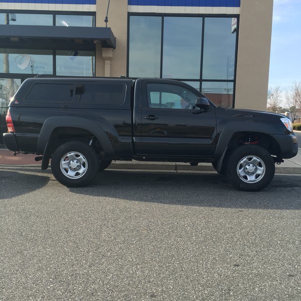

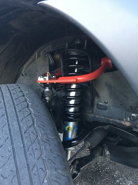

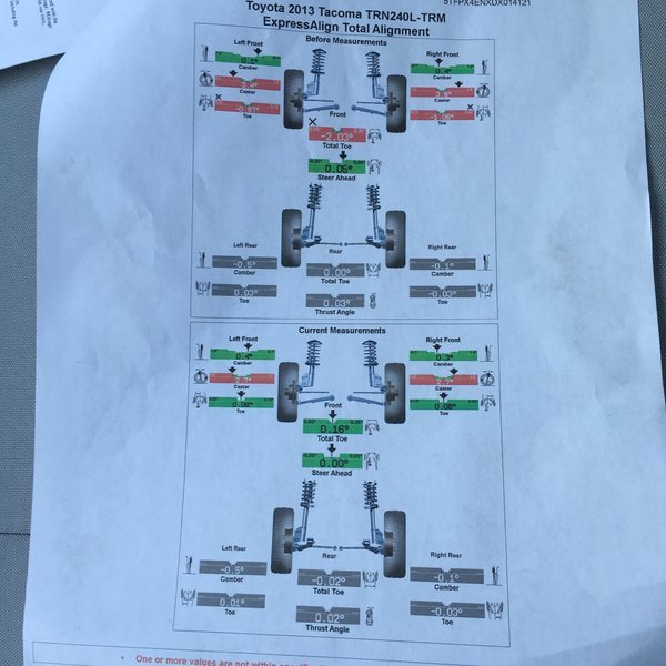

    Jba uca's, bilstein's 6112 and 5125 Alcan 2" rear springs, wheeler's super bumpstops. Michelins defenders 265/75/16
    I installed my jba arms with my other suspension components over the weekend. Did get an alignment today and numbers are spot on as far as I'm concerned. Great product by jba. In the spring will mount my f5's with 265/75/16. image.jpgimage.jpg image.jpg
    Dalandser, Sna and Blackout14 like this.

    6112's with their included spring at third notch. Alcan 2" rear springs with 5125 shocks. All the components exceed my expectations and enjoying the ride.
