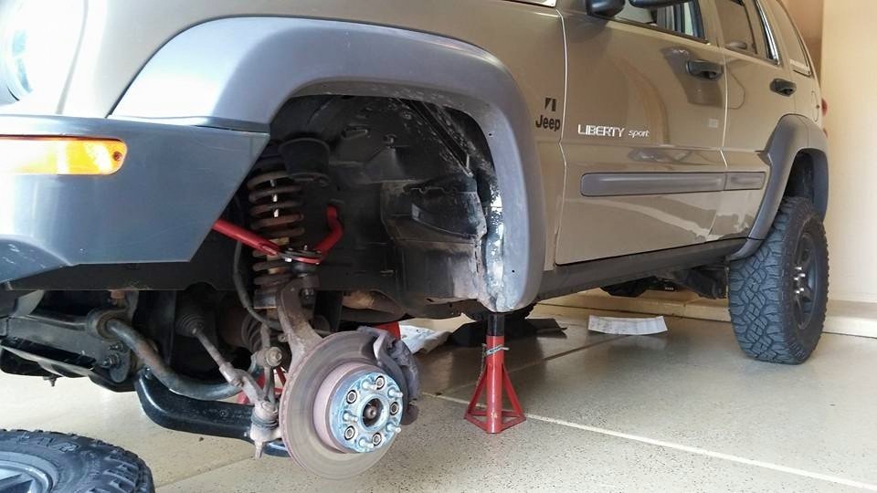

    I have a 2003 Jeep Liberty that has 3.5" lift with 245/75 Duratrak with a lot of weight added as well ARB and winch. I have his UCAs that he made for the Liberty (Gen 4.5) and I have to say they are amazing. People do not even realize that they are in a lifted vehicle (until winds gets you) when doing daily driving. But they are great off road too, no spring rub, alignment issues gone and they offer a good sense of security as well. I just changed my moogs after 4 years.
    Now I am looking at getting a 08 Tacoma and I am going to go this route right away. Marlin is also great to deal with, if you guys request him to get hard to obtain items for Tacomas, he might go out of his way to really get them. He got us Liberty guys a heck of a lot of options.
    And this was my first post, hope to learn a lot on here before I get my Tacoma!
    Just to show how they held up in Chicago salt flooded roads for 4 years.
    13402_4873375509365_1334203677381883875__d7c24d48f65cb914d014b5bc455af7f03b6be661.jpg
