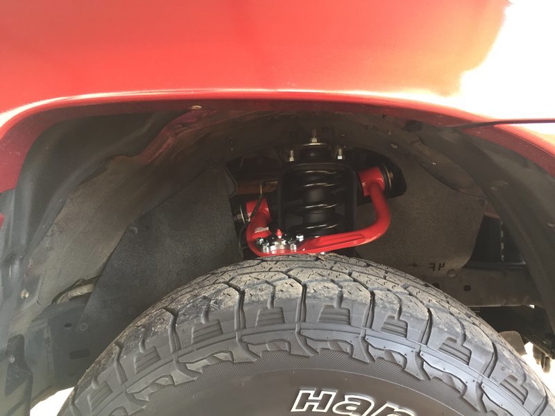

    Still need to install coils, so right now I can't really tell the difference. I used the Total Chaos UCA install video which tells you all the tools you need and give you step by step directions. Hardest part was getting the UCA long bolt out, as that requires bending the body to make room for it. Other than that, it wasn't bad
    Oh and to bend the body you will need large channel locks. My normal size ones didn't do the job

    Here it is with some OME 885 coils and Bilstein 5100 shocks! Can't explain how pleased I am with this product! Also, marlin got back to me about the nut, and it's a locking nut so I double checked that torque and I was good to go! If you are looking at getting this product, just go ahead and get it, you will not be disappointed!!

    Those look great! I will be ordering mine in a couple of weeks....

    The alignment numbers with these and OME 885s which gave me 2.5" of lift are awesome!! Im gonna get it aligned again next Tuesday because the morons that aligned it this this past week didn't give me 0* camber and 3-4* of caster like I told them to. They left it at .4* camber both sides and 5* of caster both sides... so you can get any numbers you need with these lol
