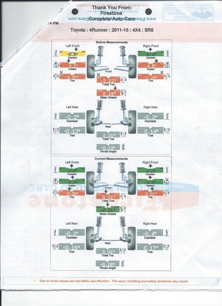

    Here are my specs from today's alignment. Drives very well, straight, no bump steer and just overall smoother on the road compared to the OEM UCAs. I did notice my tires are rubbing on both sides of the mud flaps. So I removed the flaps. I didn't have any rubbing before on the stock UCA's. Should I have another alignment done? Anything in particular I should have the tech tweak?

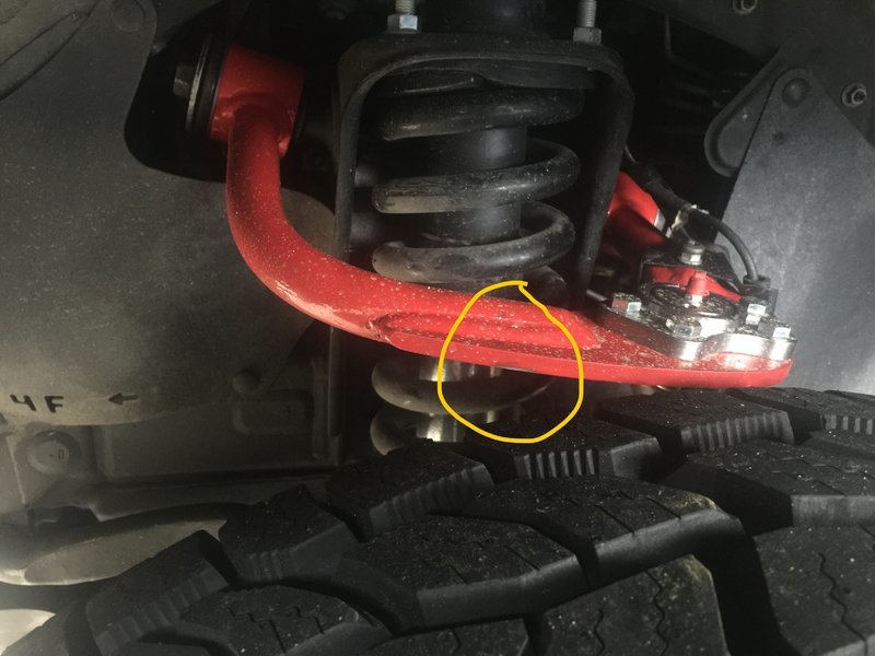

    Depends on the tire size probably. My 275/70/17s rub the arm on tight turns.
    JBA recommends 4.5" backspacing. I think the stock 17x7.5 TRD sport wheels have 5.5" backspacing. So I ordered 1" spacers.
    EDIT: Check out this pic you can see I circled where it rubs and the finish is rubbed off.
    Sna[QUOTED] likes this.
