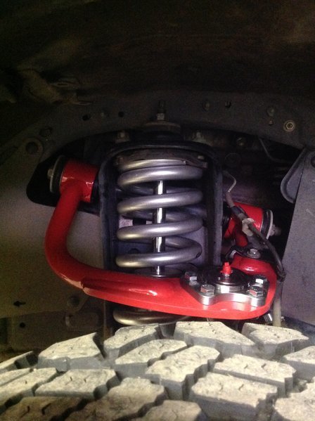

    I really liked the idea of the JBA but it didn't work for me. I'm sorry to see them go but there is a big difference in manufacturers.20170603_120026.jpg That's a Total Chaos on top of the JBA. And the pitch of the forward tube is higher on the TC. I couldn't turn my wheel very far before I would rub hard on the flat plate that holds the ball joint. Now I can turn full lock and stick fingers between the tire and uca. I'm not badmouthing the product. I really liked the idea of them but it didn't work for my application.

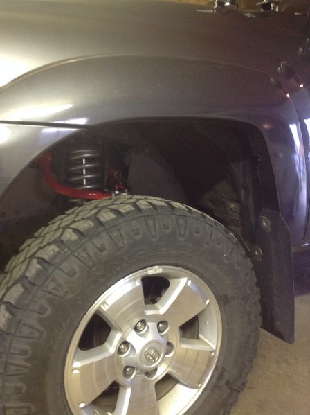

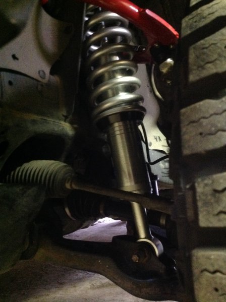

    Had my suspension installed today. 6112s w/ Eibach 650# springs, JBA UCAs, OME Dakar full leaf pack w/d29xl aal and Bilsten 5100 B110 shocks.
    Where to start....With the rear set up above the ass end of the truck is quite high (almost too high). I have a SnugTop Rebel cap and a sleeping platform in the bed all the time but I did the aal because I will have a rear bumper, tire swing out and fuel swing out in a month and then next year the cap goes for a bed rack, RTT, fridge and gear. I will measure and take pictures later this week.
    Installed the 6112s and 650# Springs on the 4th notch- HOLY MOTHER OF it is high (not almost as above, but actually too high). I did not get solid before measurements but I'm looking at just under 4" of lift in the front. I know the 650# springs are stiffer than the 600# ones that come with the 6112 kit but DAMN it's almost like they're installed incorrectly. I put the 650# springs in because I'm doing a CBI aluminum bumper, winch, aluminum skids and slider right away and wanted to compensate for the extra weight. I should have gone with my gut and put them on the 3rd not but because it's so high I may need to drop it to the 2nd notch. I have no idea why it's so high and I'll be addressing that this week.
