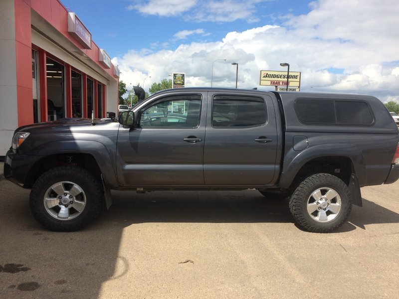

    Looks so much better with the front lowered. Sloped parking lot.

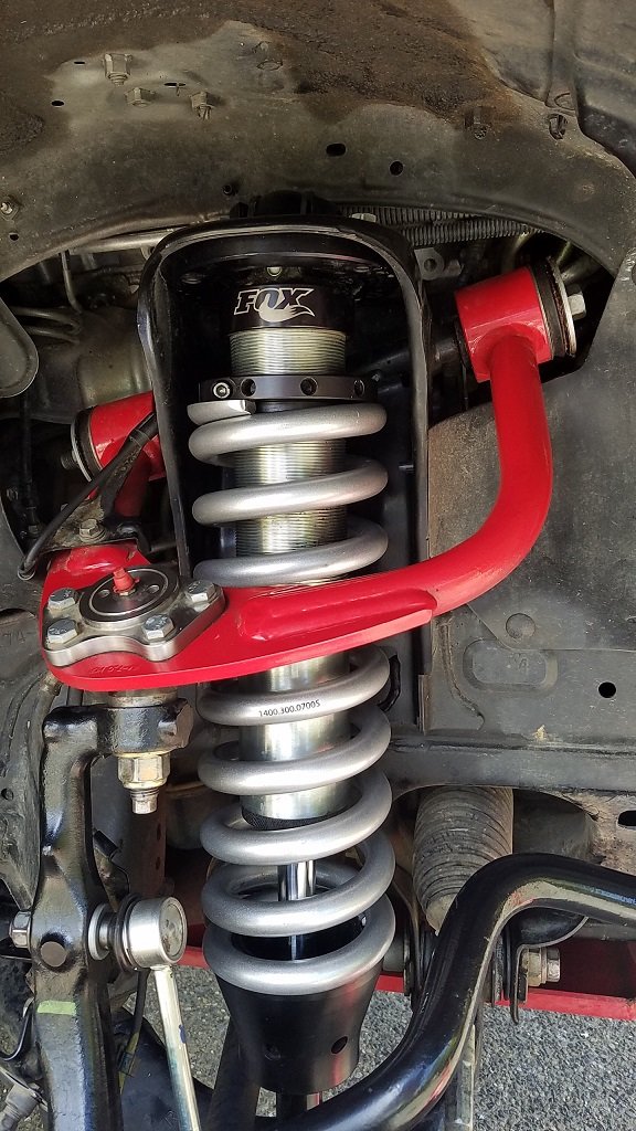

    I initially installed it wrong the way at first. Took everything apart and put the washer between the BJ boot and spindle. I added an additional washer between the nylock nut and spindle as well.

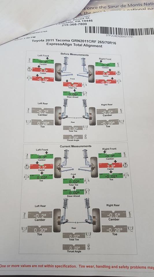

    Well my alignment was kind of ugly today and it still is haha

    Once I get the paperwork I will attach it haha

    There she is haha
