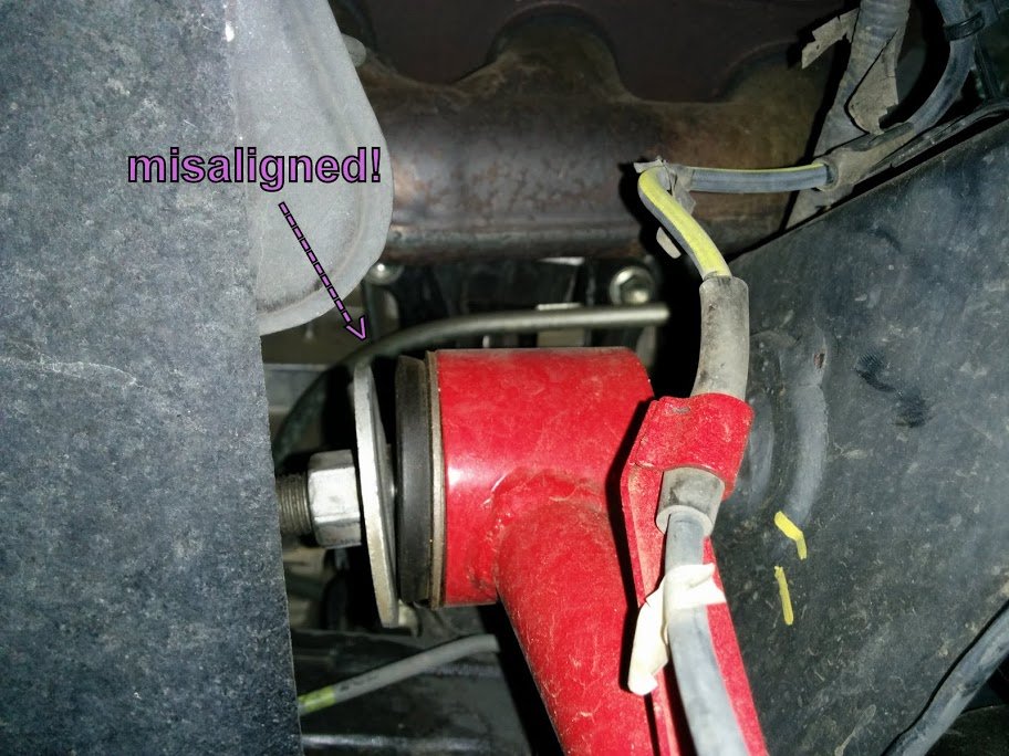

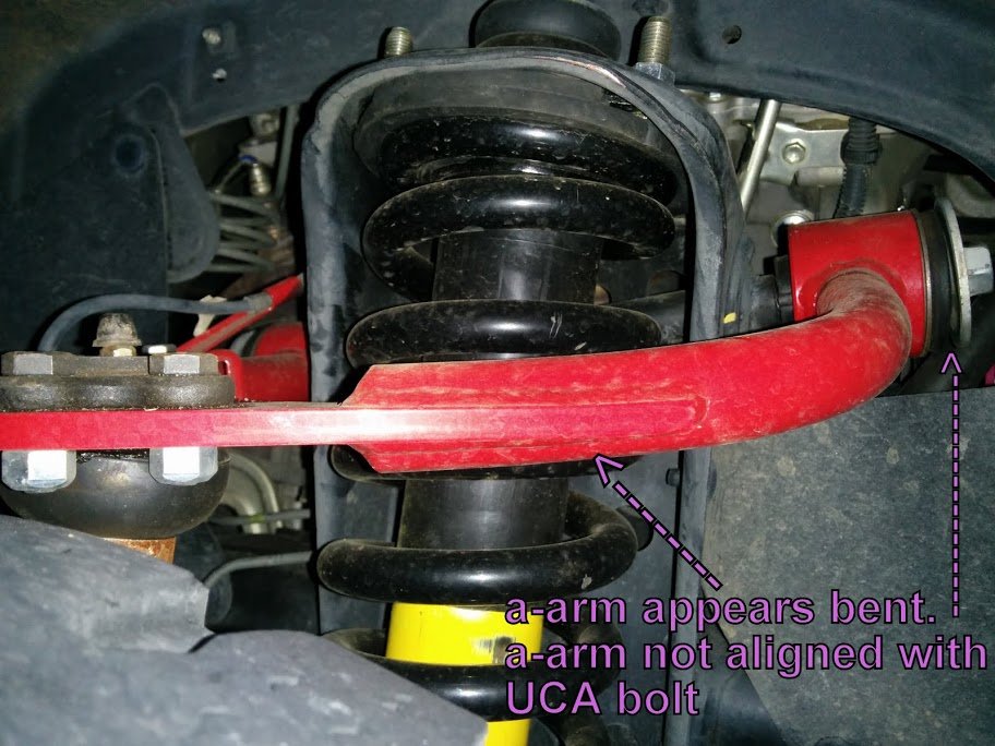

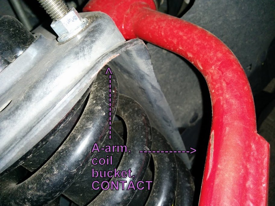

    For those of you that have the original JBA UCA, I would encourage you test your install by cycling your suspension very carefully before hitting some trails.
    Under near full compression my UCA's make contact with the coil bucket and bind. I did not know this and now I've have some bent parts. I'm hoping the UCA bolt will come out and is not bent, but as it stands the UCA bolt is misaligned with the a-arm, so I can't be sure until I go to swap it out. I'm not happy about having to reinstall the a-arms but that's what I get for being one of the first.
    For what it's worth I was alerted by another member (via PM) of the biding issue and did not discover it myself until I went and inspected my suspension.
    I've contacted Marlin with my warranty issue and he has updated the design of the a-arms with an increased radius to clear the coil bucket. I have also received my warranty replacement a-arms.
    Marlin gets high marks in my book for being extremely responsive and acknowledging and immediately correcting the issue.
    I also notified the thread OP by PM on June 17th and let him know about my issue. I waited for some kind of cautionary warning to be posted for others who have bought the a-arms but no warning came.
    Therefore, I have no problems sharing my story here.

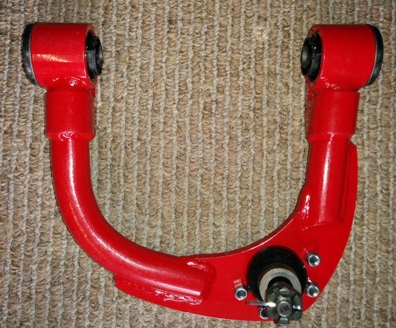

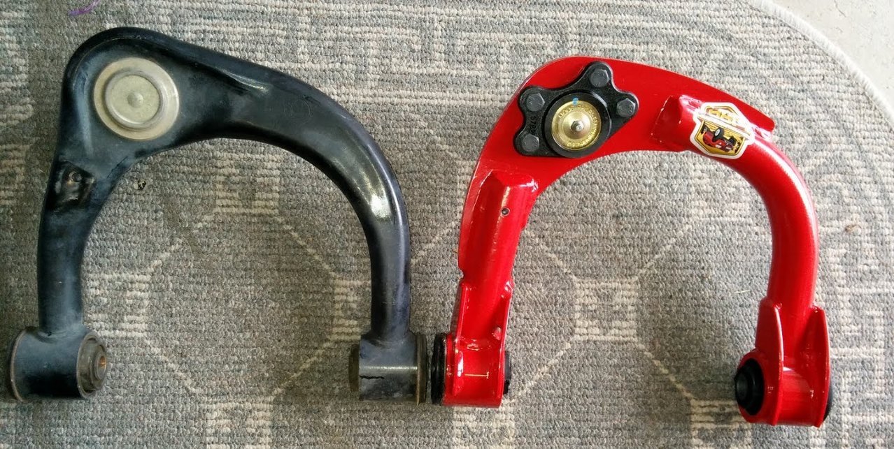

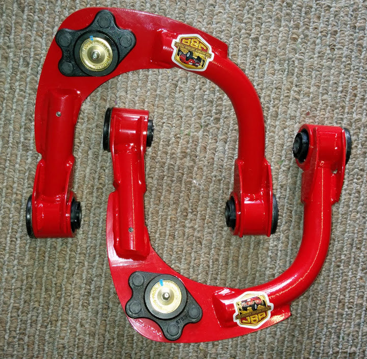

    For whatever reason Marlin sent me the HD arms as a warranty replacement. Fine by me. I can tell you they are serious beef. I think the plate in the a-arm is 1/4" thick.
    For reference
    • The stock a-arm is 5.64.lbs.
    • The original a-arm is: 7.47 lbs
    • The HD a-arm is 9.77 lbs.
    Now here are some pics of the updated design:
    Note the increased radius of the JBA arms, which appear to match the stock a-arm.
