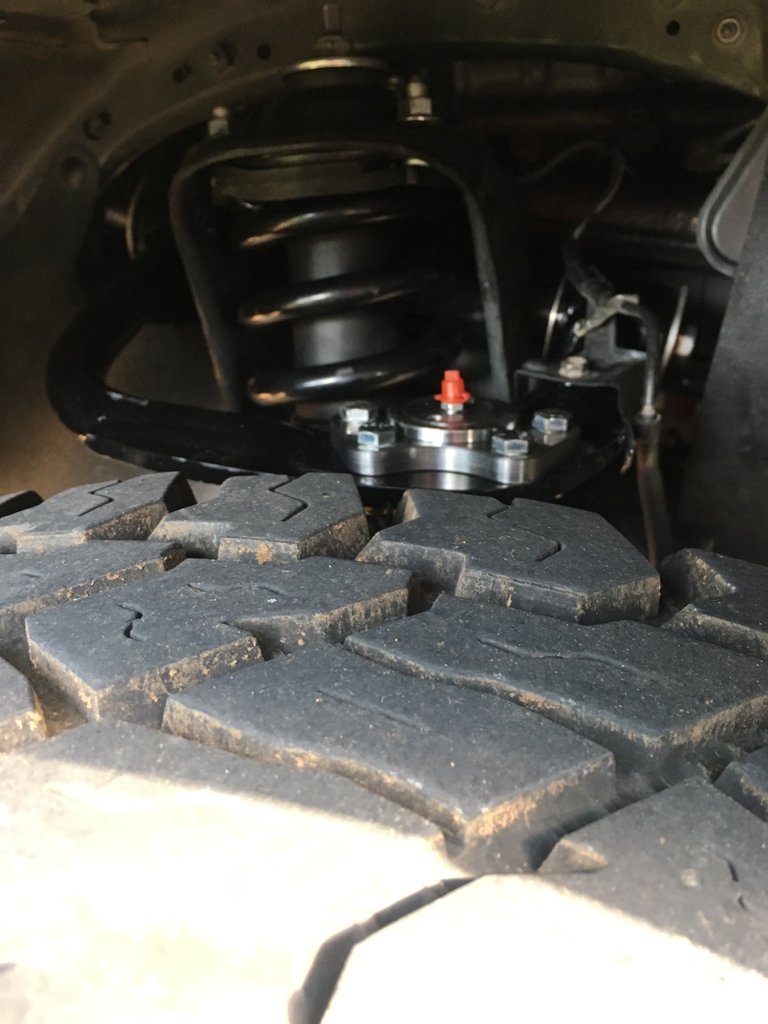

    Hey Guys, I installed my JBA High Caster UCA's and received a new rubbing sound after they were on. Found out that at full lock my inside tire wall is rubbing pretty hard. I have 35's and a 4.5 backspacing setup. I'm wondering if anyone has used (found) 1/4" - 1/2" Spacers before. I can't find any besides getting them custom made by uswheeladapters.com. Anyone else run into this?

    You can find 1/4" and 1/2" spacers for our bolt patterns on eBay and Amazon but you'll need longer studs to run them.

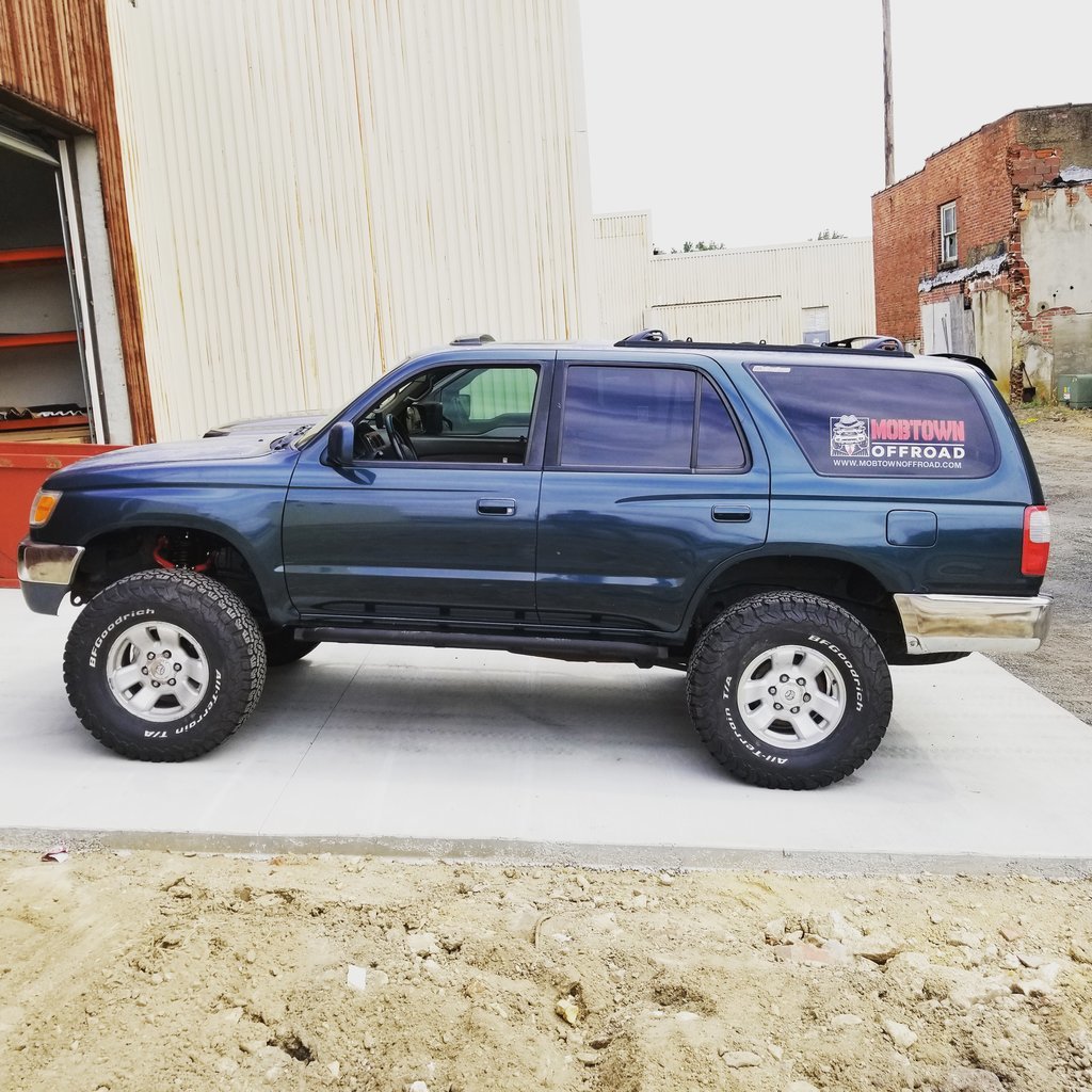

    I installed his first set for the 1st gen Tacoma, 3rd gen 4Runner last week. Did a lift too with the UCA's.
    1.25" Spidertrax Spacers and 285/75-16 BFG KO2's

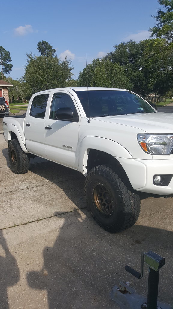

    Got my rims and tires on today. I had problems rubbing my JBA UCA's with my previous setup when at full lock. 18x9 4.5bs fuel mavericks 275/70 /18. My new setup is 16x8 4.0bs ray 10's 285/75/16 general grabber x3 absolutely no rubbing. I have a good inch of clearance at full lock. 20170725_172950.jpg
