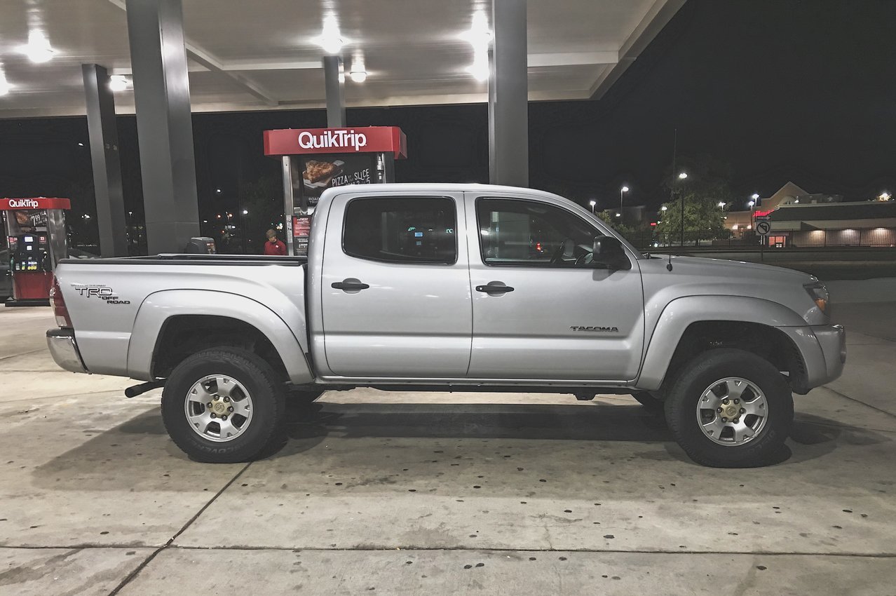

  4. Sep 22, 2017 at 7:49 AM
    #1464
    Boston10Taco
    Boston10Taco Dented
    Oct 3, 2012
    #88261
    2,372
    MA
    2017 Tundra
    Hey Rick, how old is this pic? That tire looks like its in pretty good shape. :thumbsup:

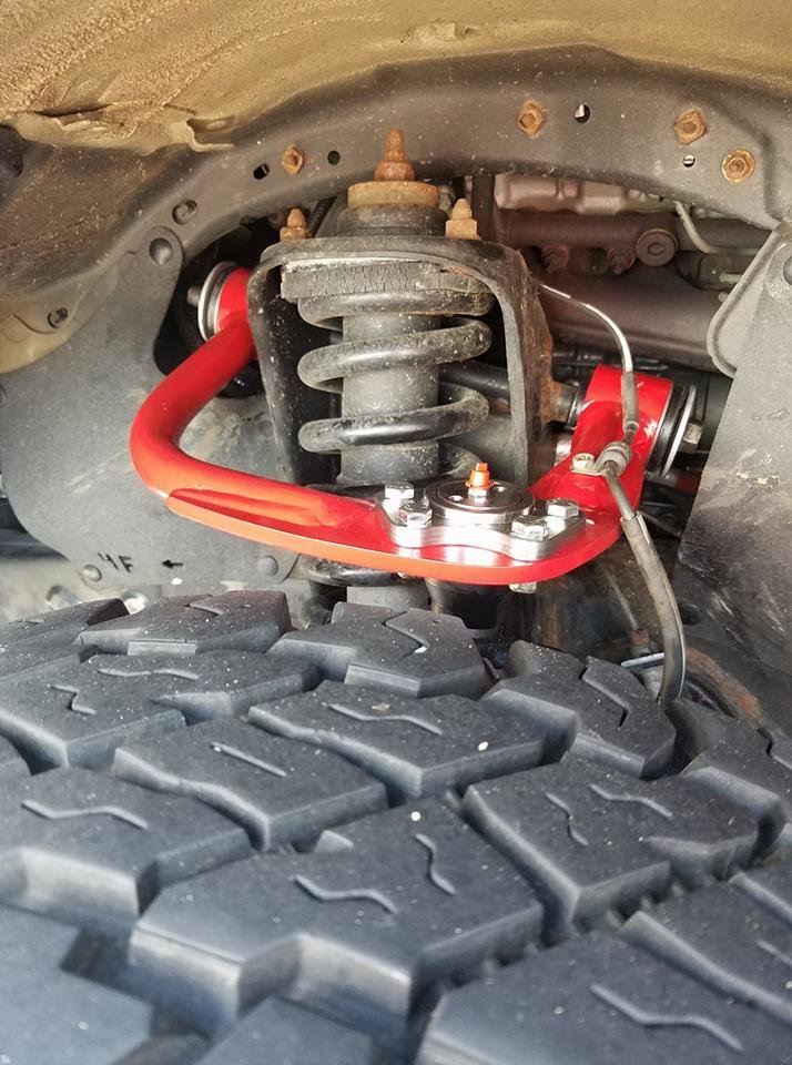

  13. Sep 26, 2017 at 10:58 AM
    #1473
    Taco'09
    Taco'09 Well-Known Member
    Dec 31, 2008
    #12073
    1,877
    Anyone had clearance issues using the JBA stock replacement arms with 16" TRD off road rims and 265/75-16 tires? There is not much space as it is on mine between the stock UCAs and that size tire and wondering if using the JBA stock replacement (low caster) arms might possibly rub.

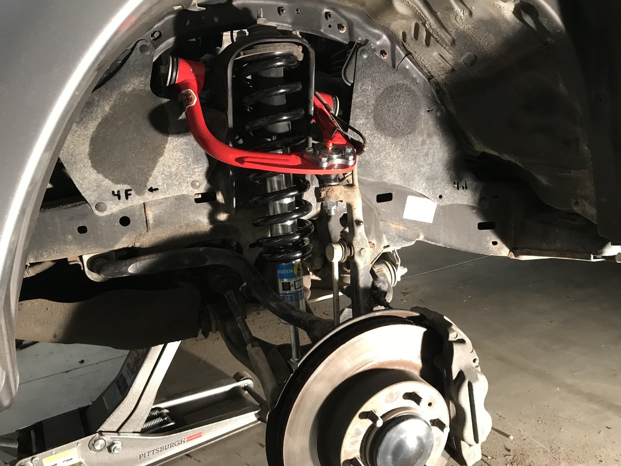

  14. Sep 27, 2017 at 8:52 PM
    #1474
    Eh2_erik
    Eh2_erik Locally World Famous
    Sep 6, 2017
    #229310
    15
    2009 DCSB TRD Off-Road
    Just installed my High Caster UCAs tonight, getting an alignment tomorrow!
    Shown here with my 5100/885 setup

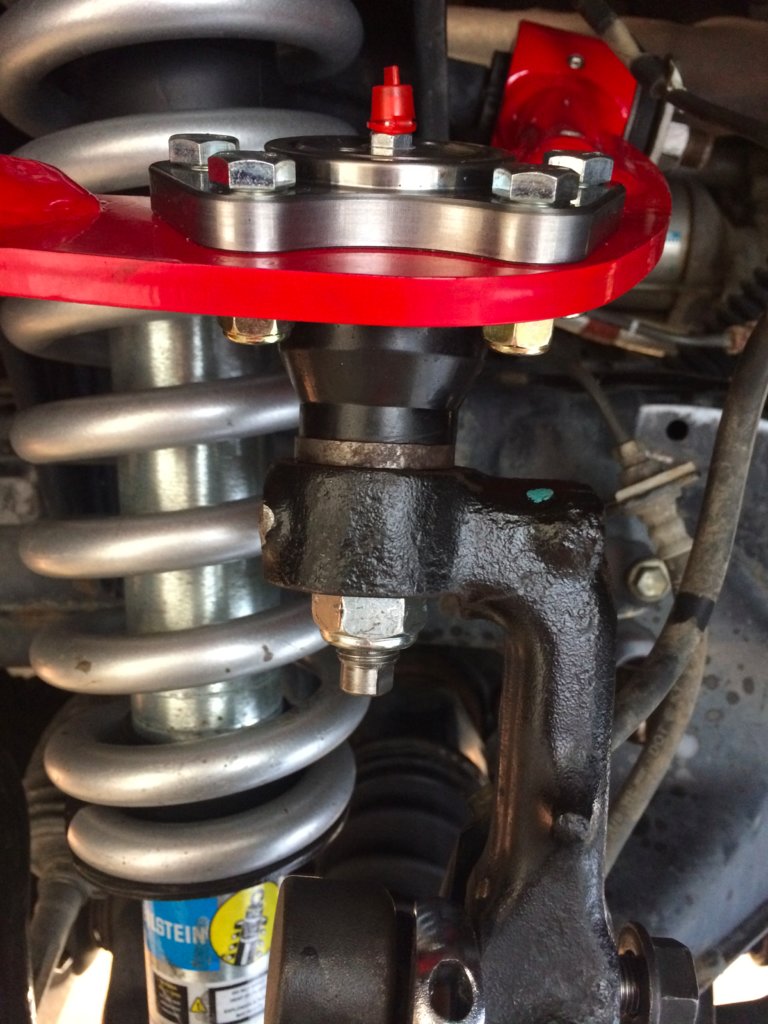

  15. Sep 29, 2017 at 6:04 PM
    #1475
    Prettymuchstock
    Prettymuchstock New Member
    Sep 29, 2017
    #231548
    Cameron
    Colorado
    04 TRD Taco
    3.5” lift with JBA arms on 33x10.5x15 Grabber X3's
    Question about the install. I know to remove the old ball joint from the spindle you need a ball joint press, but do you need to use the press to seat the new ball joint bushing in the spindle, or are they only held in by circle clip?
  16. Sep 29, 2017 at 9:01 PM
    #1476
    Eh2_erik
    Sep 6, 2017
    #229310
    15
    You can use a ball joint press by the best way to pop a ball joint out is to loosen the nut, then give the spindle a couple good hits with a 3lb or more sledge hammer. It’ll pop right out. The tapered stud will seat itself into the spindle when you tighten the new nut down. I didn’t have that circle clip you have there, not sure what that is.
    https://youtu.be/bbsTJgb6S_c
    Watch this link, really good info. The hard part of installing UCA’s is the through bolts.
  17. Oct 1, 2017 at 3:13 PM
    #1477
    bassfish319
    bassfish319 Well-Known Member
    Jul 25, 2015
    #160308
    51
    2014 Tacoma 4x4 TRD
    Mine didnt have that black bushing there either? The bolt that comes off the moog joint through the spindle only has a few threads showing once I tightened it down...not sure how that would work with an even larger bushing then the metal one I have on there
