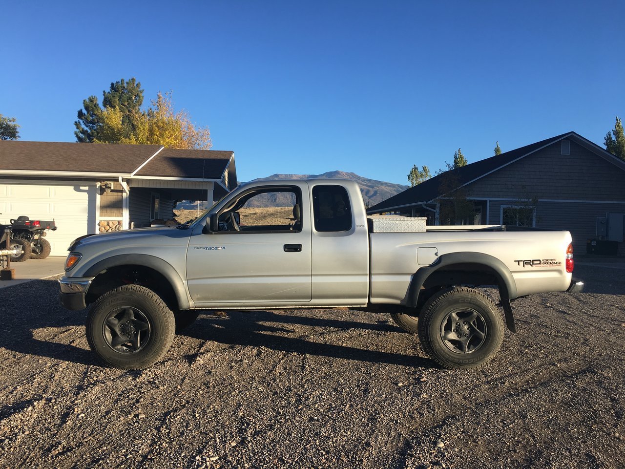

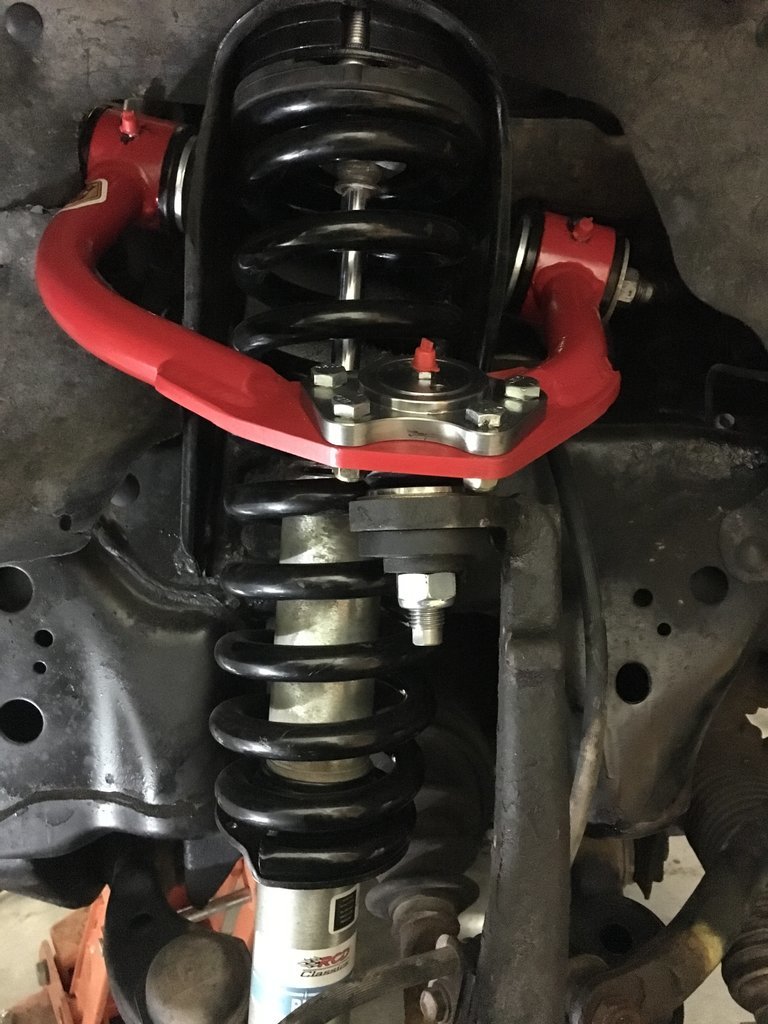

    Just got done throwing some JBA's on the 02. Good combo with the OME 881/bilstein 5100's. The all pro expo leafs in the rear are tall!

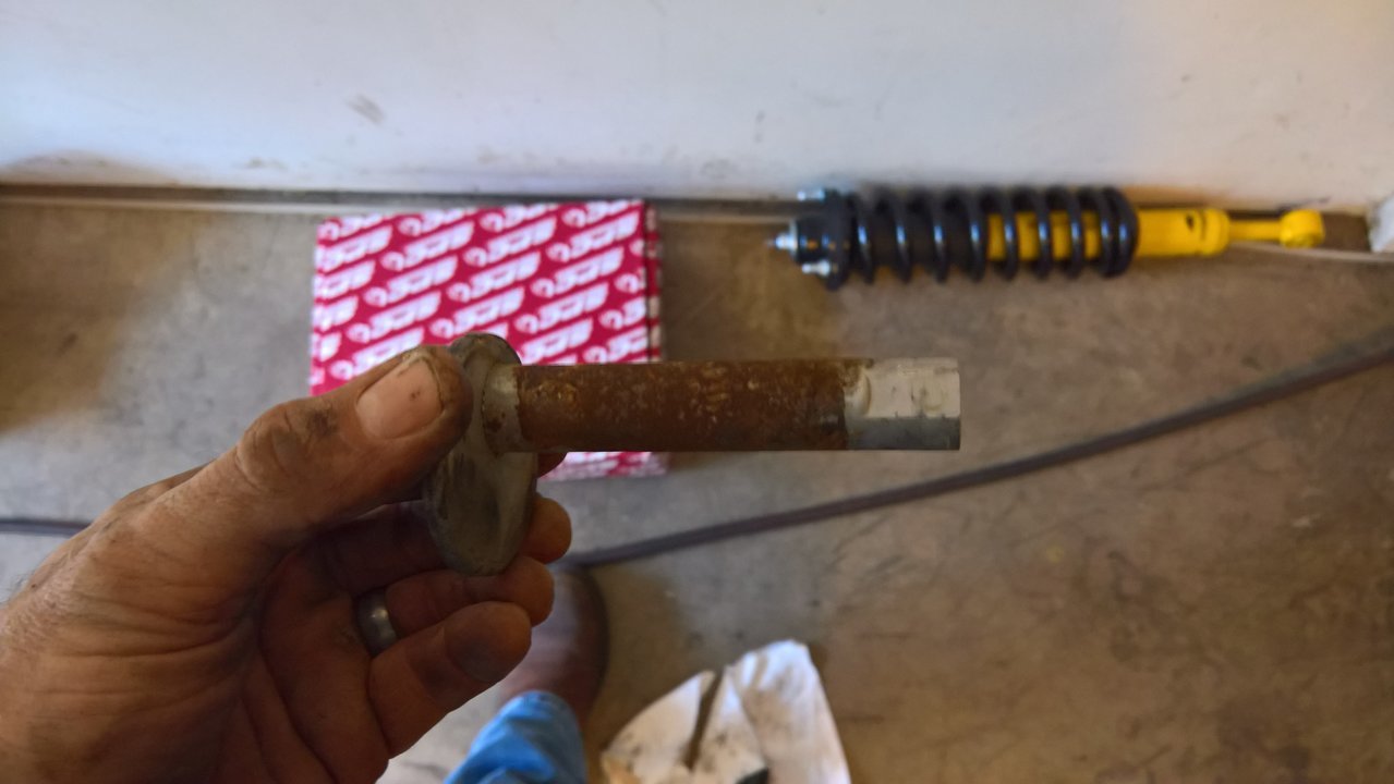

    Went to get an alignment with the hopes of getting 2.0 to 3.0 caster. unfortunately that dream with have to put on hold because of froze up lower control arm bolts

    Ugh gotta love that shit huh? When I put my new UCA's in I had the guys remove all the cam assemblies and lube the fuckers up.

    Lucas Red n Tacky goes on everybody's lower cams that I do installs on. This was one that came off of a 2011 Texas truck. Thing barely came out.

    Not anti-seize? :confused:

    Lucas Red n Tacky has Anti-Seize in it, and it won't wash out either. Really good stuff. It's like Franks Red Hot, I put that shit on everything.

    I never was able to get my lower control arms cam bolts to move either. Luckily my numbers were still within decent range.

    Cut em out and put whiteline bushings in. Then use greasable cams.
