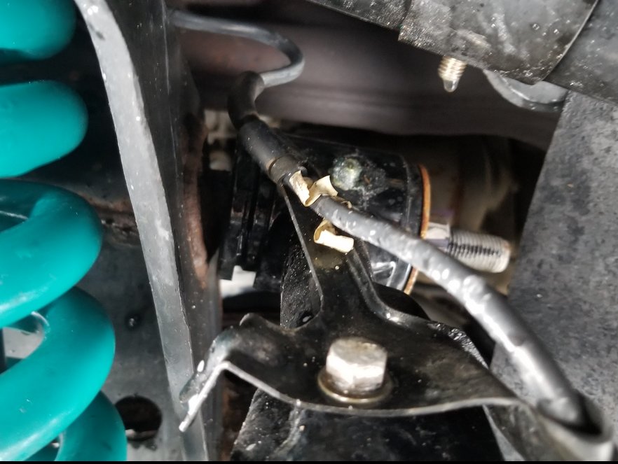

    C7mb
    C7mb Well-Known Member
    Feb 13, 2016
    #178110
    156
    Its hard to see but on the inner side, you can see the bushing has popped out over the "barb" of the frame connection point.
  6. Jan 9, 2018 at 3:29 PM
    #1666
    DrFunker
    DrFunker Well-Known Member
    Feb 3, 2014
    #122158
    42,919
    I see it. Hmmm....
    Wonder how that popped out? o_O
    I'll have to check mine.
  7. Jan 9, 2018 at 3:32 PM
    #1667
    C7mb
    Feb 13, 2016
    #178110
    156
    So originally, when my shop called Marlin, he said the arms could have been shipped with the wrong bushings, but to torque them first. We torqued them and that fixed it. But maybe they were, in fact, the wrong bushings? Also as a note, the JBA arms only come with washers for the outside where OEM has both inside and outside (thus sandwiching the bushings).

  9. Jan 9, 2018 at 3:35 PM
    #1669
    C7mb
    Feb 13, 2016
    #178110
    156
    OK so mine did ship with the correct number... Im wondering if they were designed to have four per side, as this would have corrected my torque issue (filling the gaps with the washers).

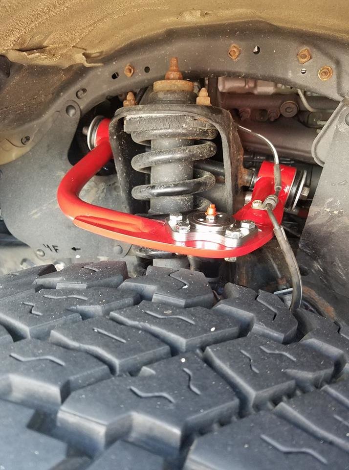

    Unchained 5150
    Unchained 5150 Rick
    Sep 25, 2014
    #139054
    65,355
    Rick
    Auburn Ma
    2021 TRD Poser Pro Manual.
    Mine went in with 2 washers per side on the outside only20729479_10209943137842761_8085224360285360390_n.jpg

  12. Jan 9, 2018 at 3:47 PM
    #1672
    DrFunker
    Feb 3, 2014
    #122158
    42,919
    That's what I thought too. Yup, that is what mine will look like too.

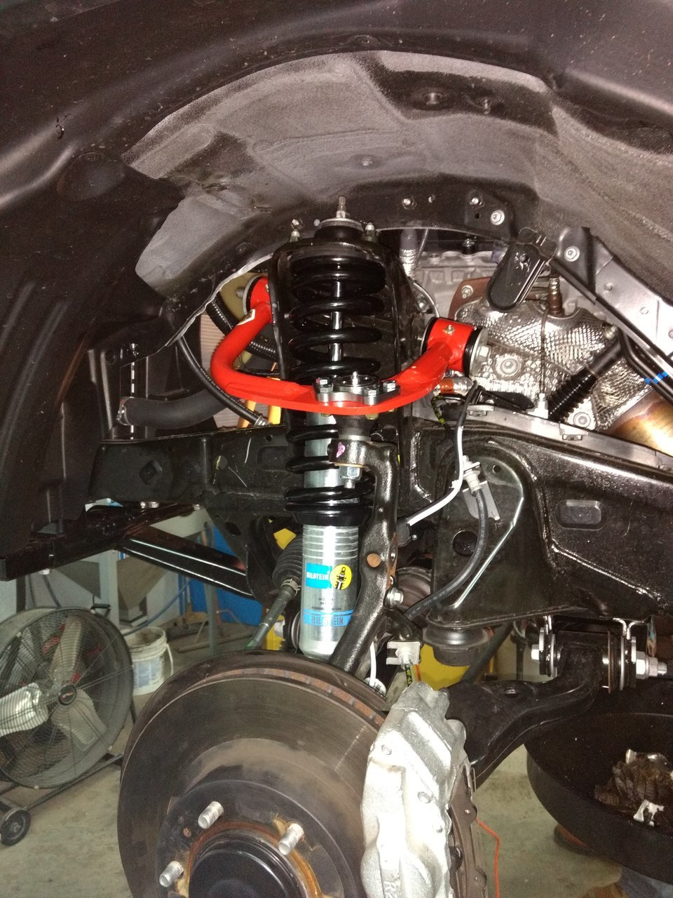

  14. Jan 9, 2018 at 4:47 PM
    #1674
    BadgerBoy
    BadgerBoy Well-Known Member
    Aug 31, 2017
    #228639
    953
    Brad
    Canton, Ga
    17' TRDORMT (Sold); 07' FJC
    https://www.tacomaworld.com/threads/my-17-tacoma-trdor-progression-most-of-it.673916/
    Put JBA's on my truck Saturday, we used 2 stock washers on the outsides and slipped the thin Jba washers in between to sandwich the bushing. Instructions are not very clear, but that's how we read it. 150 miles and no issues.IMG_20180106_161635124.jpg
