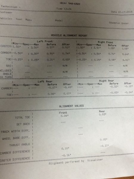

    Dropped my truck off for an alignment last night. Wrote him a note telling him what I wanted my numbers at and if I could get a print out. Hopefully he does what I asked. I'll post up my numbers if I get them.

    :facepalm:
    So before it was
    Left. Right
    Caster. .57*. 1.18*
    Camber. .90*. .76*
    Toe. .31*. .8*
    After: Left. Right
    Caster. .92. 1.08
    Camber. .74. .64
    Toe. .03. .01
    My pap took it to get aligned. And he said the guy said the caster adjusters were locked he was afraid they were gonna break. But he got the rest as close as he could. He said they would be fine. Well........ I guess we shall see. Ps I sprayed the alignment bolts/cams for 2 1/2 weeks with penetrating oil. Damit just wish it was closer to what I told him 0/0/2.5 Wow that looks so much better on my phone but when it posts the spaces are all fuked up.

    Looks like you need new bushings and this kit.
    https://www.tacomaworld.com/threads...lem-solver-caster-camber-cam-bolt-kit.317057/
    Bushings are Whiteline #W53312

    I've looked at the moog kit but have heard that it's not always the right one. And somebody. I think homertaco? Had the adjuster(washer) break loose.
