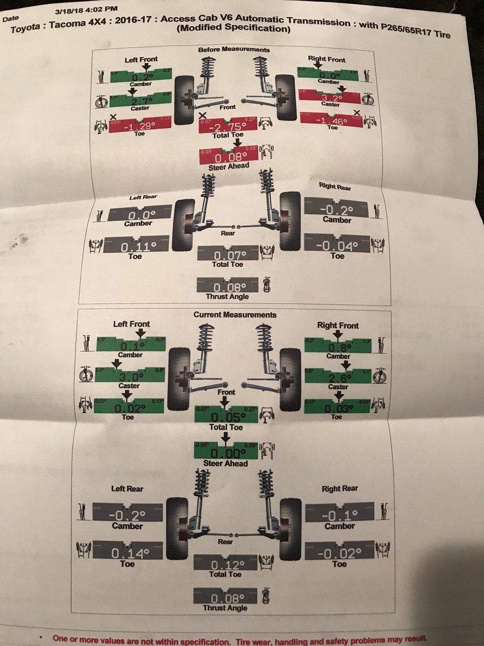

    Thought I’d share my specs after alignment today. Tires are 285/70/17 ridge grapplers. 6E46AFBB-A644-4342-BDFC-51B1FC20C5F5.jpg

    Thank you. High castor is in my crosshairs.....
