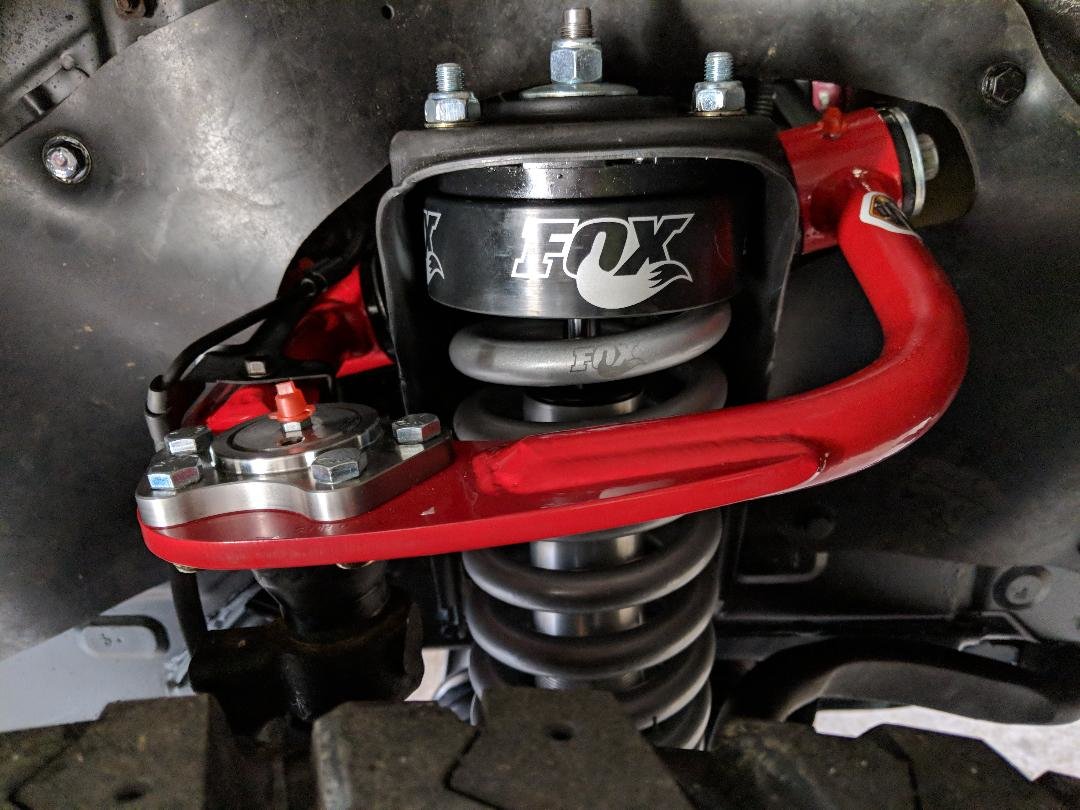

    So I did the install of the UCA. I'm pretty sure I did it right, this is the passenger side. I installed them the same way as the SPC UCA I took off.UCA.jpg

    So for reference my JBAs when aligned for proper toe and camber on a truck with about 2" of lift had a *minimum* caster of about 4.5*. The alignment guy couldn't dial the caster any lower. This guy honestly did know what he was doing, probably the best alignment shop in Vegas and he had done a lot of Tacomas. This in comparison to Firestone that did my original alignment on the JBAs and completely screwed the pooch leaving a full inch of toe while claiming they had gotten to 3* of caster.
    Write up in by build thread of the corrected alignment showing the drastically different cam positions compared to the Firestone bad alignment.
    The takeaway I think is that indeed you can get into a position where caster will be higher than you specify. In general not a big deal - unless that additional caster is causing rubbing which seems to be the problem you are having. The other takeaway is all the fancy alignment machines are only as good as the person running them - as Firestone demonstrated for me.
    There is of course variation in all trucks - that's why there are alignment cams to begin with - so maybe you are an edge case. Or maybe your spindles are slightly bent (common problem with these trucks when used heavily off road). Or maybe the cam tabs are slightly flattened (another common problem). Or maybe there is some corrosion on the cam sleeves restricting the adjustment range (yet another common problem). Or maybe there is in fact some variation/error in the UCAs. Or perhaps most likely it as little bit of all of those and in your particular case they all stacked up in the same direction!
