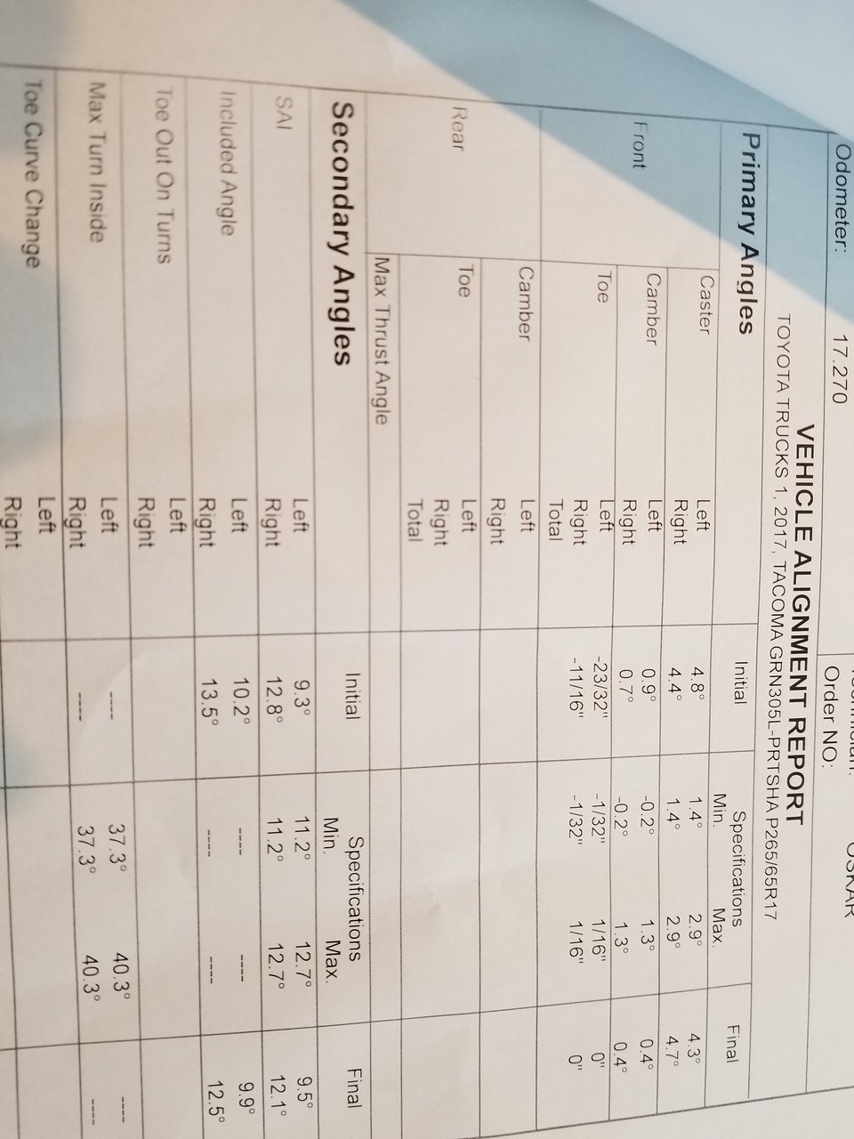

    Alignment after getting my total chaos cam gussets welded on

    Holy crap! Just saw, you have a 2017. They were flat already?

    Wrench monkey at firestone ruined them

    Also wanted to add that i have 17x8.5 0 offset wheels with a 4.75 back space on 285/70/17. I do slightly rub on the UCA only when reversing with the wheel turned until it locks.

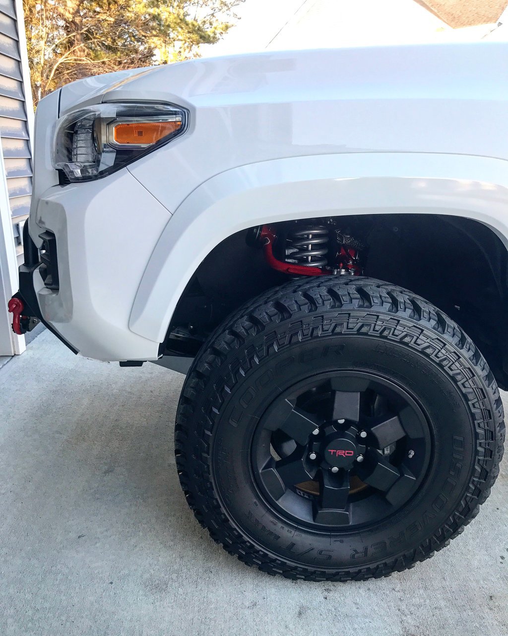

    I got the same thing going on. Except 285/75/16 on 16x8 Konig Countersteers. Debating what to do next. Wheel spacers will probably make it rub on the cab mount.

    Yea, kinda irritating though. Bought the Konigs because JBA says we need 4.5" of BS, when actually more is needed.

    Yea, it's not a huge rub. And only in reverse worse on an angle like a driveway. Haven't noticed any at full lock going forward. All I would need is maybe a 1/4" more bs...

    Rubbing on uca, not on cab mount. Running 3 degrees of caster. May just live with it.

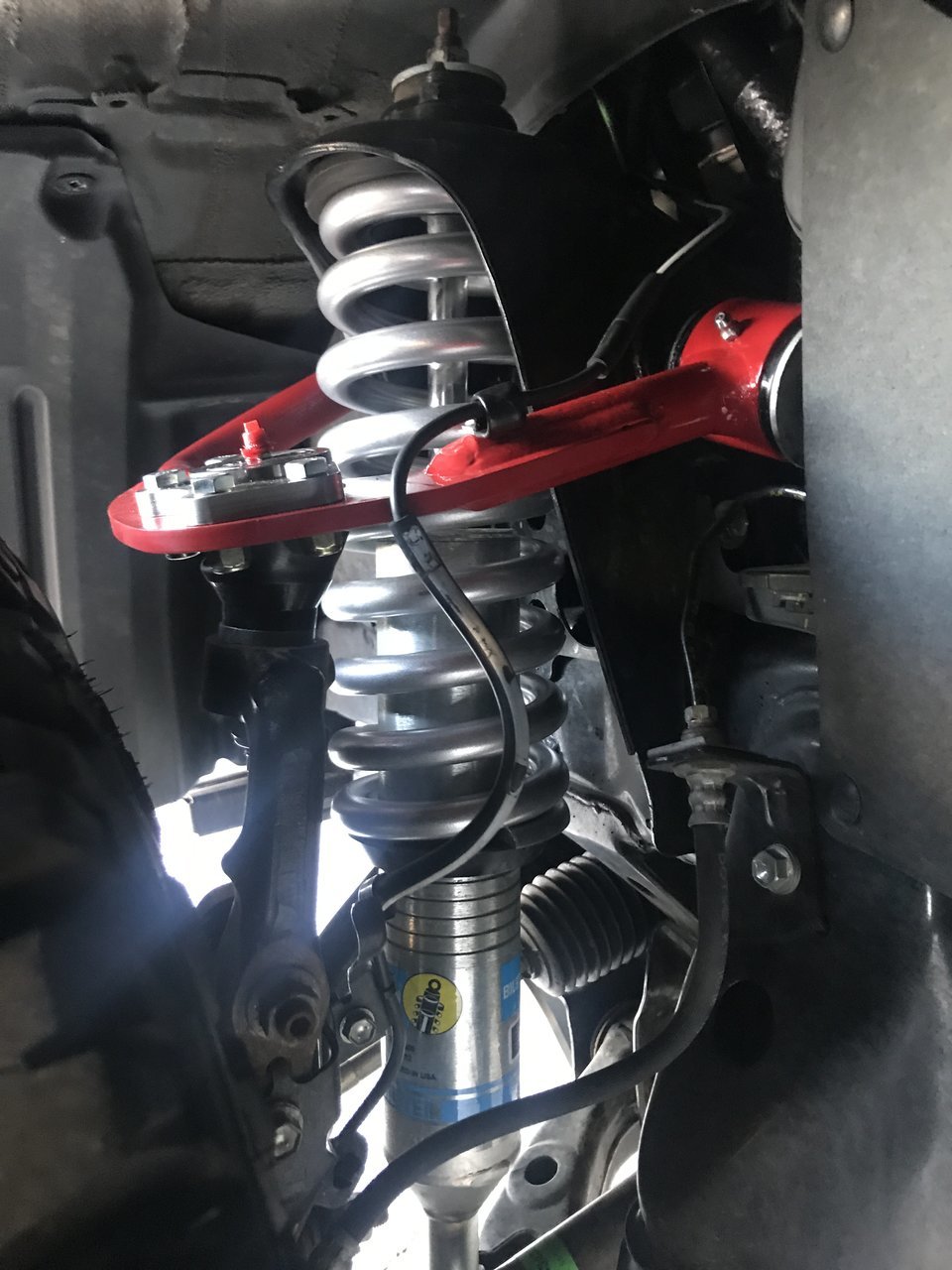

    Joined the JBA crew :thumbsup:
