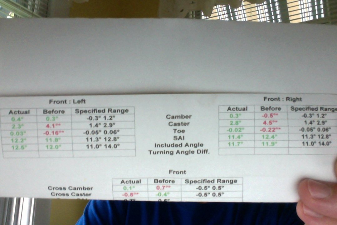

    Hey guys, would those of you running the high caster UCAs mind posting your alignment specs. Im on shop number 2 here, they wont put the caster where I ask, and they keep telling me that my truck is a PITA to align. Im getting a little fed up frankly.
    With the high caster arms we should be able to align with 3-4 degrees positive caster, yes? Both shops I have gone to wont give me more than 1.5-2 degrees.

    Here is what I'm currently at after my latest try this afternoon...

    My toe and camber are both at 0, and I have 3.1 on one side and 3.4 on the other with my caster. My tech said it was a piece of cake to align.
    EDIT: are your cam tabs seized? Maybe that's part of the issue.

    dafuq is going on with the camber? o_O
    EatSleepTacos likes this.

    Or tabs flattened? Would that screw around with shit?

    Brandy brand new cams installed today right before taking it to the shop for alignment.

    Thats why im pissed, the camber shouldnt be like that, but the guy said that's all he could get. I don't believe him.
    And I checked all the tabs today when I installed the new cams, they are 100% fine
