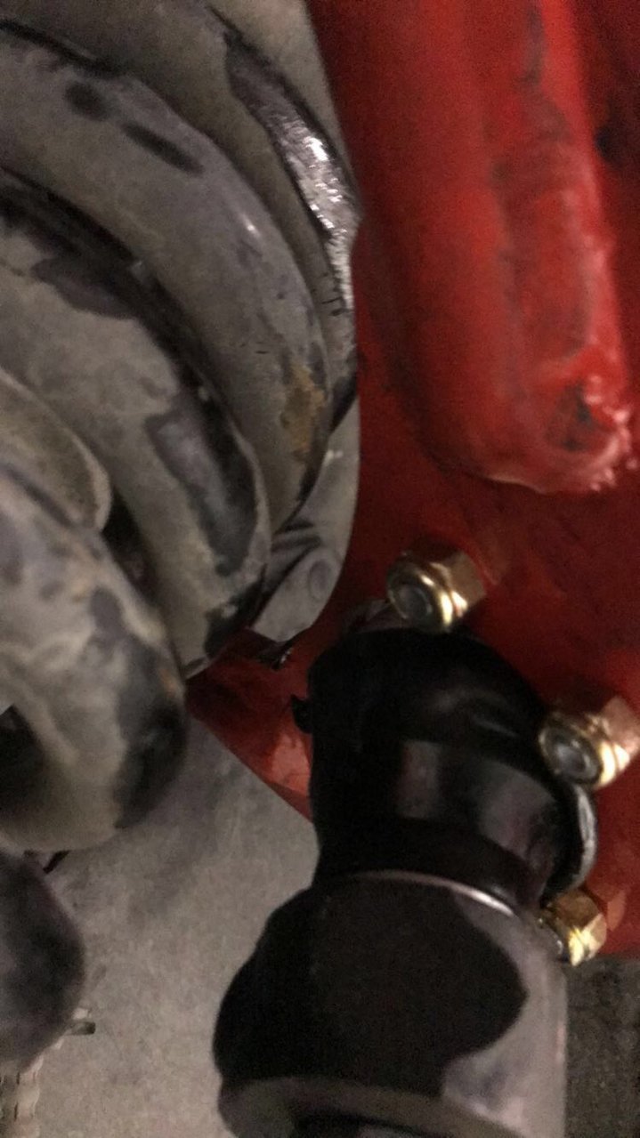

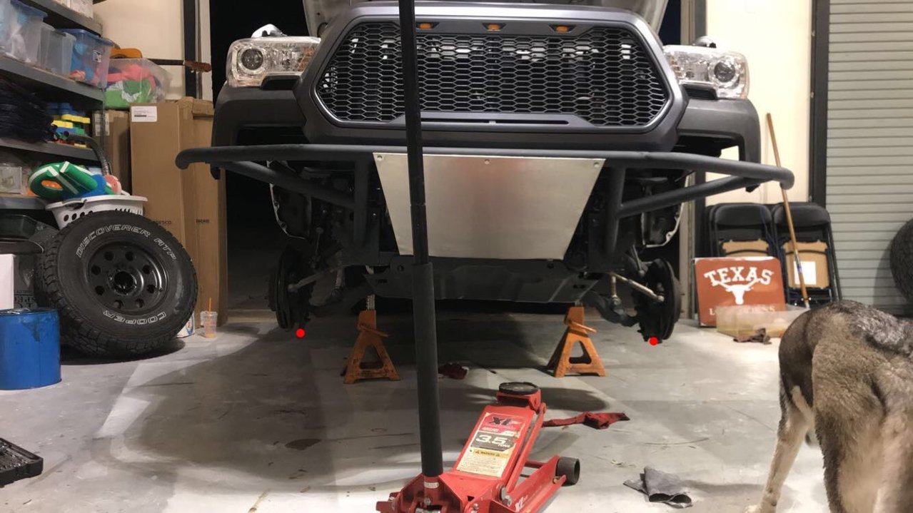

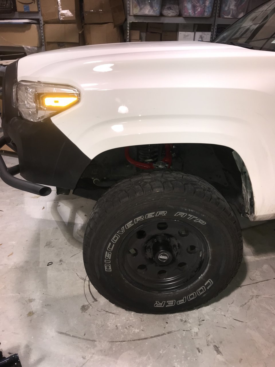

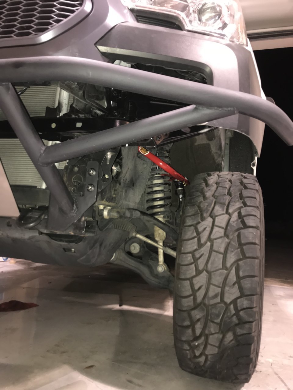

    Good afternoon everyone! This is my second post ever here I want to thank everyone for the welcome messages. This post is about my new JBA upper control arms that I recently installed. There is a huge difference in down travel (it is hard to notice in the picture but in person you can tell left is oem control arm and right is the jba). I think it’s great that the control arm doesn’t hit the shock anymore at full articulation. The ball joint has a crazy amount of articulation I honestly couldn’t believe it! I will post some pictures of the UCA tonight and tomorrow I will try to go wheeling and get some good pictures there too! Feel free to ask me any questions about the upper control arms. I know when it came to picking these there was some lack of information and pictures about them so I’d like to help a future buyer or just an interested person. Thank you!
