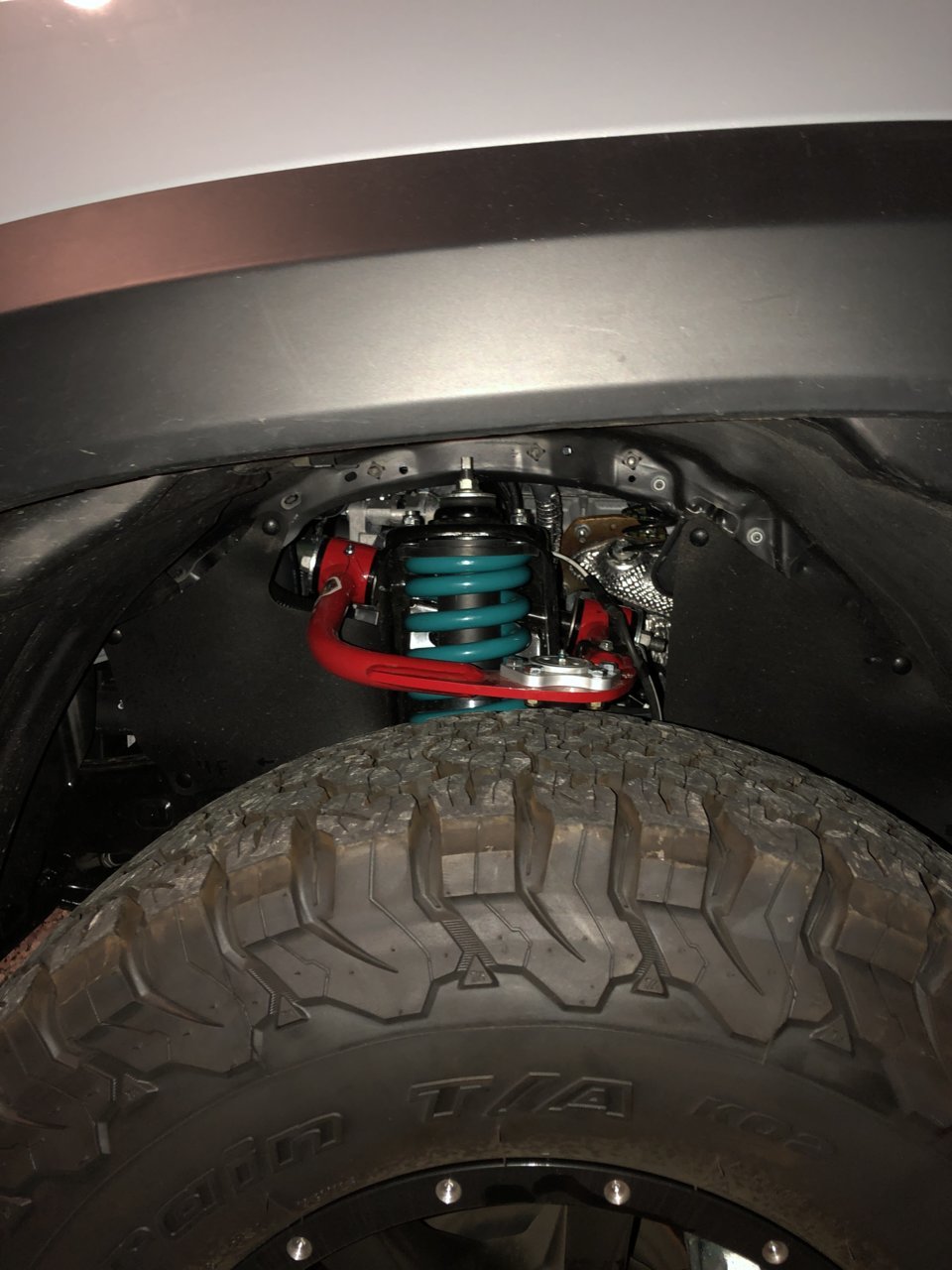

    What Dobinson coils did u go with? Any advice on jba install? Just ordered a pair to go with my Dobinsons.

    I did the 314 medium load put on second clip. To get the control arm bolts out you have to bend the inner front splashwells a little. I used c clamps tighten then pulled on them enough for bolts to pass then just took a rubber mallet and taped them back with ease. U WILL NEED 2 PEOPLE FOR THIS.

    314 on second clip is 3” or a tad over. On stock weight at zero clip is about 2 1/4. I have the avid front bar on mine

    Just an fyi i have 265/75/16s and had my caster set at 2.5 and rubbed pretty good and had to cut front rear inner liners some. i got it pushed up to 3.2 now i got great turning clearance so my align specs are now...toe 0 camber 0 and caster 3.2. If it helps any. Truck does great on highway and tracks perfect

    I did solo install. You gonna need a breaker bar to pry the UCA while inserting the washers

    Front Elka 2.5 non resi with 650lb spring Rear Serviceable 5160's with AAL 265/75/r16 BFG KO2
    or you can cut them and put them in reverse. had to do this today. check your local toyota stealership. bolts are like 10-15 bucks each. putting them in the other direction is a little easier to service in the future and cutting them saves time and bending. just up to you. I bent the drivers side (and installed the bolt back the factory way cus the brake lines were a bitch) and cut the passenger (cus i couldn't bend the frame enough and installed the bolt back in reverse cus it was 100% easier)

    wait you have 265/75r16 and rubbed with lift and UCAs? I had them before lift and didn't rub. after lift without UCA's and didn't rub, and now with lift and UCA's at 2.1 and 2.5 caster and still don't rub. So weird. I guess that "every truck is different thing" applies here huh. any idea why?

    Only thing i can think is because the jba arms are high caster built in
