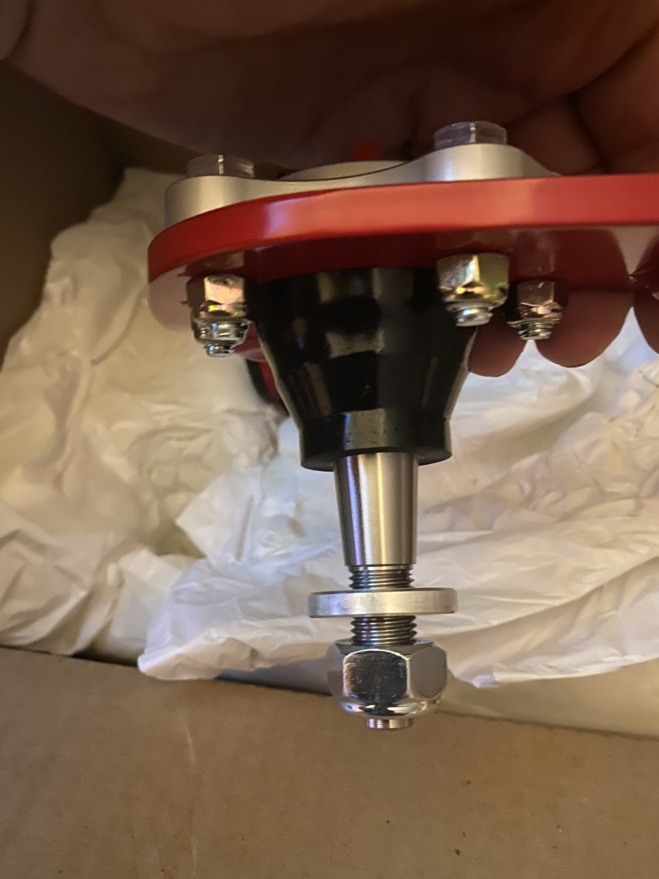

    Just received my JBA uca and they both were shipped with 2 washers each. So I watched the install video and it showed installing 1 washer then I talked to Marlin he sent me this link and it shows that you should be installing 2 washers on each side because the boot on the ball joint is not pushing into place.

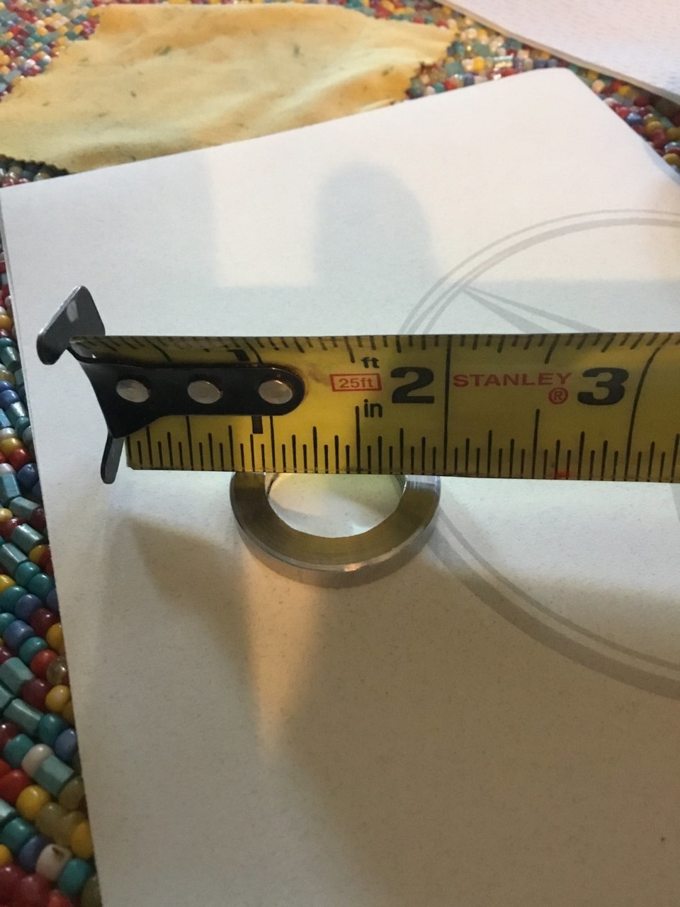

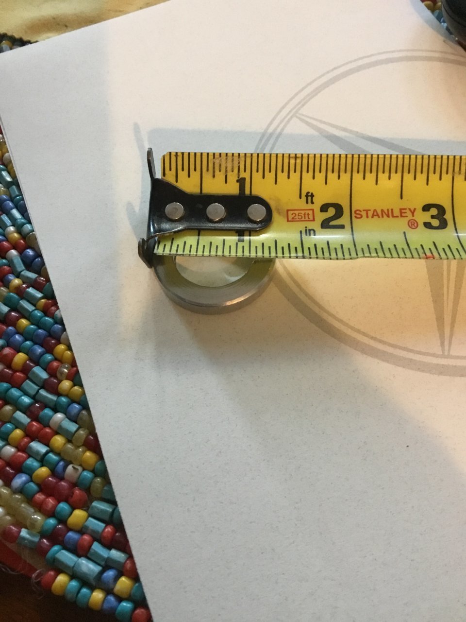

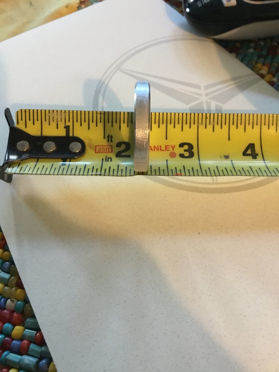

    Here you go it’s 1 1/4“ OD X 3/4” ID x 3/16” thickimage.jpgimage.jpg image.jpg
