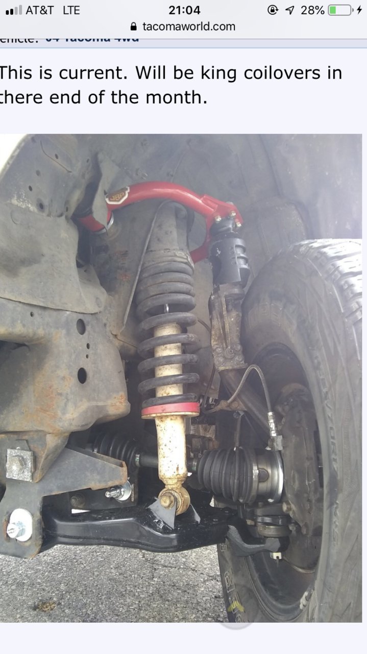

    I guess what i am afraid of is this.82A64B64-97E3-4947-8DF8-1AA1F72D5EAF.jpg

    That is not how the maxtrac work they move the bearing mounting point down. What that guy did is fuck his geometry completely and did nothing but angle the uca upwards. That's a hacked and cobbled together drop bracket lift. You are fine!
