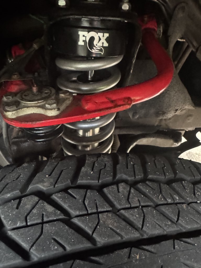

    Has anyone else run JBAs with 4Runner wheels (having the slight offset) and experienced a grinding sound on front left at full steering lock on one side? I thought it was grinding my ancient dust covers (new ones just arrived) but contact points suggest it’s perhaps the edge of the left UCA and I’m trying to trouble shoot. (Right UCA shown for reference, will snap the left and update shortly)
