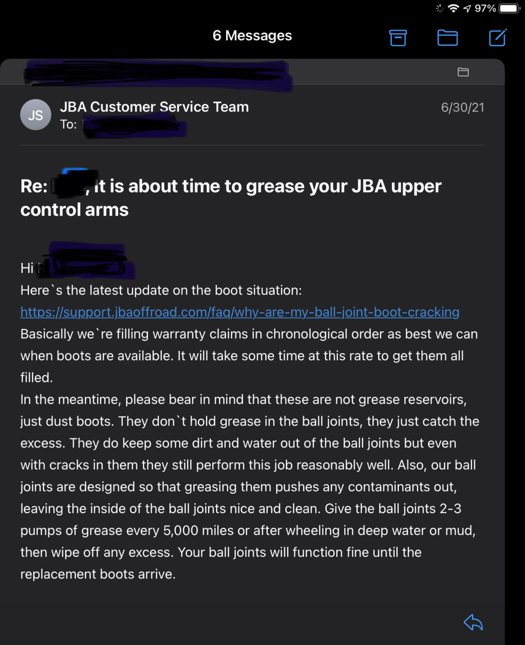

    I bought them the first or second week of this February, 2021. By the last week of February, they were cracking. JBA is shipping out brand new UCAs with these faulty boots already installed, unfortunately. JBA outright told me it was a manufacturing defect with the rubber boots, and they are working to get a new "clean screen poly boot" sent out to those with the failed or failing rubber boots. The new poly boots are delayed and we should have already received those already. We are still waiting... and the eta is always "a couple weeks out now" My patience is about to expire, but I'm not losing any grease, yet.

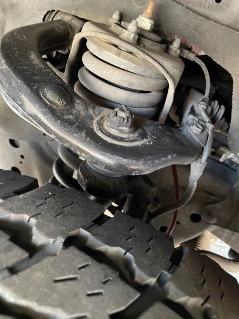

    So my upper ball joint bolt points up, will i have to replace the steering knuckle to? did anyone have this issue? hard to find any info about this online. Thanks in advance!

    What's the maintenance process for the JBAs?

    Right, but like is it a simple process? Every 3-4 months?

    JBA sends a maintenance reminder email every time they are due for grease.

    Pardon my absolute ignorance, but which parts will I need to grease?

    The bushings and the upper ball joint there is a zerk fitting for them

    Are you being serious? I never got any emails, lol.

    Yep so far I've been getting the maintenance emails regularly

    Must be a new thing. I bought mine mine 2 years ago.
