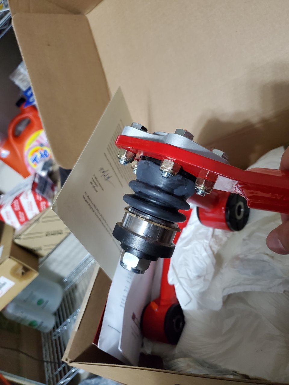

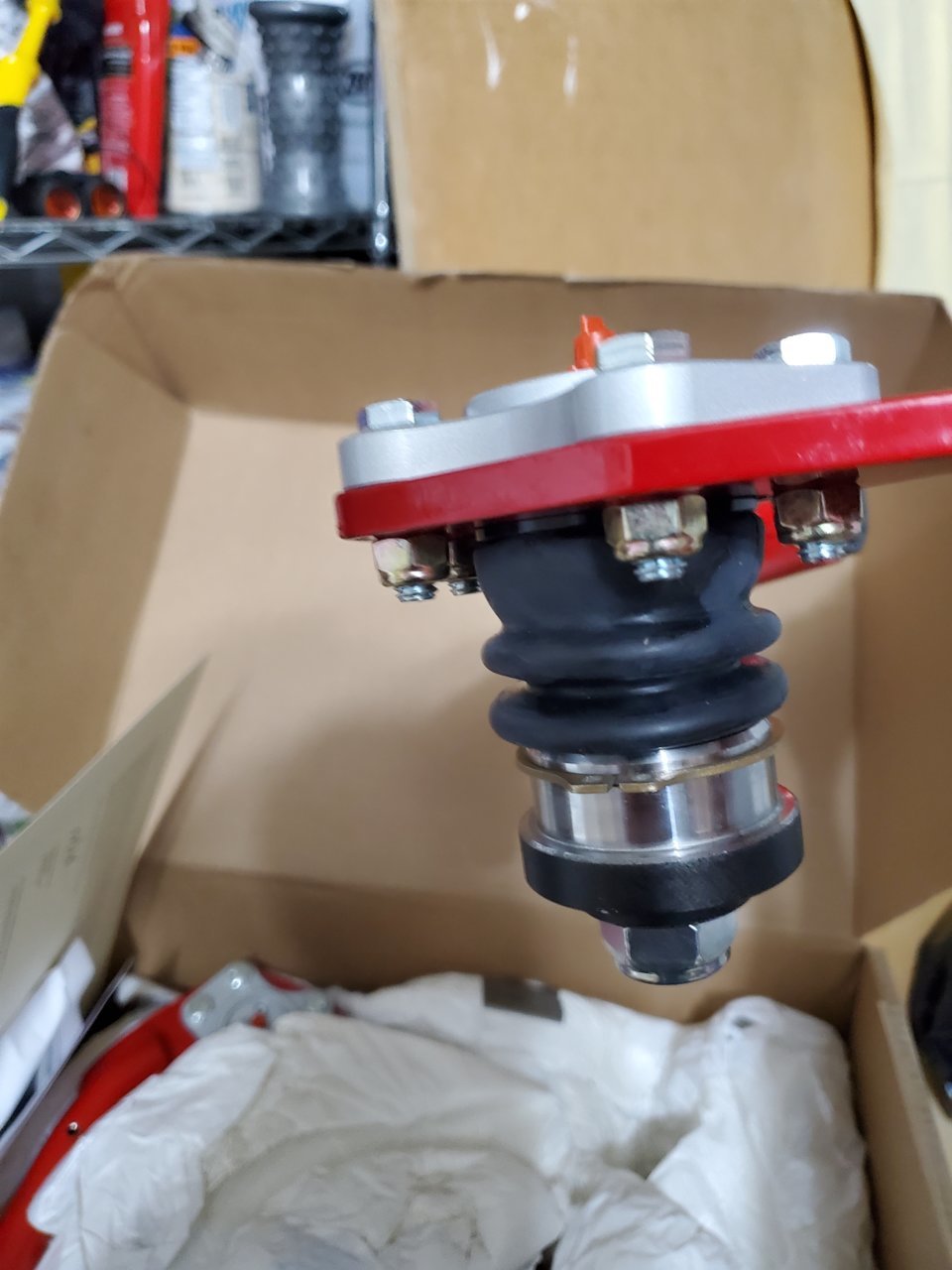

    This are the ones I just got at the end of Jan. The "updated ones" and now it seems this are bad ones now"manufacturer defect". And they're sending new ones?? To replace this ones?20210312_003059.jpg 20210312_003118.jpg

    Those appear to be the style we all have. Mine looked mint until they started cracking. I’m still not losing grease but I do want to replace them as soon as I can.
