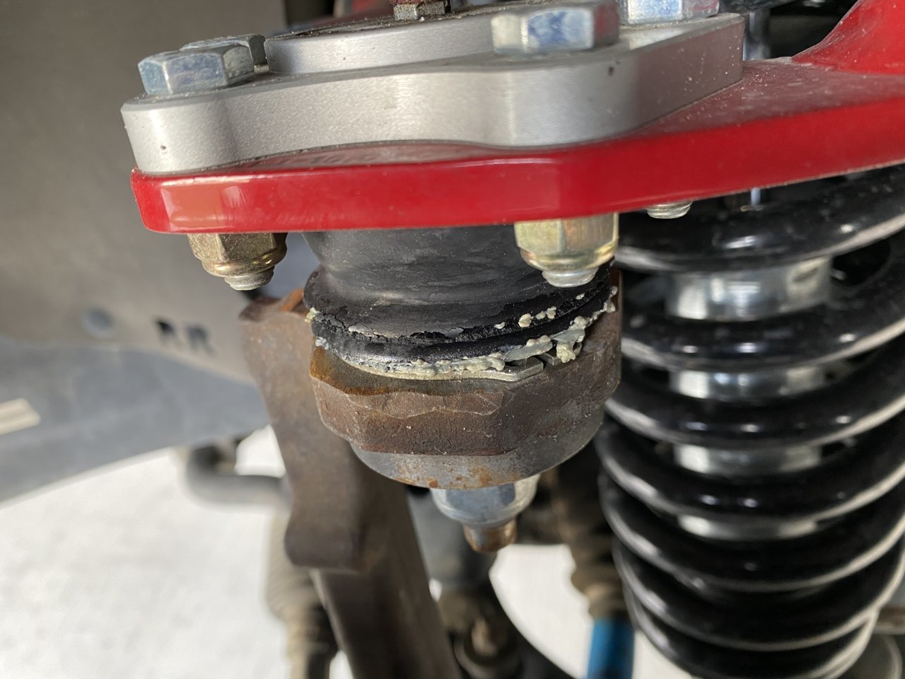

    Well my boots officially started dumping grease. Time to take them off and put the oem uppers back on. Going to return the JBAs I think!

    I’m curious if JBA gives you any pushback on the return process. I’m planning to keep mine but I’m also planning on eventually having jots that don’t crack.
    Your question below about removing the steering knuckle adapter, perhaps some heat on the outside of the knuckle in addition to the tool(s) of your choosing.

    I think I’m gonna just keep an eye on them and keep grease in them and hopefully the new boots come soon. If not I’ll get uniball upper control arms. No boots to rip! Lol

    I changed my oil yesterday and greased the UCAs. 3 pumps per side for the bushings in back and 1-2 for the ball joints. Pushing a tad bit of fresh grease in and ultimately out of these dogshit boots should help keep the ball joint itself happy until non dogshit boots arrive. Haha

    Just noticed mine starting to crack as well. Was curious to know any new updates also
    is it safe to drive it with it cracking?

    JBA says yes.

    yeah it’s fine to drive just make sure you keep grease in them in they start to leak. They said 2-3 weeks they will start shipping them out. I’m taking that with a grain of salt. They haven’t been on time with their eta’s so we’ll see.
