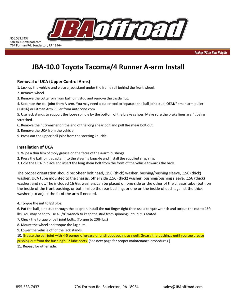

    what grease do they recommend?
  13. May 21, 2021 at 8:09 AM
    #113
    MalinoisDad
    MalinoisDad Misanthropic dog person
    Jul 16, 2017
    #224205
    1,480
    Michael
    01 TRD PreRunner 5VZ
    5100s w/ 881s, JBA UCAs, J59s, other stuff and things
    I asked them that same question when I first filed my warranty claim. Here’s their response:
    PS. The grease we recommend is XHP222 SPECIAL , it`s different than standard XHP222, it has molybdenum disulfide added, which our bushings really like.
  14. May 21, 2021 at 8:11 AM

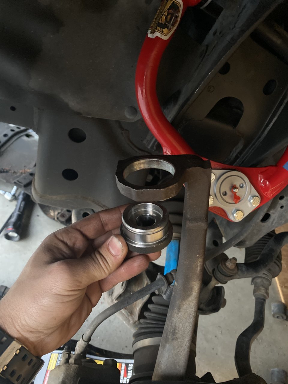

    This is what I had to deal with. It was a pain in the ass.
