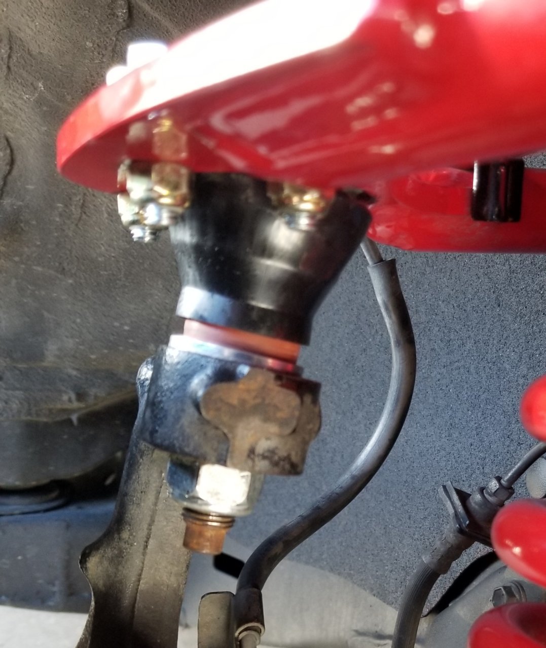

    @MalinoisDad so I think those 3 washers I put on was too much so when I went over a bump the ball joint was able to move due to the rubber washers even though I got the nut tight on the ball joint. I’m gonna take put the boot JBA sent me with 2 washers like you and see if that works.

    I got the 5/8” red hose washers and used 2 on each side. Might have been able to use 1 on each side but it worked pretty good.

    yeah. 2 on each side. Just slide it up as far as they will go.

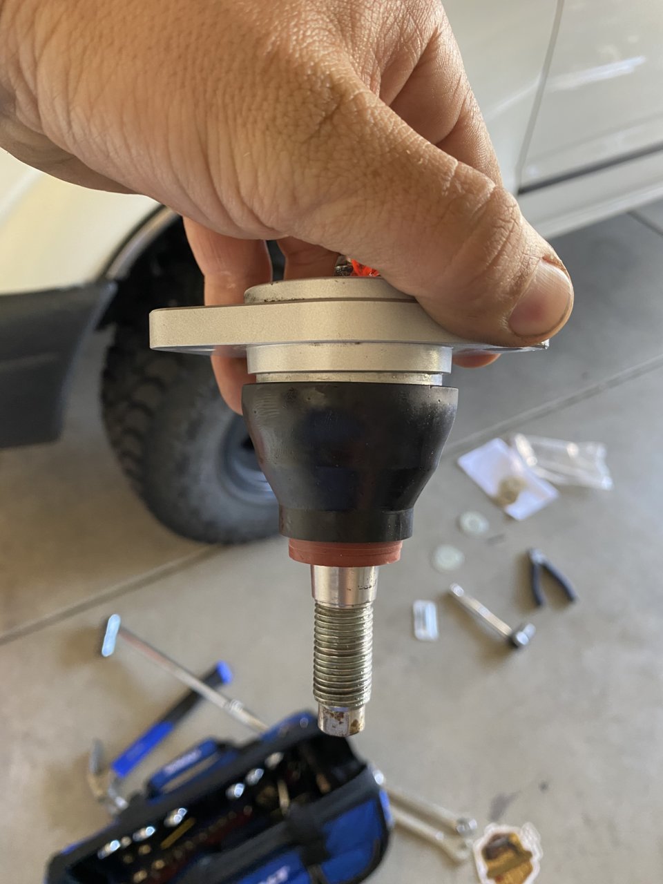

    Installed mine over the weekend. One had a tear/cut of about 1/8" long on the top and thought it was so it can fit onto the ball joint and didn't think of anything was wrong with it. I installed and moved on to the other side. That's when I noticed the second one didn't have a tear/cut on and proceed to install. I lowered the truck back on the ground I added grease and the one with the cut on spilled a lot of grease as the other only enough to know it was full. I went on to run some errands on several trips and was checking every time I got back home only to wipe off grease that came out from that side. The other side was fine. I hope the new boots come soon so I don't have to refill every time I go on a drive.

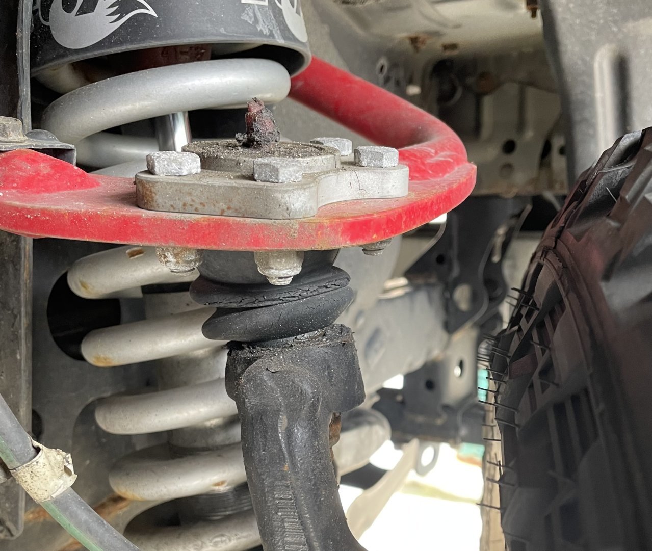

    Hey guys, mine looked like this. I sent JBA (1 year warranty) an email, an sent me this. I realize this is a 1st gen and I'm a 2nd but reach out and they will replace it.
    "The cracking is a manufacturing defect on some batches of the pleated rubber ball joint dust boots. We`ve dropped that manufacturer and invested heavily in an all-new pleated poly boot that we will send you free of charge. We`ll process a warranty claim for you and start a warranty replacement order to ship the new pleated poly boots to you as they become available."
