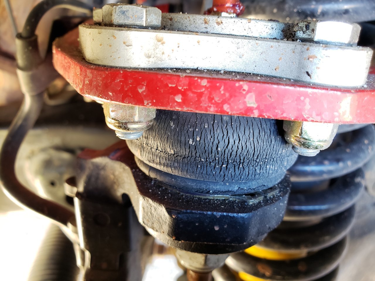

    Anyone else have this experience with JBA uppers? Haven’t had them on but a couple hundred miles and the boot is already cracking. Only on drivers side. Haven’t even taken the truck off road since I installed them so no major flexing. What should I do?

    Email JBA.
    This is common with them.

    It’s a known issue. Last I heard from JBA they were going to have new pleated poly boots coming mid to late February. I’m going to follow up first of March.

    Contacted them about the boots failing on mine 1st of February. They sent me a replacement set for now. Put me on the list for the new updated boots. Said production should start by the end of February.

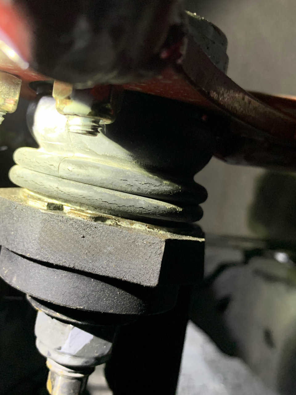

    20210222_155332.jpgLooks like I'll be getting replacements also.

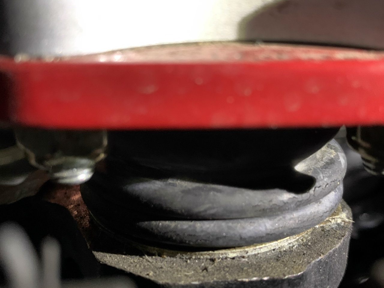

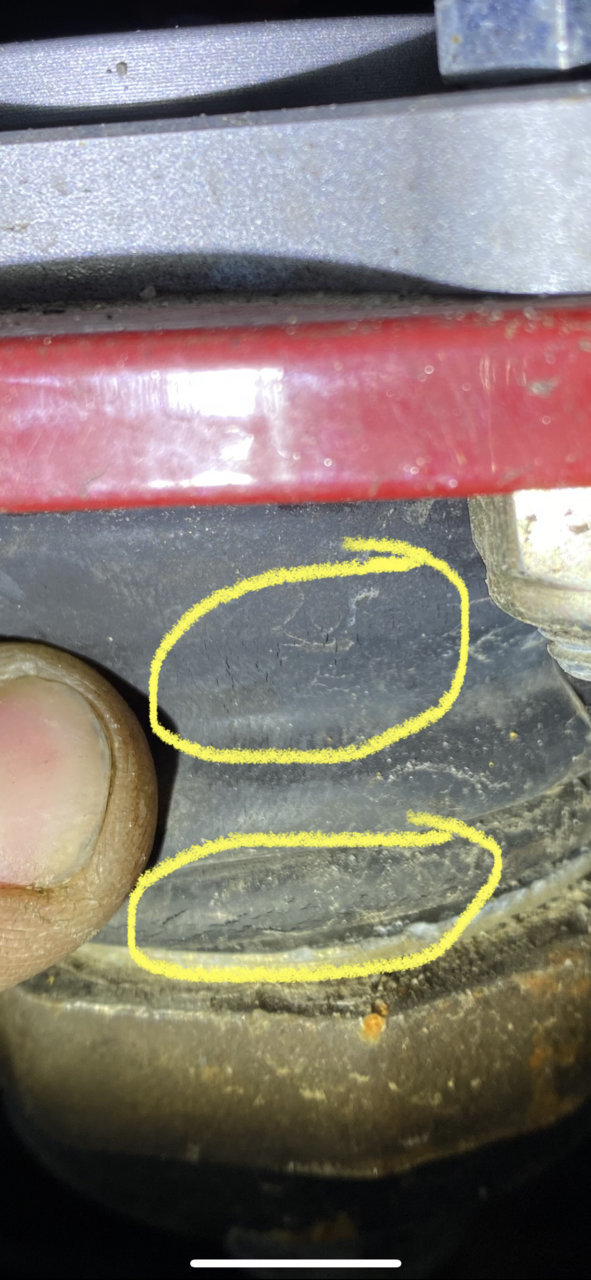

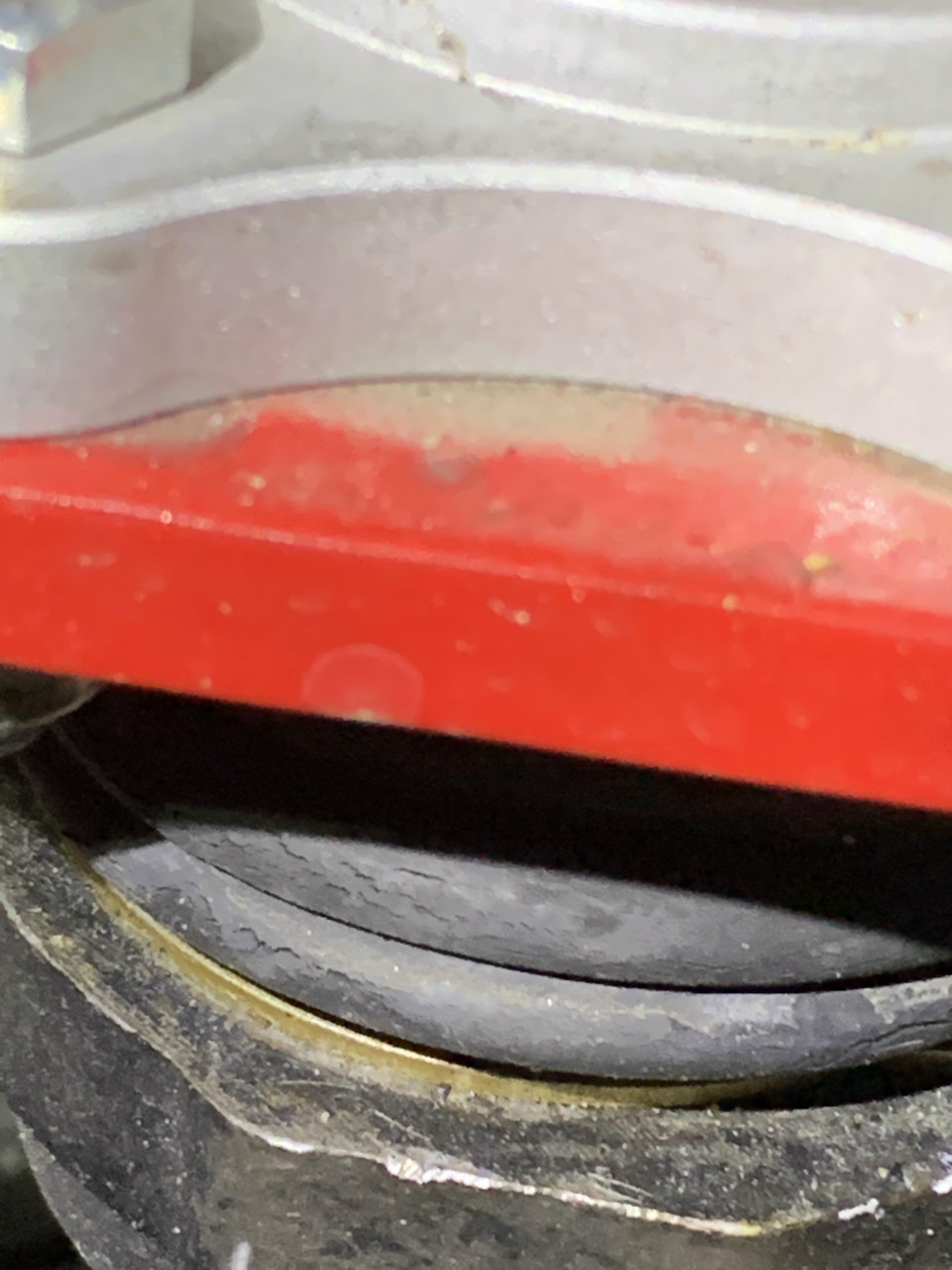

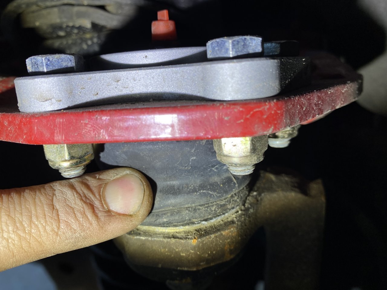

    Folks, I'm glad I stumbled on this thread a few days ago. Tonight on my way home from work, parked in the grocery store parking lot, I decided to give my boots a quick check. The entire brand new arms were installed just a couple weeks ago, on 2/9, so all brand new essentially; maybe 300-400 easy street miles on the whole thing. And shit the bed, mine are cracking, both sides. I emailed JBA just a bit ago. Very detailed, pics included. I'm a happy customer, albeit bummed I got deal with this now, but certainly not pissed or anything. I'm sure they'll make it right as they have with the rest of you.
    I admit, although I recently (and successfully) tackled my Deaver leaf spring install by myself, I had these JBAs installed by a shop along with new tires, extended brake lines, alignment, etc. I just wanted to have a shop do it. This time I'd like to replace these boots myself. I have a torque wrench that will hit the required spec and jack stands, etc. There's no way an alignment is needed after replacing these, right? What exactly needs to be disconnected in order to replace these boot? Just the upper four nuts, and separate the upper arm from the steering knuckle, correct? When the JBA ball joint adapter was pressed into the factory steering knuckle and secured with the C-clip, that's in and done, correct? I hope my question makes sense. Dinner is in the oven and I've had a few beverages. Pics to follow:
    *I have gingerly hit the ball joints the Lucas red-n-tacky juuuust until I started to see the boot swell a tad. That was a day after install, and I periodically checked the boots in the following few days to make sure I didn't overdue it and cause a rupture. I didn't. Bushings are happy.
    TL;DR what the heck am I in for?

    Replacement of these boots should be very simple. Has anyone heard from JBA a more precise ETA on when the new poly boots may ship out to those of us waiting for them?

    your snap ring doesn’t look closed all the way. The gap shouldn’t be that big.
