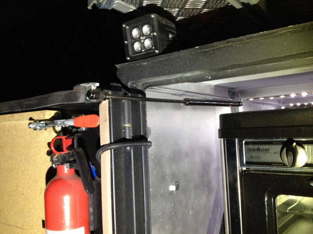

    Sooooo some trailer updates.
    I put the bottom leaf back in the leaf packs. The added weight of the new XL tent seemed to dictate it.
    Also added a shock to the rear door. If the trailer wasn't level the door wanted to over or under swing. I set it up so the shock stops the door right at 180 degrees.

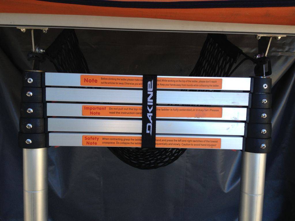

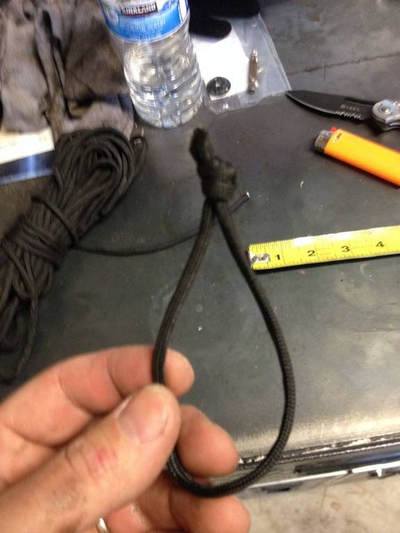

    Used an old Dakine snowboard leash to keep the top rungs of the ladder together. I found that the telescoping ladder wants to open up all the way when opening the tent and always have move the upper steps up. Part of this is due to the fact my tent is on a trailer and lower to the ground than most. Easy, free, and works perfectly.

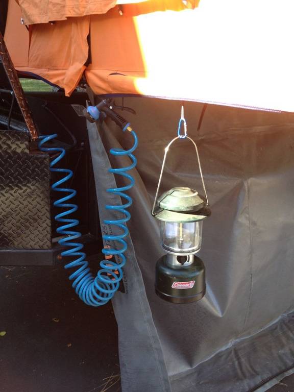

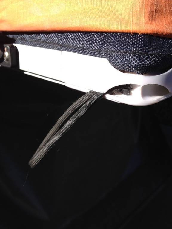

    Lastly made some little hoops to hang shit off the anex channels. Nothing special, just some 550 cord tied into a knot. The knot fit perfectly inside the channels.

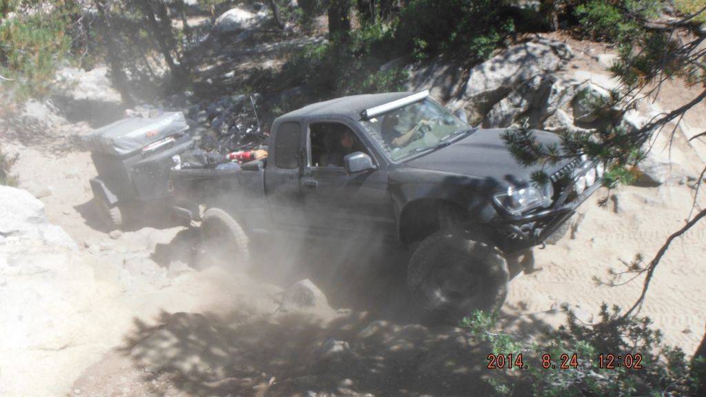

    Oh yeah, couple randoms as well from Slick Rock.

    Those loops are a great idea.

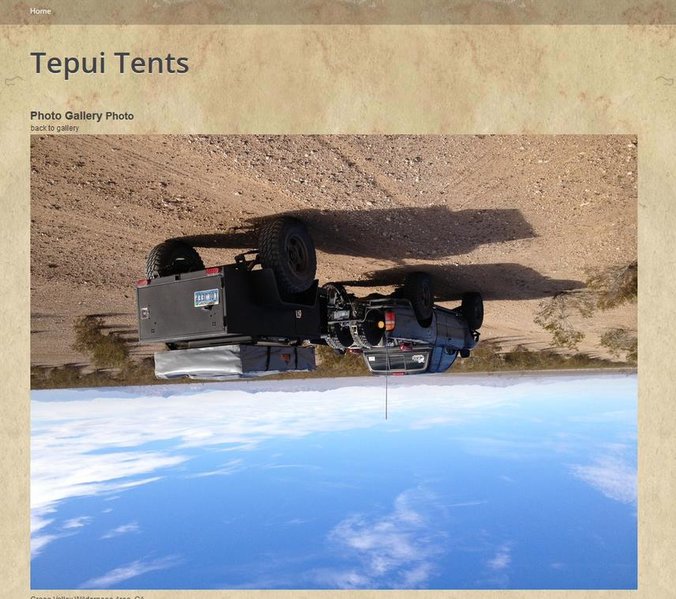

    Seems like Tepui thought I was in Australia :laugh:

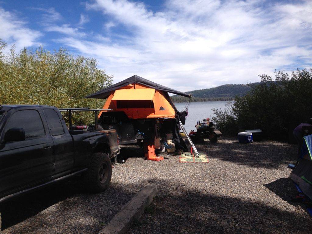

    Oh yeah...forgot to post these
