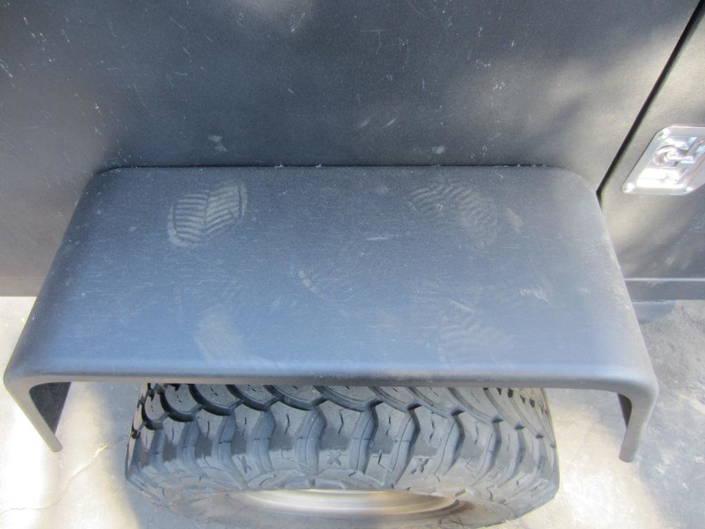

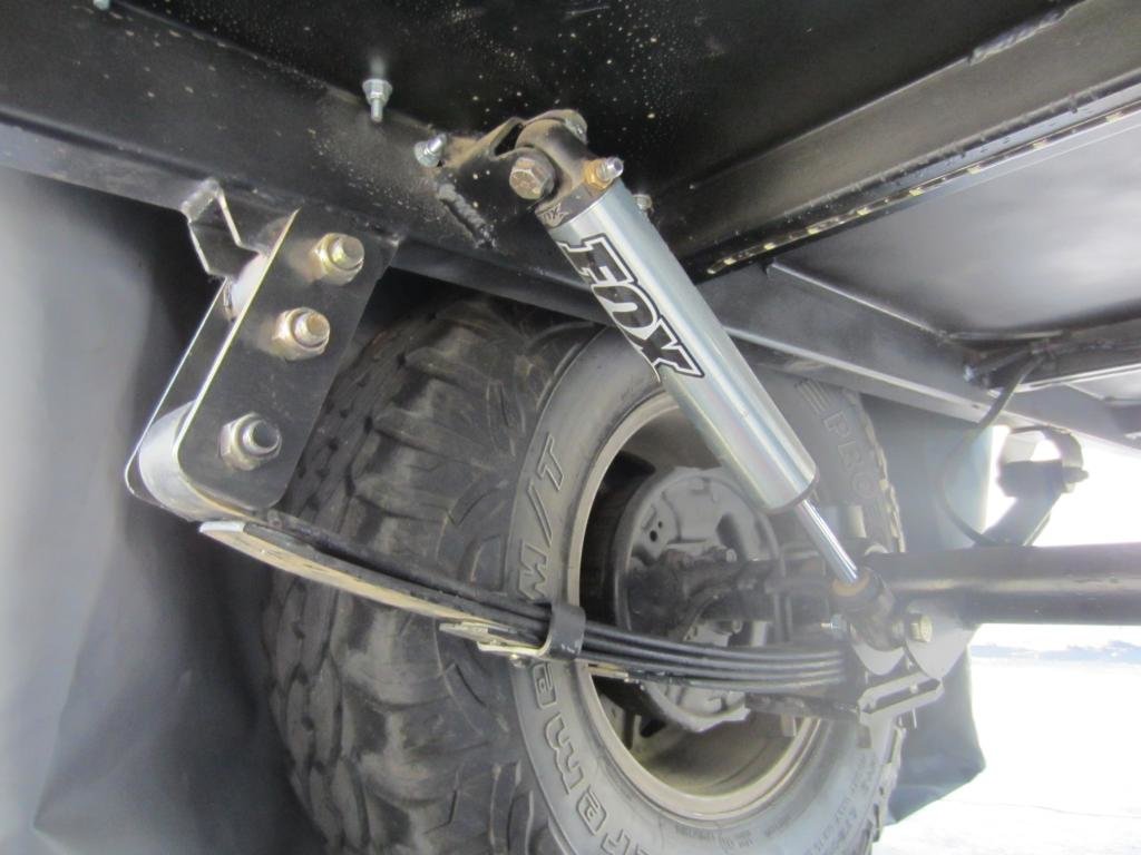

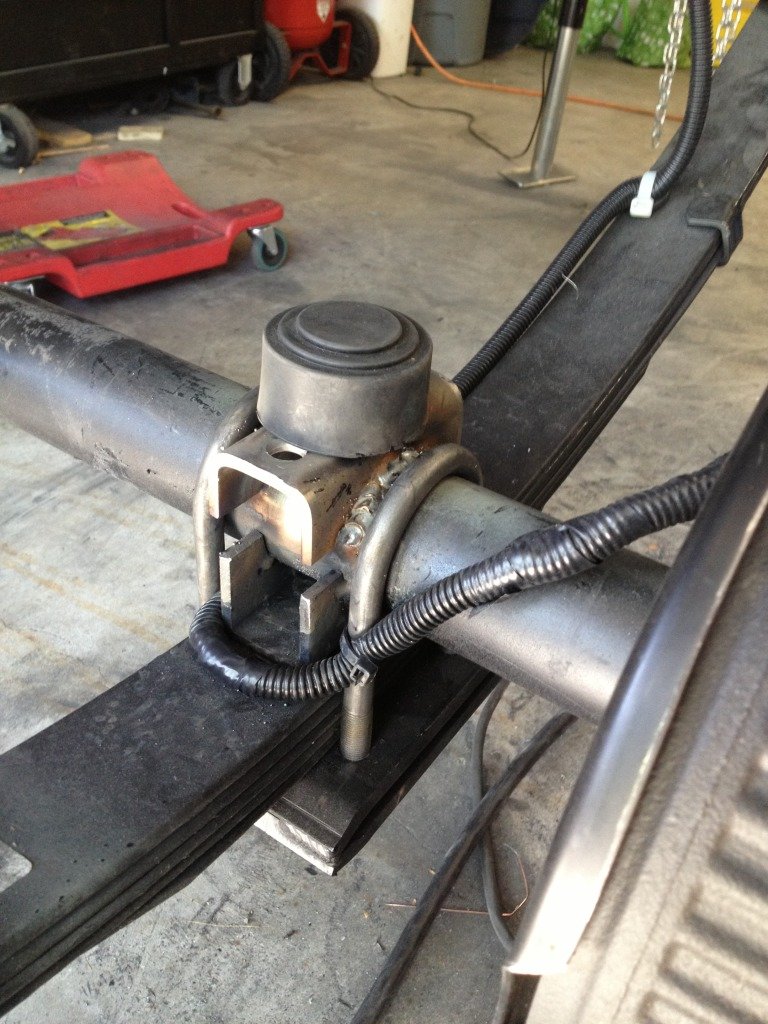

    Your axle and spring set installed, working on fenders tonight.

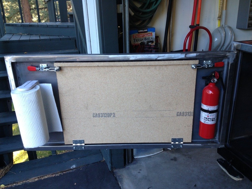

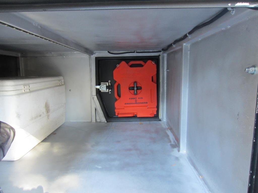

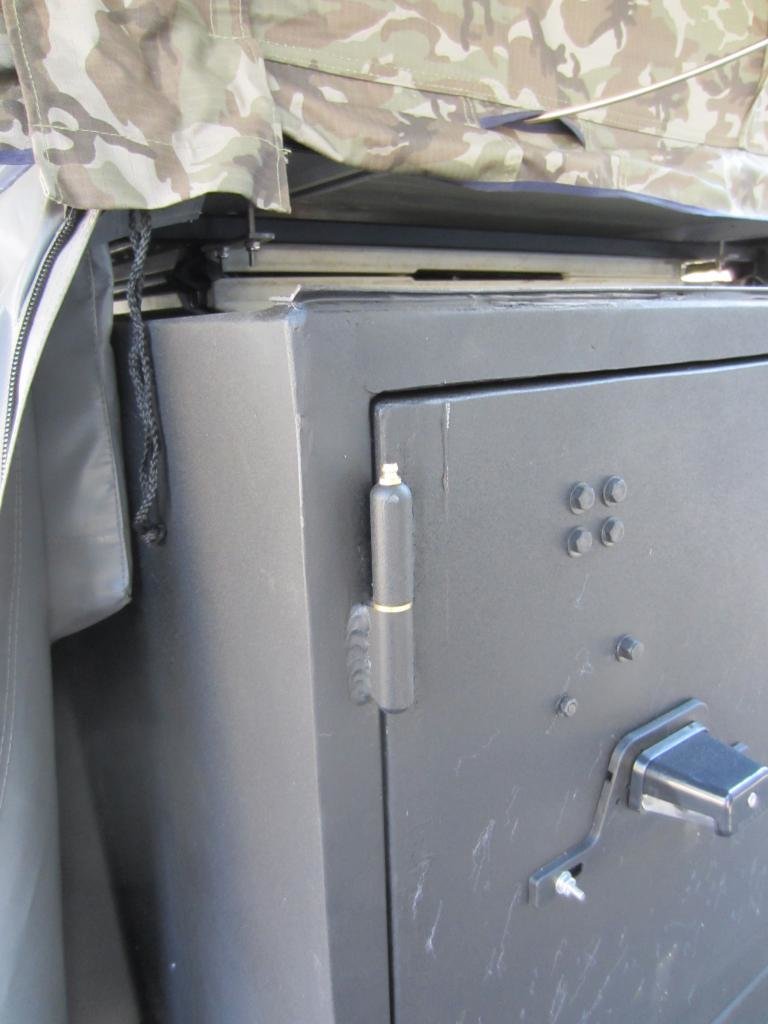

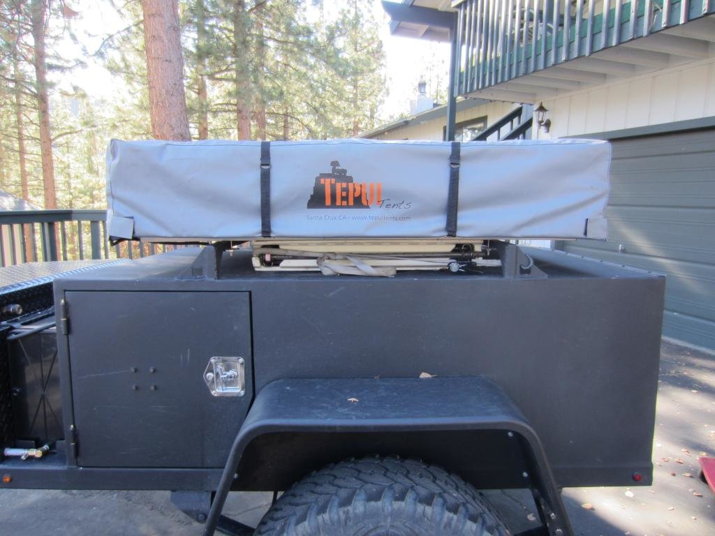

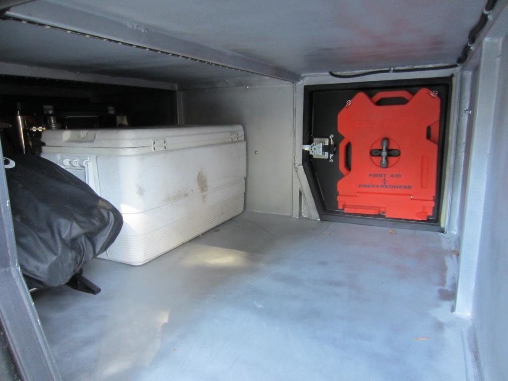

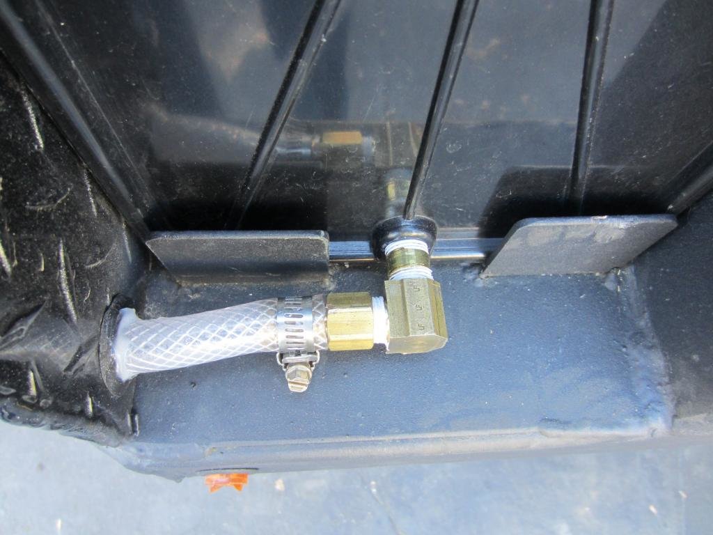

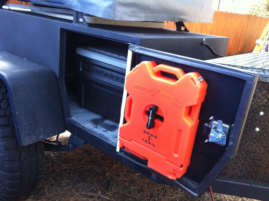

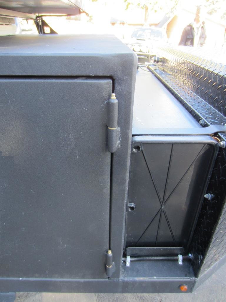

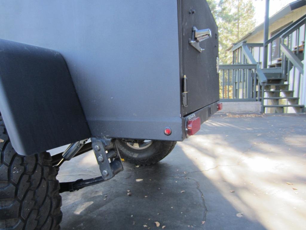

    Hey Jason, how did you go about making your doors more water tight so you didn't get water inside if you went through any crossings or anything like that?

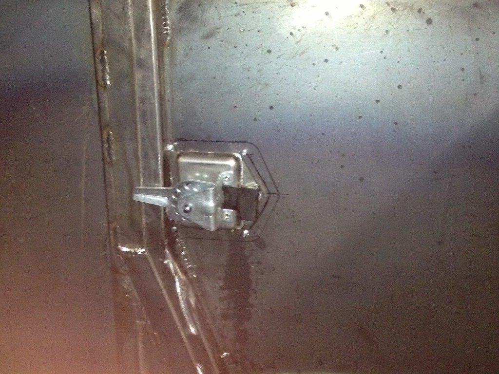

    I welded a piece of flat stock inside the door frames on the box and foam weather stripping on the door itself. The flat stock acts as a stopper for the door, but also sandwiches the weather stripping.
    278DA69A-DBB7-40EB-97B9-23B518F3346E_zps_4e1c302517c4cc07c9df8543712462350bbda9fc.jpg

    Genius! I love this idea! Thanks man!

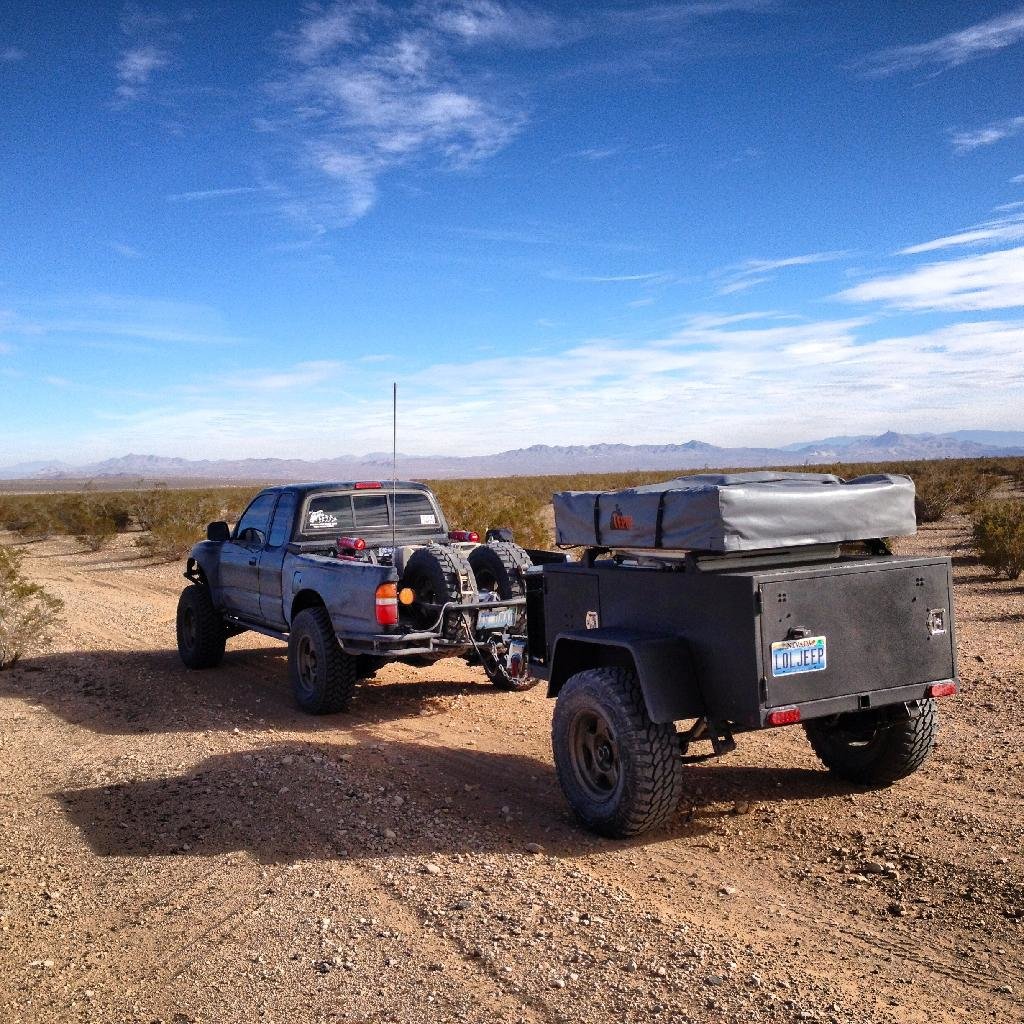

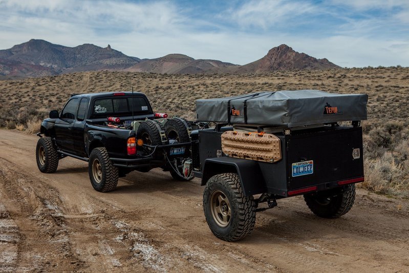

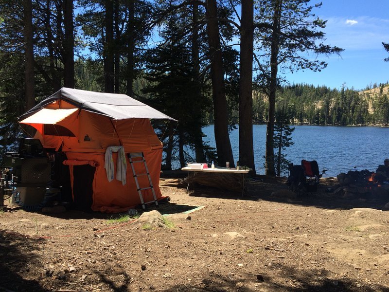

    Weekend did not suck

    I miss camping out there!

    Needs more kayaks!:D
    Looks like a great spot to escape to! :thumbsup:
