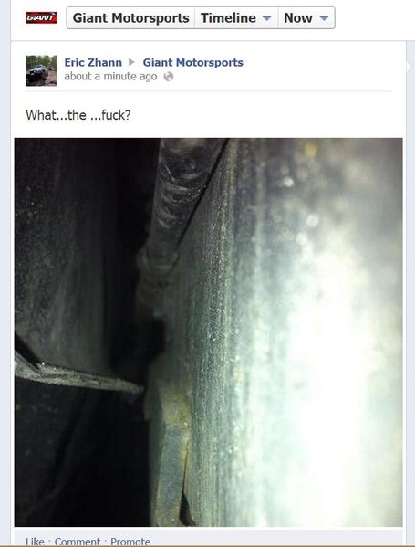

    eric you should explain more about the pic in the post haha

    LOL! Talk about literal.
    Maybe a caption like "Geoff...did you forget to weld something?"

    Was able to unbolt the tank and drop it at inch and slide it over about two inches, enough to get the gun in there.
    It's not my prettiest work, but better than not welded.

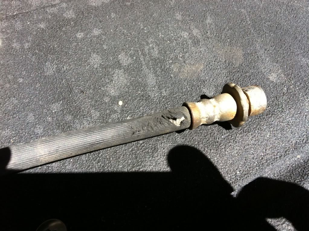

    Wait! You guys can really have fun with this. Some of my "Giant" findings
    Giant Limit strap:
    Yes...that's the rear brake line. No straps at all...just the brake line..and yes it was the droop limit

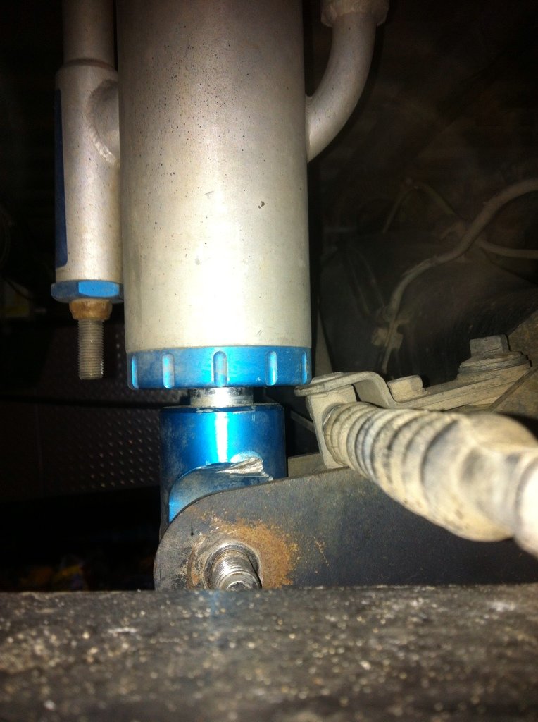

    I keep hearing a weird clunk sound at full bump, so at first I think it's just the bottom out. Then i notice the passenger shock cap is getting beat to shit. Break down the leaf pack and cycle...and here's why. Giant E-brake cable bump stop
