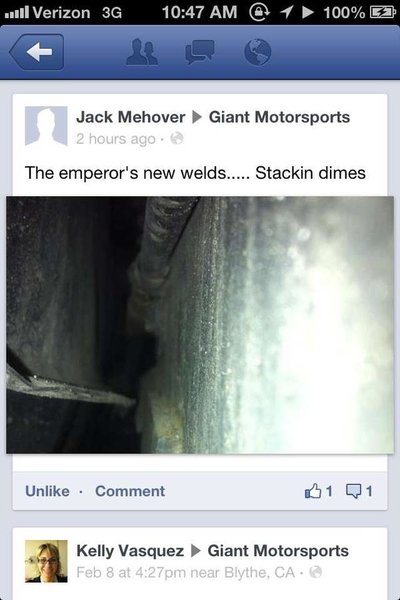

    i would imagine that geoff wasnt behind this build. I would assume that one of his helpers built your truck. Now obviously geoff should have double checked everything before it left the shop. Missing a weld happens, but all the rest of it is completely unacceptable. Imho Geoff builds the best beam kits available so this just doesnt seem like something he would do. shhh dont tell anyone but my hanger on the gas tank side(passenger) isnt fully welded either due to the fact that the bolts to the tank were so rusted they would have snapped. Once i get a fuel cell that will be fixed though. seemed to hold up just fine through all the abuse ive given her hahaha....and you were in the truck for this one VVVV

    Whatever Geoff or his minions didn't do anything but slap the damn suspension on the truck. Nobody cycled anything.

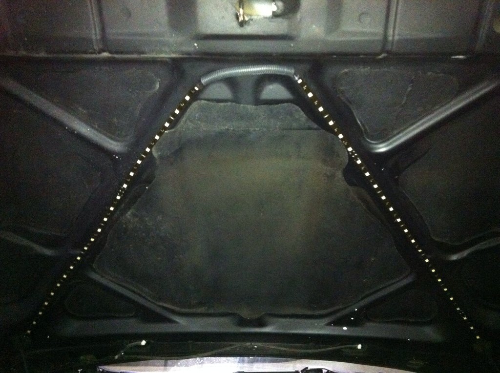

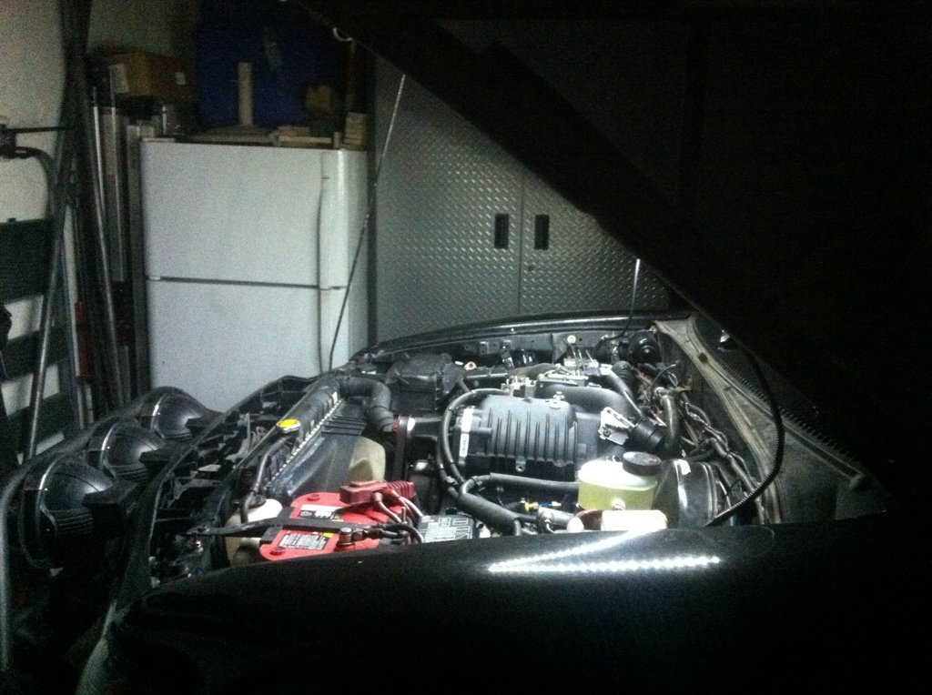

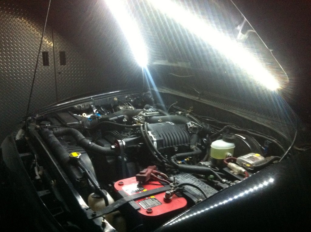

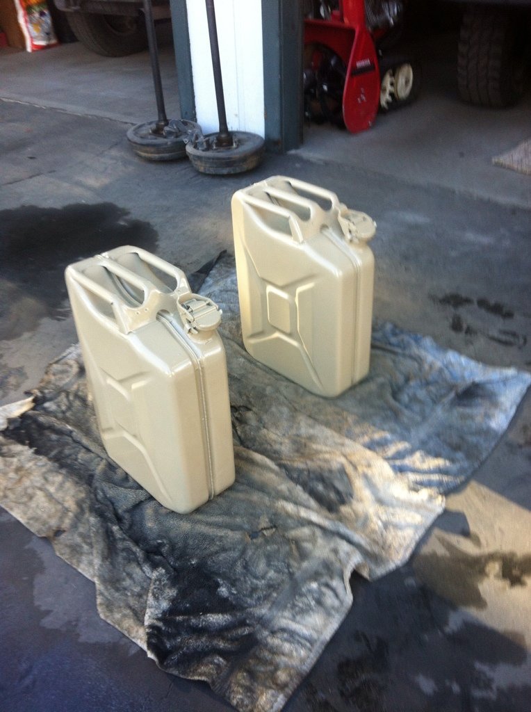

    I never liked the green on my gas cans. So I rattle canned then tan.
    And also did some more LED work under the hood.

    Piece of cake to wire. If you look in front of the battery you can see the hood pin for my alarm. I used that as the negative trigger for the lights as well. As soon as you pop the hood, lights come on.
    Power came from my Blue Sea fuse box.

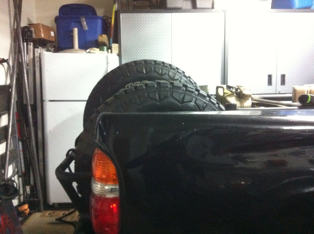

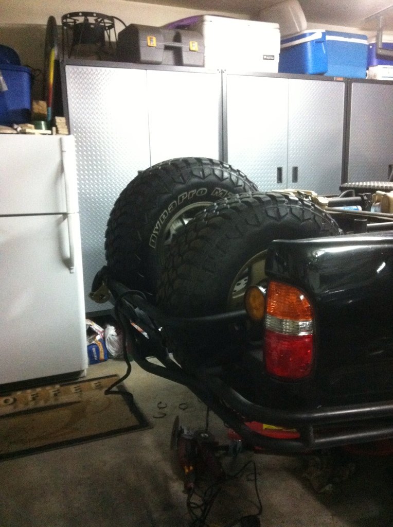

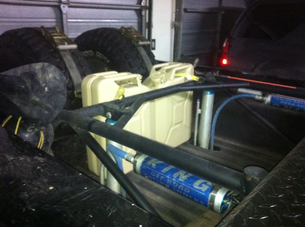

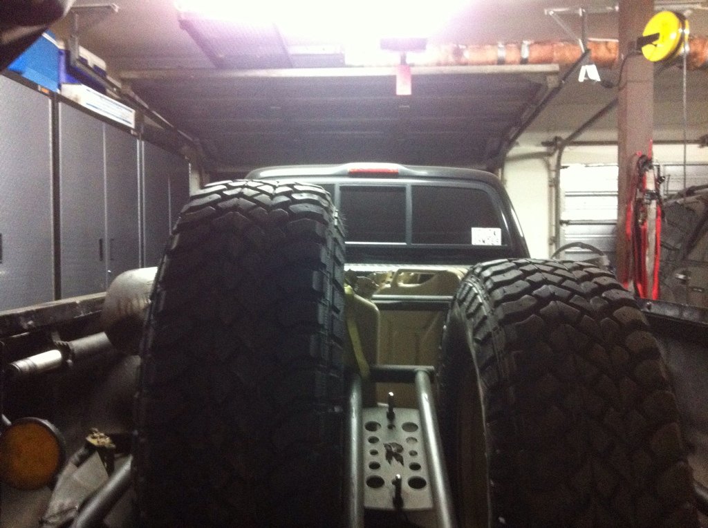

    I hate being anal retentive sometimes. If it's not perfect, I have to redo it.
    The spares are just sitting too high. With the new leaf pack and the spares as high as they are, the COG is tall and the ass gets too squirrelly when the suspension unloads. That and my view out the rearview kinda blows. So.....I'm gonna rework the tire cage. Seems like the only way I learn is to do something wrong and then to do it again right.
