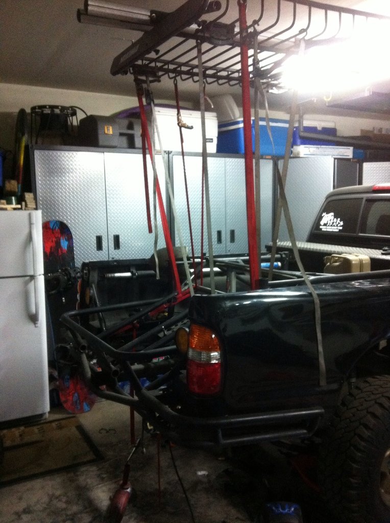

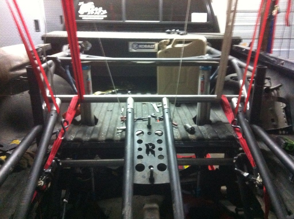

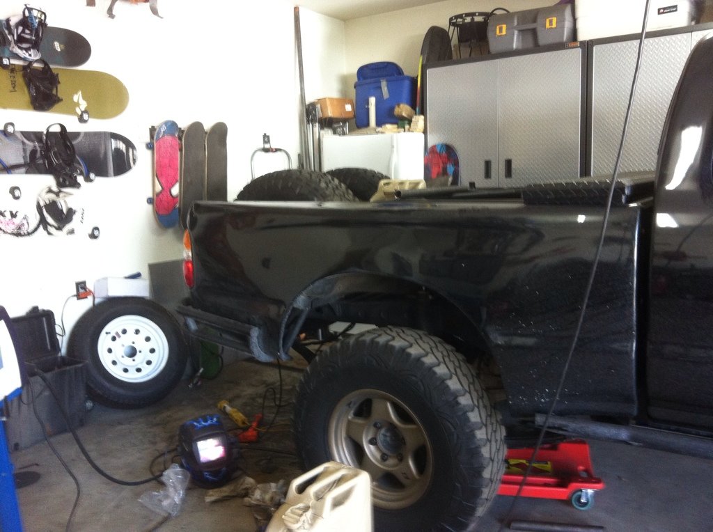

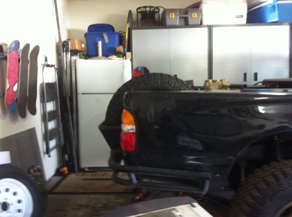

    I'm either a genius or a retard. Either way....I don't really care cause it worked perfectly! I had to pull the tubes up just a little bit to get everything to line up where i needed it.
    23244B8C-2112-4E61-B589-AC3EB152AC67-610_d3d9aff5e09e9f2d5a02f3b9213fed50673f499c.jpg
    180524F6-29F9-4F71-93DE-F531A96B5F6B-610_f61865bcf0fe08109434b2baedb5f8dbf95baa59.jpg
    I got everything tacked in and about half the seams burned in before my welds went to complete shit. Took me 4 welds before I realized I ran out of gas....oh well. Thankfully they were all on the bottom.
    I'm very pleased with how the spares sit now. Still have at least another day or two's worth of work to finish it all up, but need more welding gas first.

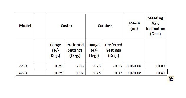

    Do you have the SAI and Included Angle specs for a 1st gen Tundra?
    Kolt had his truck aligned today and I noticed he's got a 5* difference between sides. I'm pretty sure he's got a bent knuckle or LCA.
    Camber, Toe, and Caster looked good though.

    Yep. Attached below.

    I see adjustment but no specs?

    Woopsi. Sorry.

    Heh, he's got like 10.9 and 5.7. At least now we know which side is bent! Thanks Jason!
