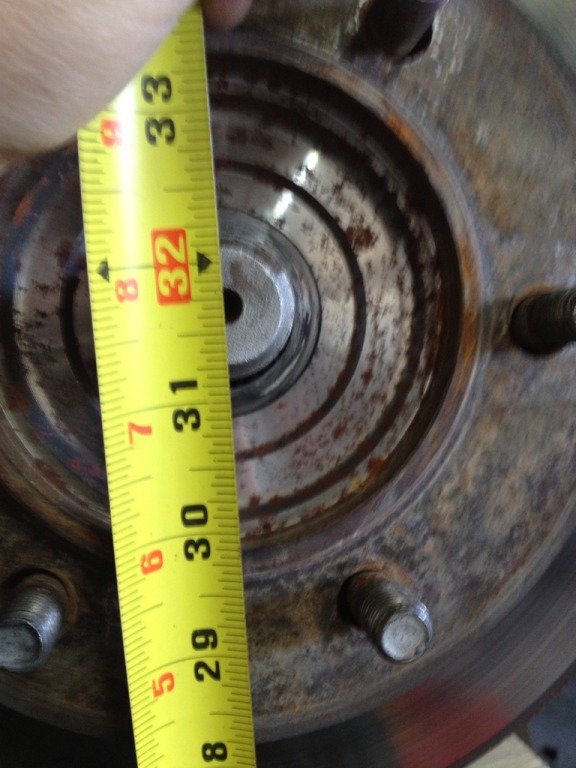

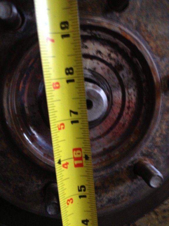

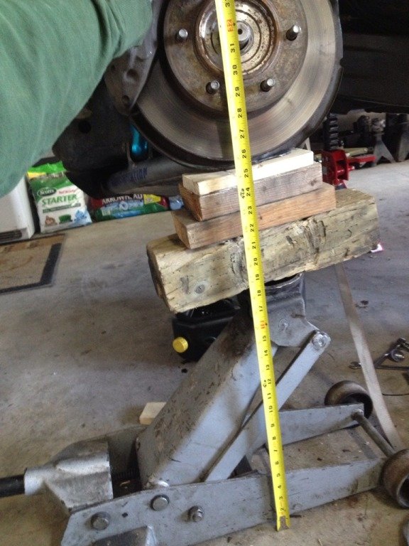

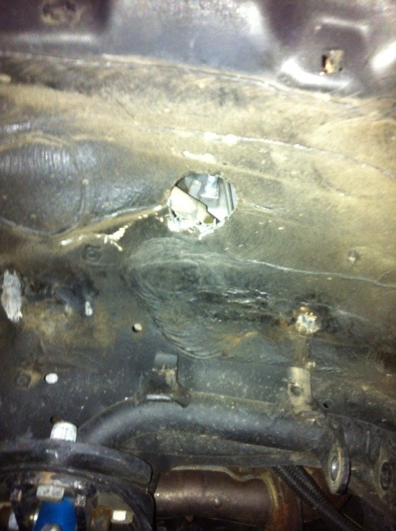

    Again, more prep for Moab. Re-working shit up front.
    TC completely under rated wheel travel. I drilled out a hole in my core support for the UCA uniball bolt. Shock is the limiting factor both up and down. 13" of wheel travel my ass. You can do the math yourself. TC FTW :cool:
    628869F2-A57B-49A4-9AC0-8639395614C5-458_80b264de779b5929f57d4b29882e5f4b1f4329d2.jpg
    Bump
    367B6B01-B493-492B-94BC-AD47EEA50644-458_7bc6721bd2645cb1afa413551d8df5be71f14753.jpg
    Not a funny tape measure
    DCAA8C5C-F526-424C-B3EC-BEABB06127DA-458_f5f9c16d31e59d230e5eeea2490f25f63ad33f80.jpg
    Droop
    E990CFAC-D068-4AA1-81A7-224AEA05E106-458_a15dccb7cf23785ea16ea71eac1b681fe1ba8b63.jpg
    70990BE2-5494-4F47-8E97-C7CE8CF61613-458_7d1fc38b16d300d9632981ac5e819c82beb077f0.jpg

    swapped around some of your pics...but i think we get the idea...

    I said that the shock is the limiting factor up and down. Meaning I cycled the suspension with the shock in there.

    I don't really have a problem.
    I"m less than a mm from misalignment metal to metal both bump and droop. The hole in the core support (and shortening my bumps a little bit) is all I needed to get the extra inch of uptravel I was looking for.
    But if you're limited up by 2" and have that much droop, it sounds like you have the wrong shocks. The Burg kit doesn't use a standard 8" stroke shock. It's a special order where the collapsed length is supposed to be 14.3" instead of 16"
    Shock is perfect. While it's the limiter, a bigger shock isn't going to let me get any more travel out of the front, even with an engine cage. Misalignment spacers are just barely shy of metal to metal.
