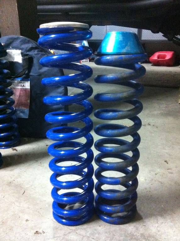

    If only. So pulling everything apart today made me realize how little I knew when I installed the kit and the bypasses and how important cycling and measuring is. Something just looked...off. Pulled out the tape measure and the bypass shaft was only measuring 7 5/8" instead of 8". And I originally set droop to match the coilover.
    Meaning...my bypasses are bumping before my coilovers do. I pulled the bypasses apart and inside I found they had a 5/8" shaft spacer. Called up King and explained my predicament. They looked the specs on my kit and quickly told me that it looks like they built the bypasses with the wrong size spacer. It should have been a 1/4" spacer (making up for the 3/8" I was missing). Two new spacers in the mail, free of charge, and an an apology.
    That said, it means I have to cut off the bypass tabs and weld new ones on about a half inch higher.
    TC or Burg...can't go wrong.
    I'll admit it though, I did pull the "mine is better than yours" with JD on the travel numbers. :D
    Oh and....oops. This explains why the coilover was such a pain in the ass to get out of the coil bucket :eek:

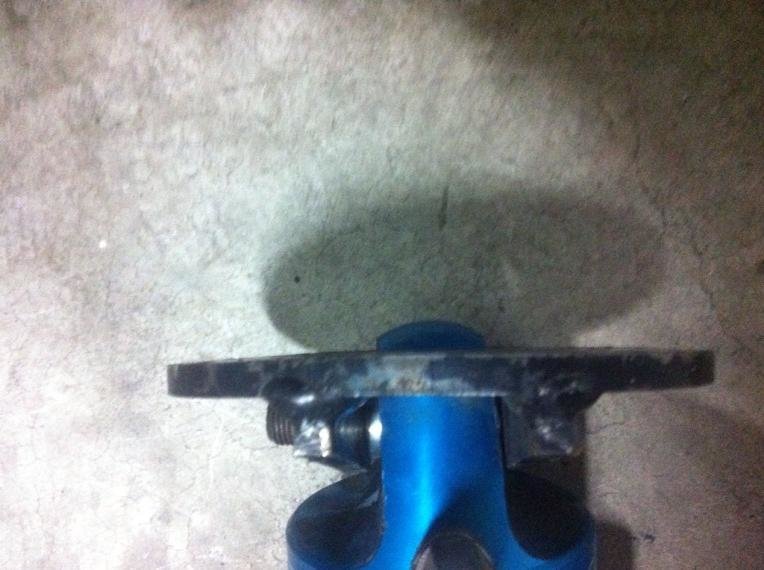

    That's nothing. Ill get a pick once I get my truck back, my
    Top plates look like tacos. Something is deffiately off on my front end. And I have the right shock, dsm took like 4 weeks to have it built by king.

    If your top plates are bent then your coilbuckets must be bad too. Time to cut them out and to a shock hoop.

    Yes the top of my coil bucket is terribly bent. I think the problem is that I had engage top plates and they were too long and the shock is bottoming out before bump. Can I just build a shock hoop for the 8" co with out havein to do an entire engine cage?

    Oh lol. Thats really bad on the arm too. Will lead to cracks ask me how i know. :p
    And Yes you can I have seen it done before. All you need is a simple shock hoop from the frame and if best a simple bar going across the motor to support the shock mounts lateral support.

    18" coils with flat bottom plates vs 16" coils with tapered.
    That's why I said good think I had the gussets. If I didn't, everything would be bent to shit.
    And my shocks took more than 4 weeks to build from King. Hell my bypasses took a month longer than my coilovers, and they were built wrong. My point is, have you measured extended/collapsed length?
    Get rid of the Engage top plates. Build your own, get the burg ones, or hack everything out and do a custom hoop. The Engage ones are stupid long.

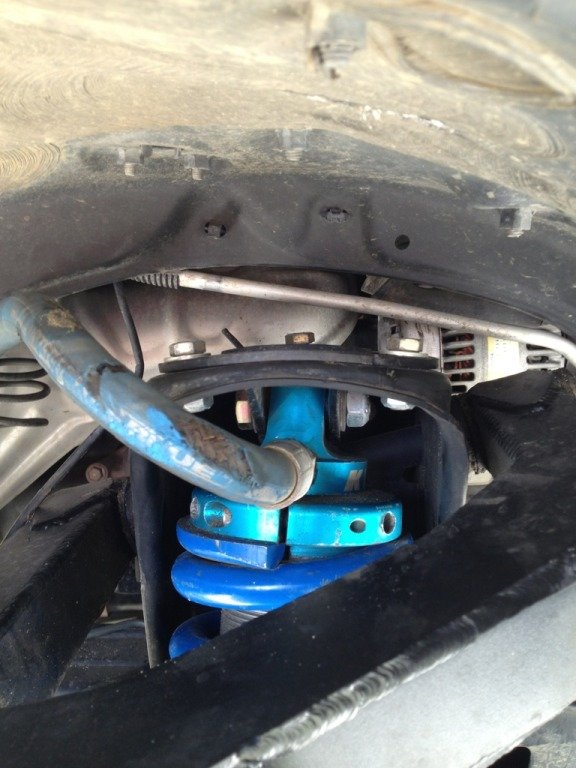

    are we playing the bent coil bucket game? :anonymous:

    Valid point you have there. I haven't measured. Just trusted what they said :rolleyes: I know I need to ditch the engage ones but the coil bucket is so bent I doubt I can put in a new non bent top plate, because nothing would line up.

    Jesus Brian. Get gusseting.

    itll all come with the engine cage. dont worry :thumbsup:

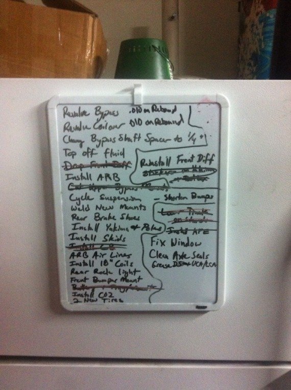

    That fixes itself :D
    I still need to do a full cycle with tires lock to lock.
    Short list for Moab:
