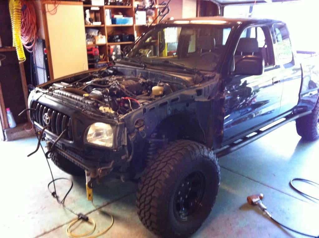

    Got off work a little early today so decided to get this thing started. Cleaned out the garage a bit and parked the Tacoma where's its going to remain the next couple weeks.
    Removed the skids, front bumper, fenders, hood, driveshafts, shifters, battery, starter, drained the transmission and transfer case fluids, and pulled the engine harness out from the cab.

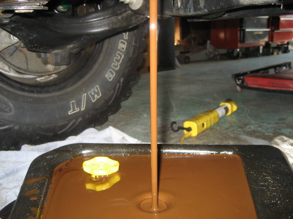

    Apparently there is a volumetric limit to the amount of water a Tacoma can consume before it completley goes to shit. My truck met that limit and the supercharger proceeded to force more water into the belly of the beast. End result is what is commonly reffered to as hydrolocking.
    What pray tell does that mean for the motor? Well you can google yourself what hydrolocking means, but in the end I broke one of the connecting rods...and then made baby pieces of connecting rod in the oil pan and poked a hole out the side of the block. Despite the violent action, the truck still runs. It's running on 5 cylinders, but I drove it right up into the garage (leaking oil the whole way).

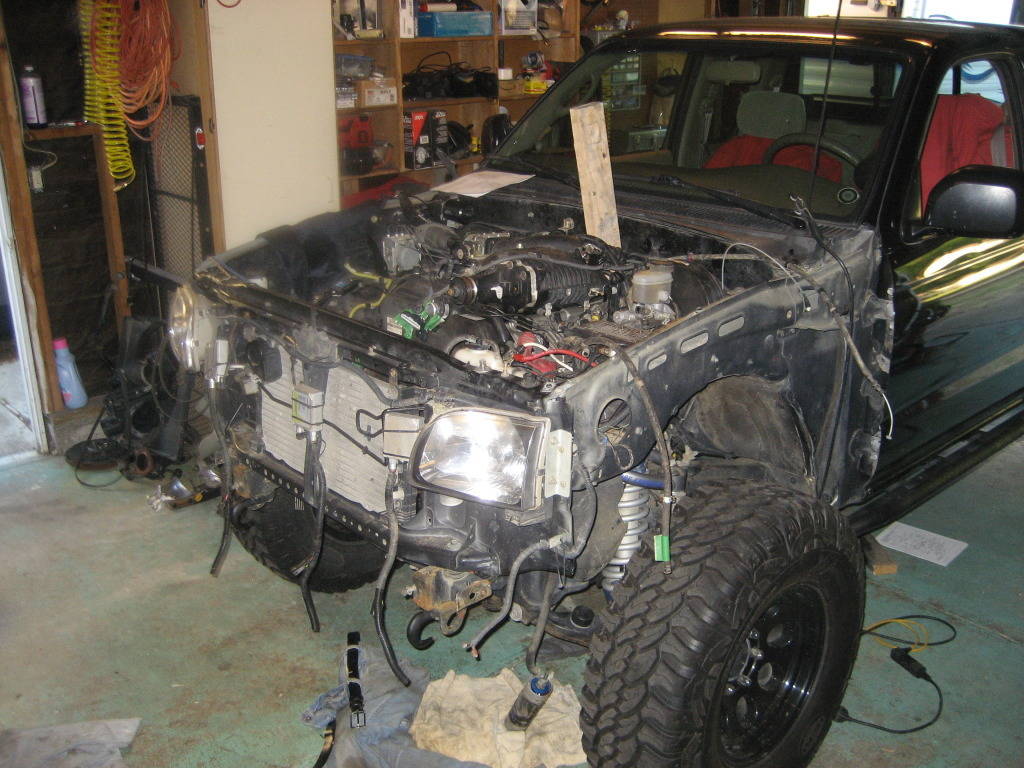

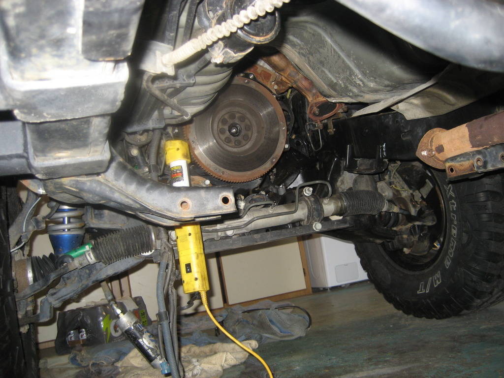

    I cannot just let things sit. It's all about do it and do it now!

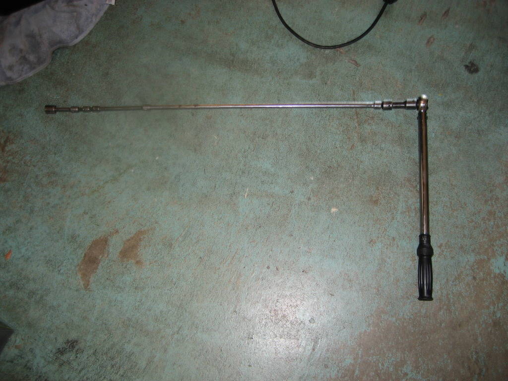

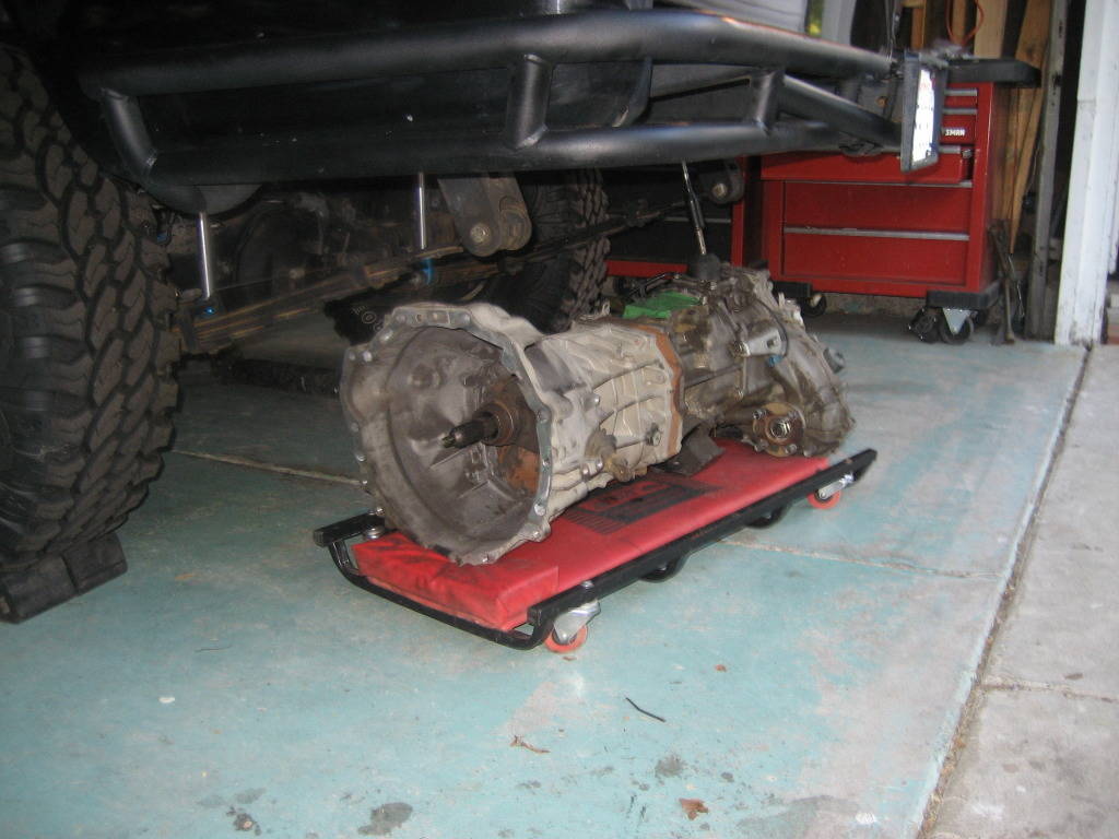

    Litterally everything is off the now. Grill, radiator and hoses, A/C compresser, power steering pump, cat, transfer case, transmission, clutch, intake, and every fucking wire, vacuum line, fuel line and hose is labeled and disconnected. The only thing holding it in the engine bay are the 4 bolts on the motor mounts and a 2x4.
    The wife had to help with the jacks to pull the transmission off while I manhandled it, but other than that a completely solo operation. Spent about 6 hours total today.
    And if anyone is planning on removing their transmission, I hope you have a wealth of extensions. I needed this magic combination of tools to get to the very top bolt on the bellhousing.
    By far that top bolt was really the only PITA part about this (and actually dropping the transmission/transfer case). I love my wife, but she doesn't take directions very well when it comes to mechanical things. "Pull the jack" does not mean lower it while I'm under it. :eek:
    Who's up for some chocolate milk? Well over 7 quarts of "fluid" drained out of the oil pan. :facepalm:

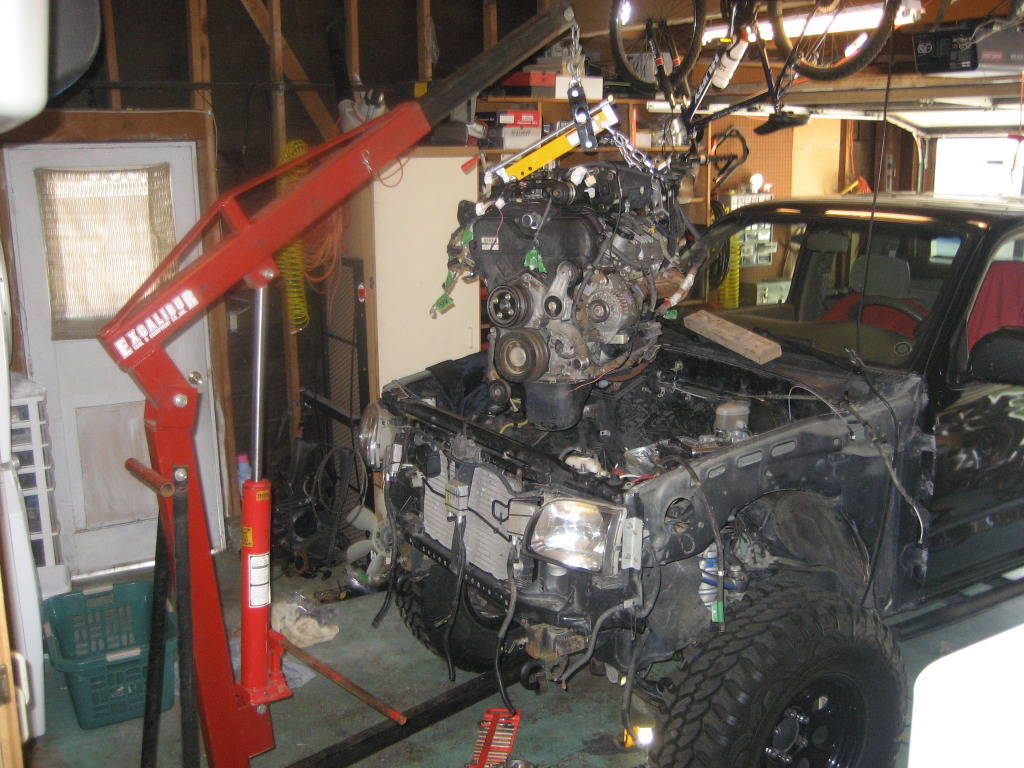

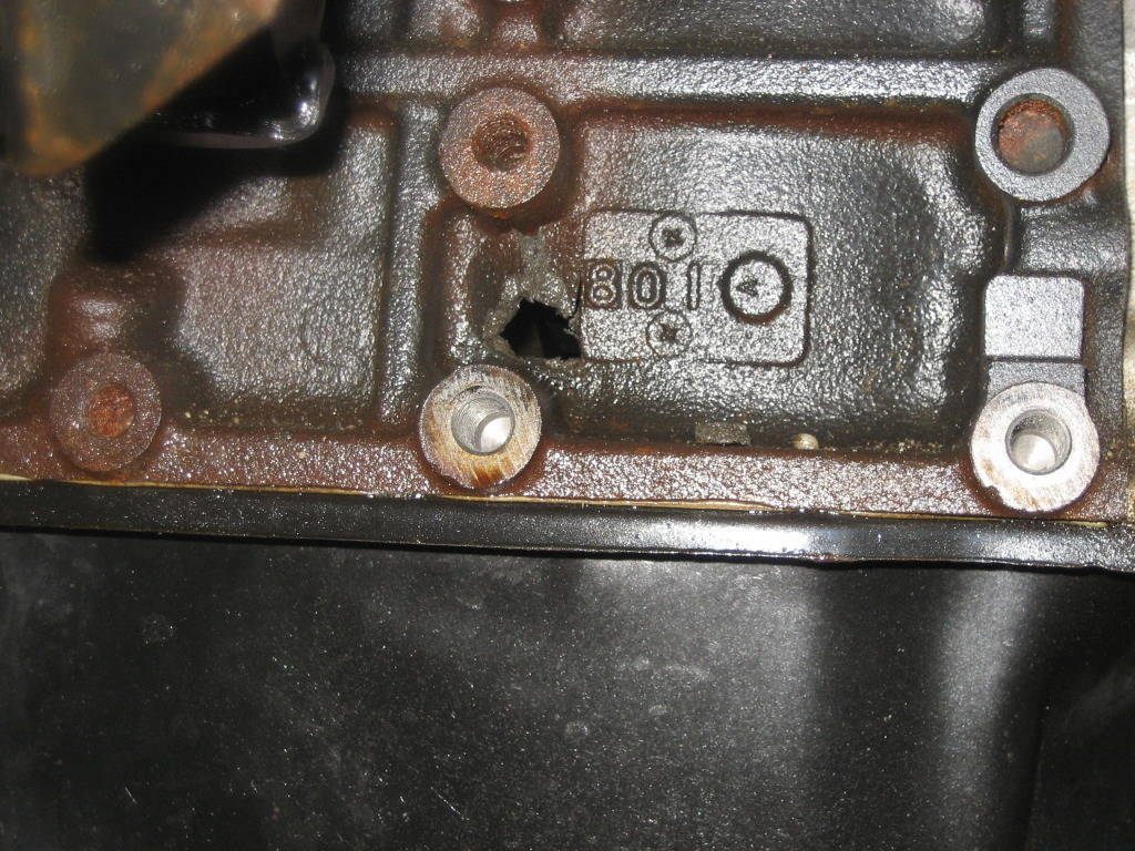

    MJ's future father in law hooked me up good this morning. He let me borrow the engine hoist, a engine stand, and a transmission jack adapter. Super cool family. I'm sure MJ is getting the better deal with that relationship. :D (j/k)
    Anyway, motor is out. The engine hoist is a beast, but even at the highest setting, the oil pan was still about an inch too low to clear the front crossbracing. I ended up dropping the air pressure in the front tires to 10 psi and was able to wiggle the motor out.
    Well there's your problem! Rod poked a hole clean through the side of the block. No chance in hell to rebuild that.
