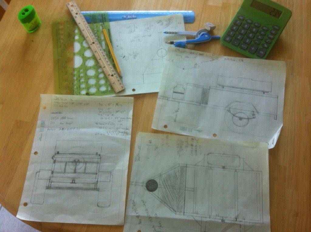

    Oh....and the other thing I've been working on since I'm basically couch-ridden.

    Off road trailer? Bad ass!

    Looks good Jason!

    Seriously tho...the amenities will be nice. 6x5.5 bolt pattern axle to share wheels/tires from the trucks (with electric brakes), fresh water tank and RV pump, little kitchenette setup with small sink, stove and grill feeding from a standard 20 lb propane tank. I'm still on the fence about what I'm going to do for suspension. Part of me just wants to do simple leaf setup with a max coupler hitch. I have no doubt it would handle what I want it to do and I found a thinner 5 leaf pack that's longer than most trailer leafs. But the other part of me (you know...the over the top part) wants to do independent 28" links with 8" remote resi King coilovers...you know, so I have spares in case I break one on the truck. :anonymous:

    Current plan is to do a 3500 lb axle, which in truth is way overkill. Loaded trailer will probably never be more than 2k, but from what I've found to get 6x5.5 hubs, minimum is 3500 lb axle. I've been toying with calculating material thicknesses and at least according to my calculations right now, trailer will be around 600-700 lbs dry.

    Yeah...my frame and crossmembers will be 2x3 .120 wall, rear bumper 2x5 .120, and 2.5x2.5 .250 wall tongue, so "flimsy" it will not be.
