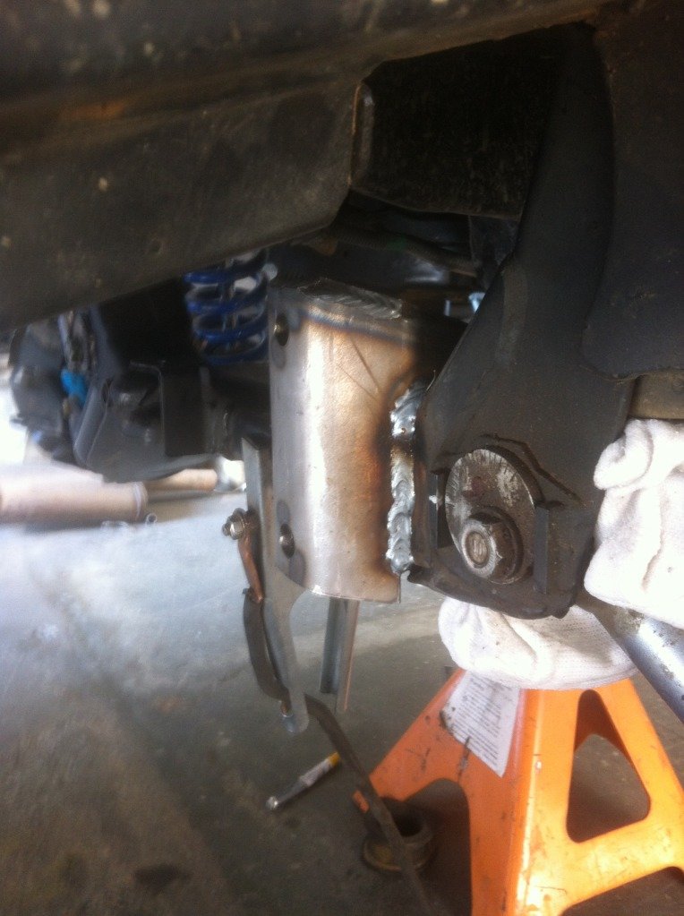

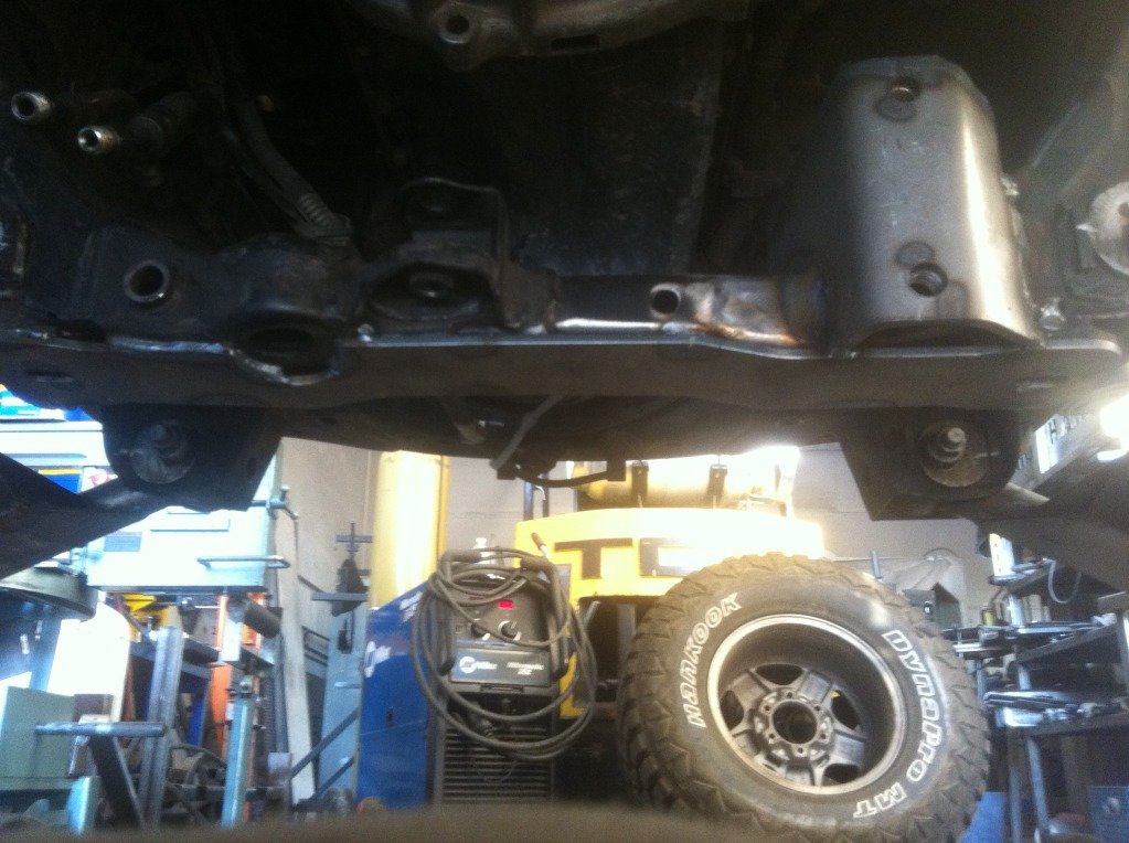

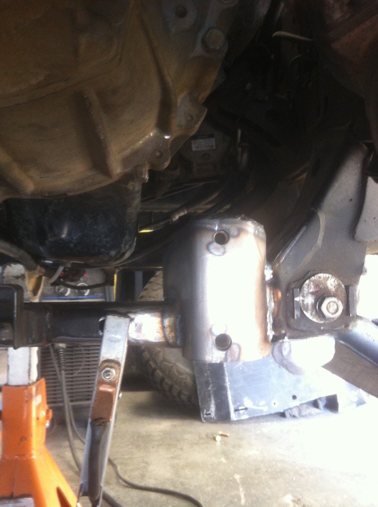

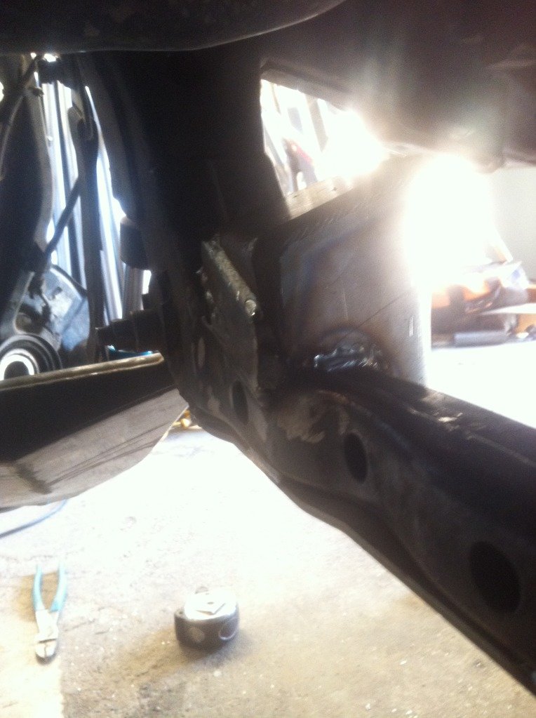

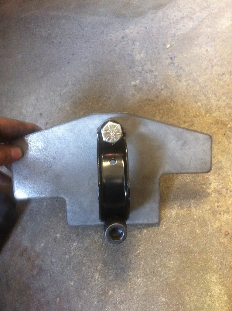

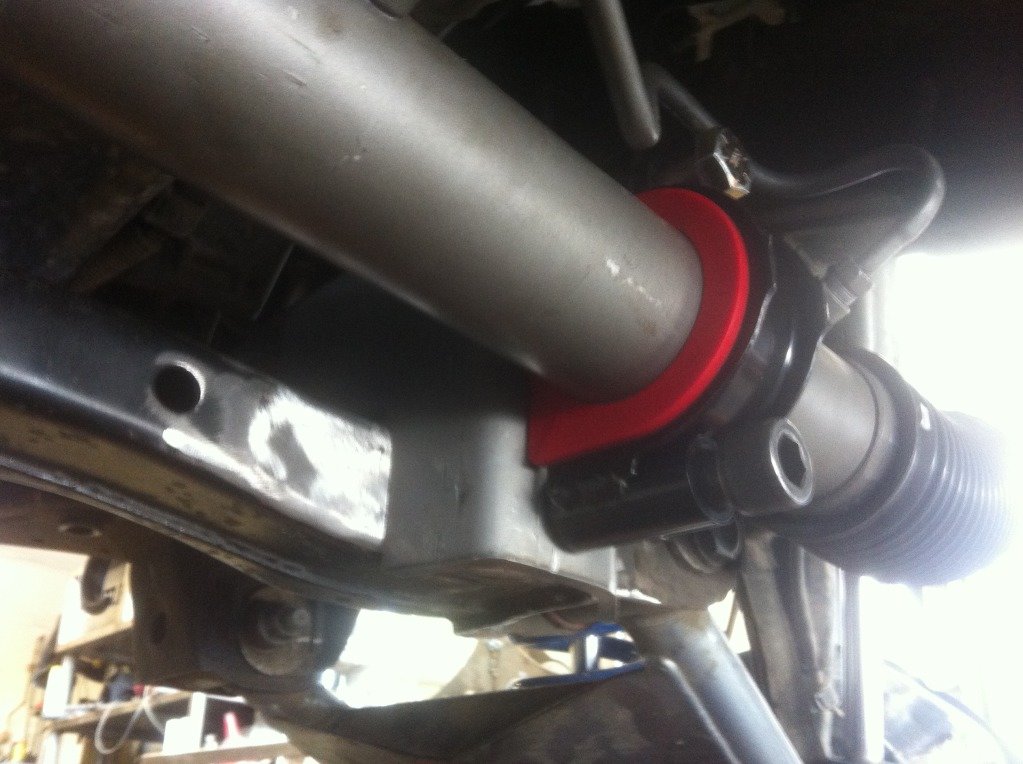

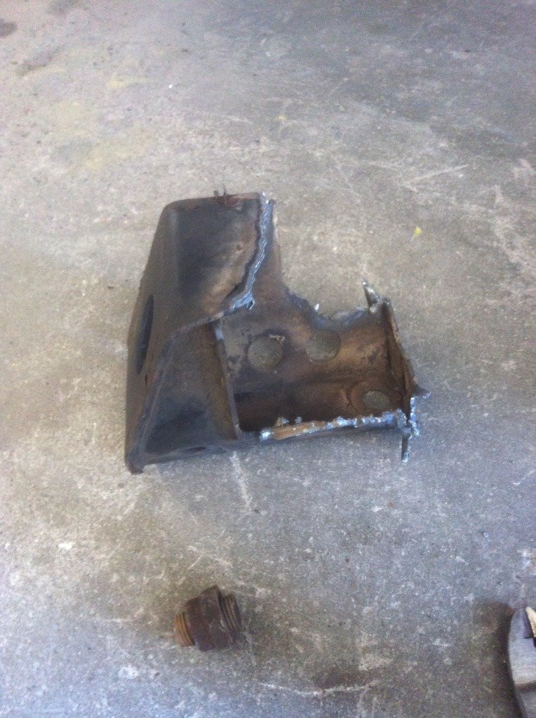

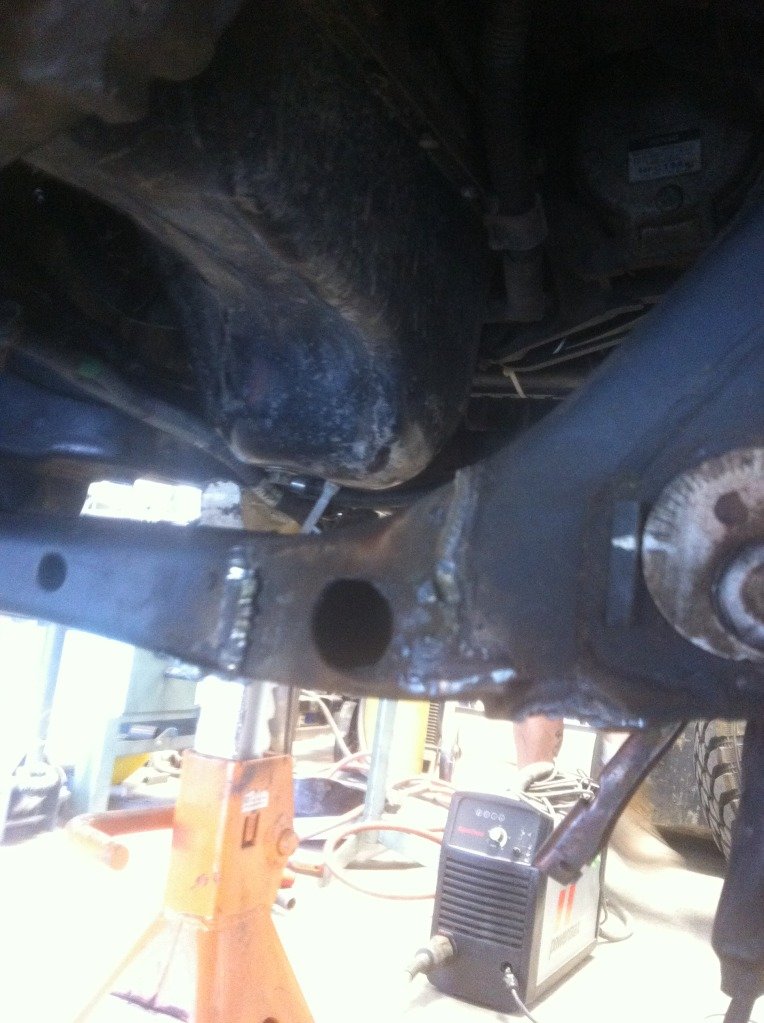

    Out with the old, in with the new. With huge help from Jerry at BAMF, got my steering mount fixed. New mount is 1/4" plate and fully boxed. Not bending this one.
    Also added this bit to the bottom of the crossmember for some extra beef and for the skid bolt into
