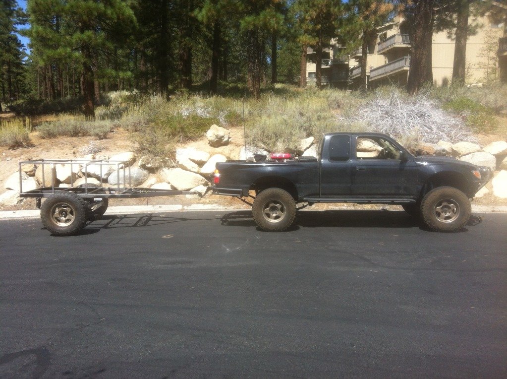

    Where is the trailer?

    So u r gonna need another 3 wheels and tires huh. 2 for truck and one for trailer :D

    Not exactly. I actually bought the very last two matte bronze f5's that Vin had. The spares I had in the truck will now be permanent on the trailer.
    I kept the other two pro-craps that had a bunch of inside camber wear from the....uhh..."banana axle." I got those mounted today to the new f5's and will be using those as truck spares now.
    My thoughts on a spare for the trailer....
    While I think it would look cool, overall generally pointless considering I carry two full sized spares in the taco. If I decide to tow the trailer with the Tundra or the wife's runner, still not a big deal. Both those trucks have full sized 33" spares too. If I'm really motivated, I'll build a little trailer hitch spare tire holder to put in the recovery point on the back of the trailer.

    Might be worth building a small hitch mount spare carrier for the trailer in the off chance you want some room in the truck.

    It certainly would be a shift in weight but you don't need to run it all the time. Just a handy thing to have.

    My trailer is like Jason's in that the axle is slightly biased toward the rear to add a little tongue weight. When I added my rear tire swingout to my trailer there was a dramatic change in balance. I needed to compensate for it a little. I already had 10 gallons of water carried near the front of the trailer, but I added another carrier for 5 gallons of extra fuel and a mount for my CO2. Adding those things helped to get proper balance back.
    IIRC Jason is planning on a water tank near the front of the trailer. My guess is that will more than compensate for a rear mounted spare if he decides he needs one on the trailer, but I agree I think his current plan sounds just fine.

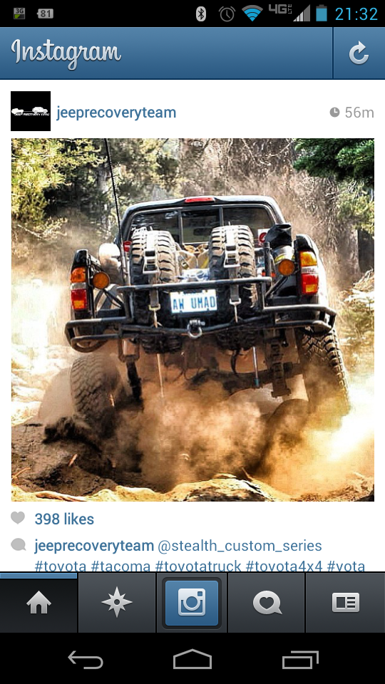

    Geezs the back of that thing looks sexy. :drool::drool:

    I get that a lot.
    Granted most the time it comes from the opposite gender, but I still take it as a compliment every time.
