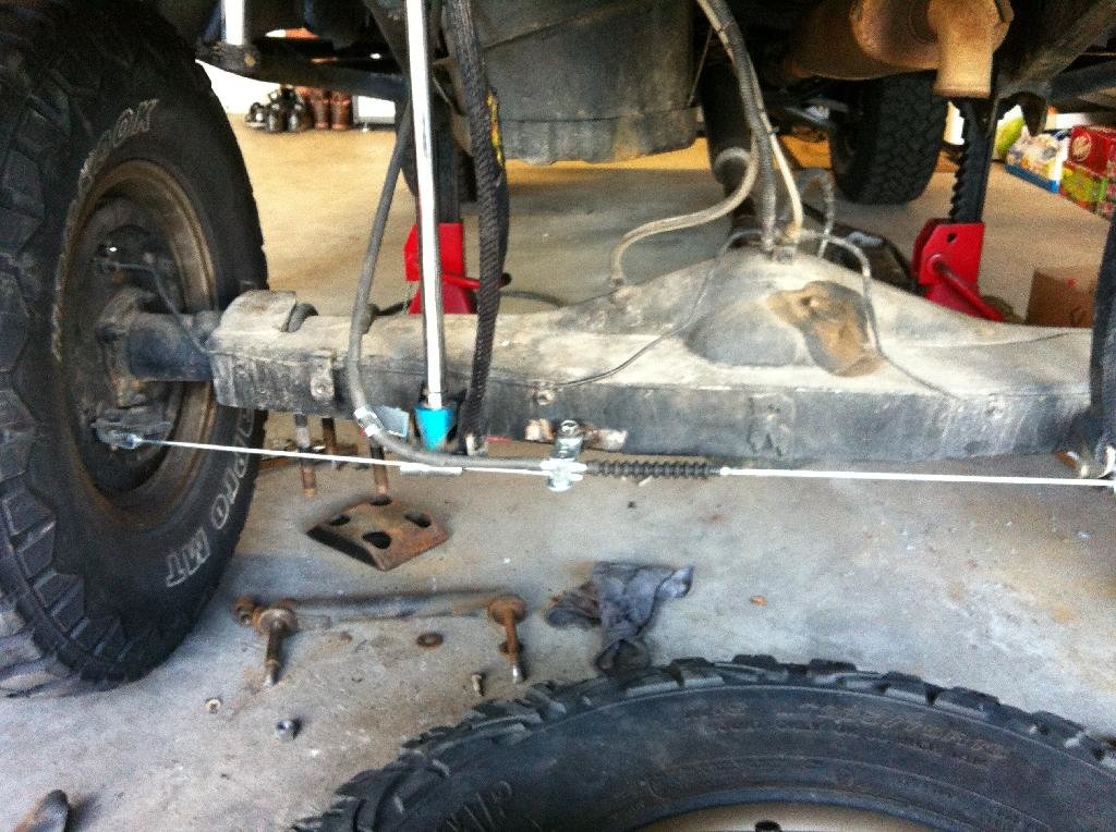

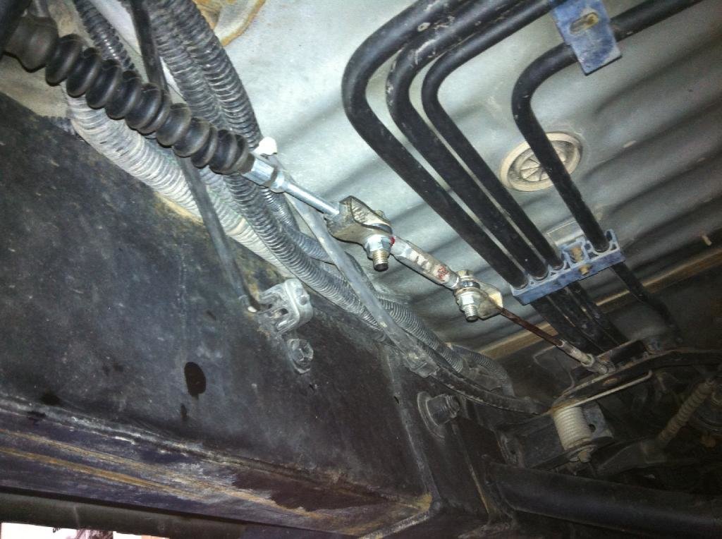

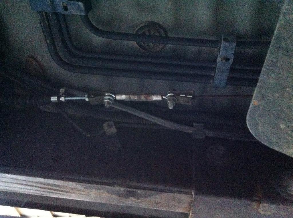

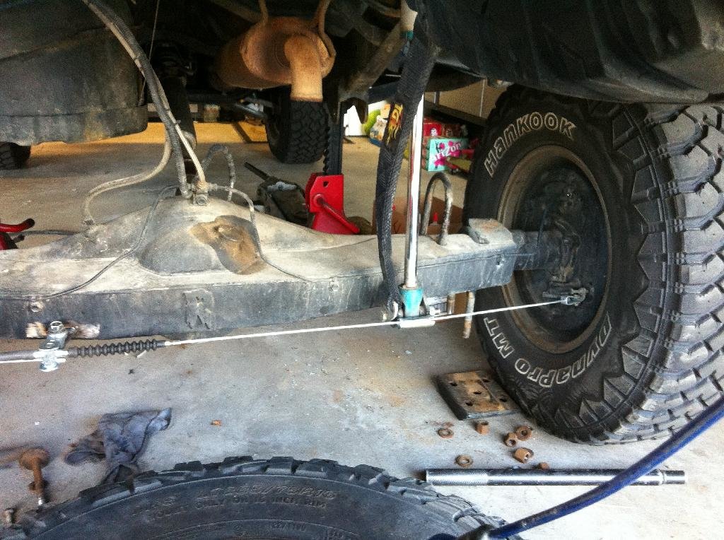

    Well since it's all taken apart...may as well.
    I finally have a fully functional e-brake after 2 years of not having one with the tundra axle swap. It's such a bastard setup. Somehow I was able to mate a tundra and a tacoma e-brake cables with some help from the hardware store, some old parts of the original cable, a bungee cord, and random shit in my garage to make a fully functional e-brake.

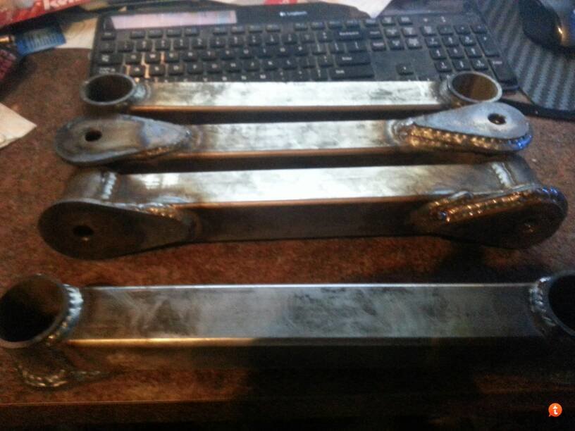

    Sooooooo my shackles are indeed fucked. I went back and forth trying to drill it out and maybe use a larger bolt and sleeve. Just not happening.
    So new shackles it is! Sneak peak of the jberry proof shackles from my fabricator.
    Yes...someone else is building them :anonymous:
    7DB605BF-AE86-4CA1-A149-E49CBAB64873_zps_1651501065b8160502ad5ba30a223b8f727a828b.jpg

    But those with a keen eye will see the gusseted bolt sleeves instead of just a hole drilled thru the plate.

    you sure are a handy fucker jason. i really want my e-brake back haha.

    The tundra cable was $35 from rock auto. The rest cost me $5 in misc shit from the hardware store.

    jason, what length are those shackles? any way we might be able to get 2 sets made and make it a little cheaper on us both?

    Remove the old and install the new. Use some of your own ingenuity to figure out the details.
    I can't do a writeup for random shit i have laying around in my garage that nobody else will have. Hell I used old bushing sleeves to keep the cable in place behind the shocks.
    12"

    I'm guessing prototype and if anyone can break it, Jason can!
