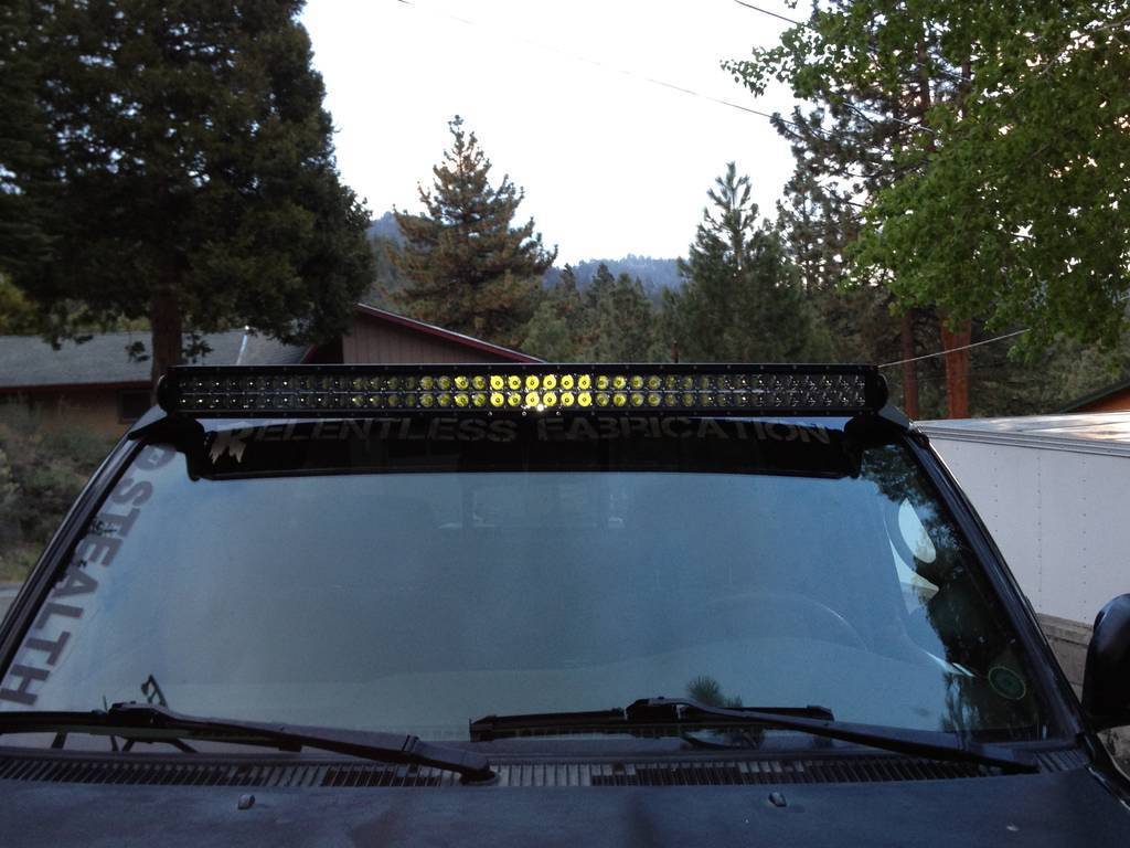

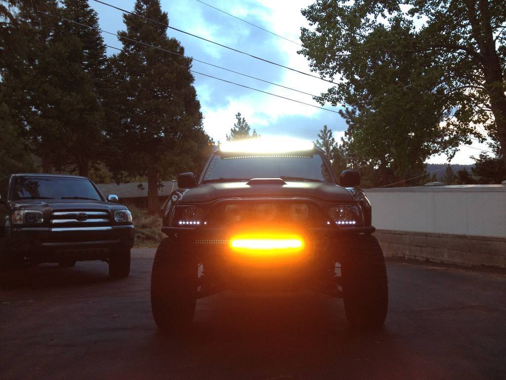

    Well with RelentlessTaco's new found line of Rampage LED lighting, it was just a matter of time before I caved in and started looking at roof light bars. I bit the bullet and picked up a 40" radius dual row bar during the group buy. I'm a hard person to impress...and I gotta say these things are just fucking rediculous.

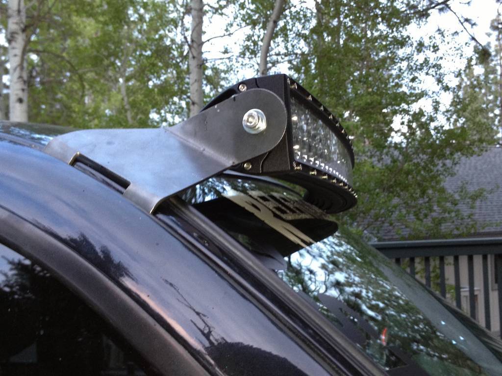

    Eric already had a mount designed for the first gens and the radius bar, but it was a little too tall for my liking. I was looking for something more low profile and inline with the windshield/roof lines. A few mock up measurements and Eric did his thing. Mounts are cut out of 12 gauge. Each mount has two holes that were mounted to the cab. We drilled 2 holes on each side of the cab. Conviently where we drilled in the cab is actually two separate layers of sheetmetal. Combine that with rivnuts, the mount is not going anywhere!!
    Blah blah blah...too long, didn't read. Here's the pictures.

    How's the wind noise Mr. Jason? I would totally run that.

    Nearly zero whistling.
    Eric's other mount that sits higher on the roof line has holes/dimple dies in it has different sounds depending on the angle of the light and how fast you are going. With this new low profile mount, the ONLY time I got any sound out of it at all was at 35 mph with a hefty cross wind. As soon as the cross wind stopped, no more whistle.
