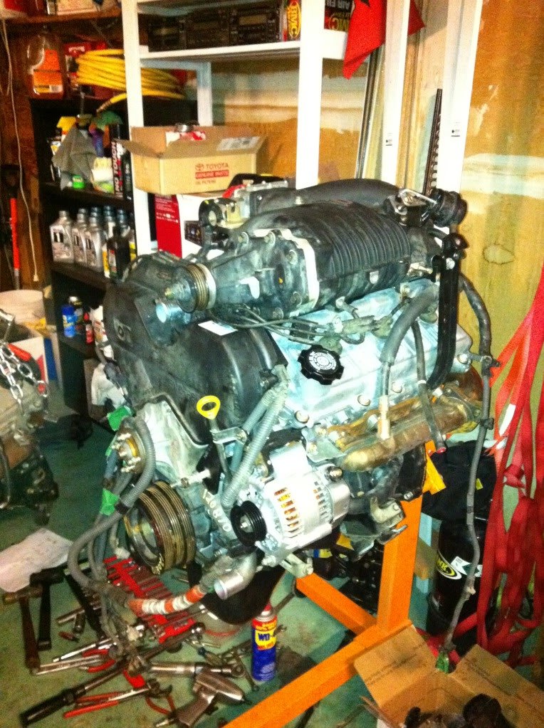

    Alvin came over for a little bit after work to help out. We ended up mostly bullshitting and drinking beer, which was absolutely fine by me.
    Got the old motor off the stand. Put the new motor on the stand and started putting it together. I swapped wiring harnesses, motor mounts, and my timing belt cover (its already notched for the supercharger, and installed a new 130 amp alternator, new oil filter, and of course, the supercharger. It's ready to install back in the truck now. :cool:
