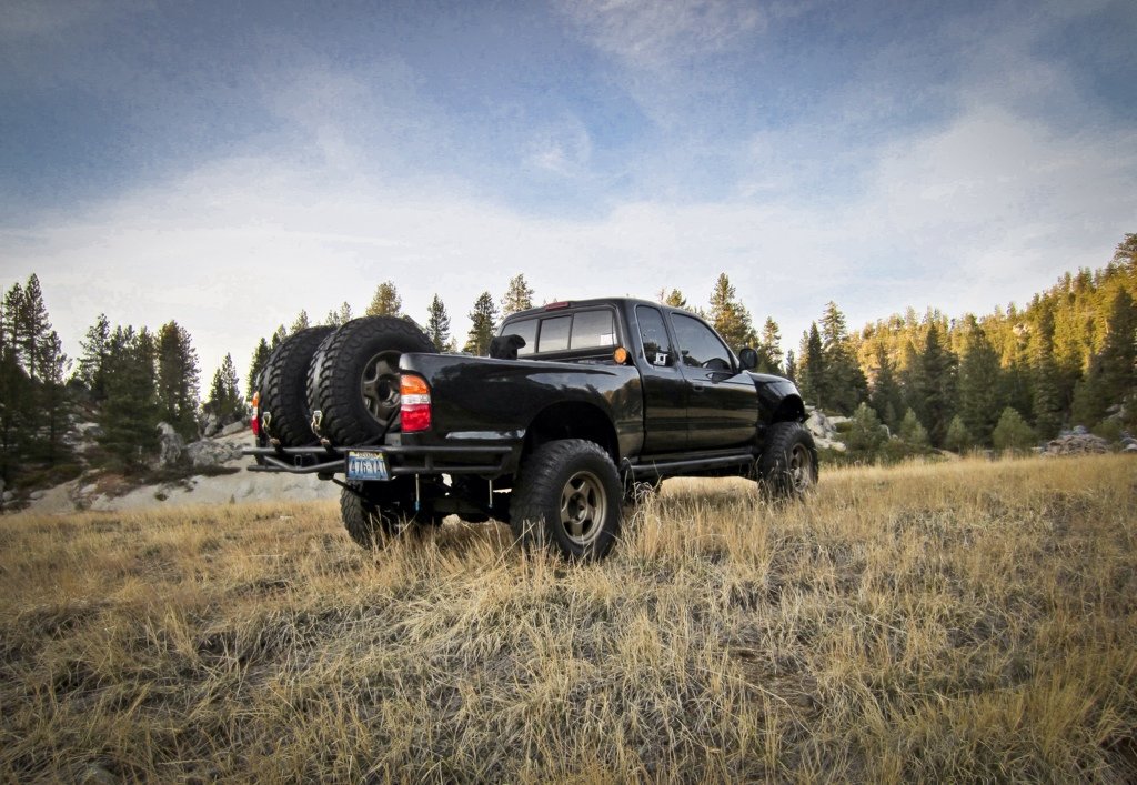

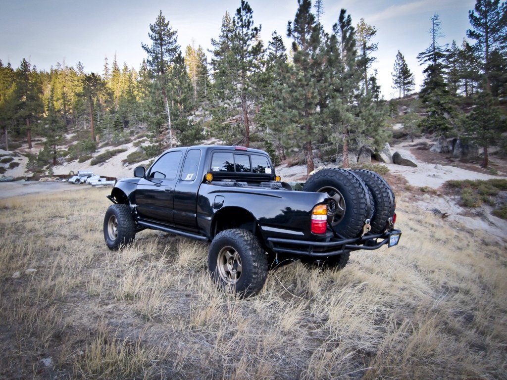

    Hey Jason I didn't know you added a double tire carrier to your bed cage. It looks good man! :thumbsup:

    Thank you sir.
    Did it a couple years back when I bent the rear axle to shit. After exploding one wheel into 4 pieces 15 miles from the nearest pave road and running on my only spare...that sealed it for me. Figured better to be safe than sorry. And it helps balance the front/rear weight bias a lot better.

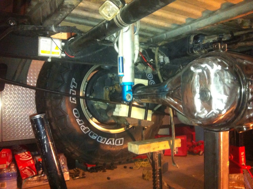

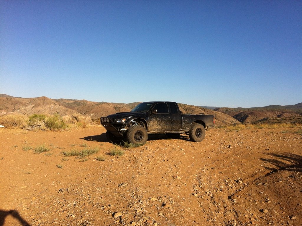

    This is the best "like for like" I have.
    First picture is brand new set of F67's on maiden off-road voyage (with single spare).
    Second/third picture is brand new 50T on maiden off-road voyage (with two spares). No other difference in spring/shackle/pivot placement. Just a different spring.
    The uptravel difference is significant...even when judging from a photo.

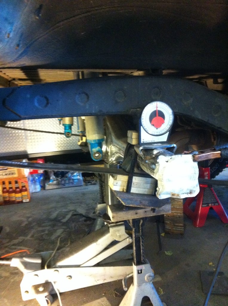

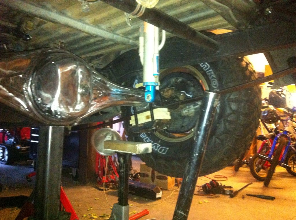

    Probably best to start fresh. You can re-arch the F67's to get more up out of them, but the arch won't last long (6 months tops), especially if you are beating on it. Obviously depends on a number of factors including at what point you set the pack to bump at (negative arch, vs neutral, vs positive arch). I bumped mine so the main leaf was damn near dead nuts flat at full bump...if anything barely negative (see below).
    The E30/H70 has a slightly thicker leaf on the upper leafs with some significant arch to handle weight.
